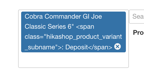

I am using RO CSVI to create export reports etc.
When carrying out an export the variants are showing html. The following question has been asked:
I would appreciate feedback please?
David

5 years 11 months ago #321960
The product_name column can contain HTML. HikaShop doesn't forbid it. It's used sometimes to add a <br/> tag to the product name so that it displays on two lines and is cut where the merchant wants.
Now HikaShop doesn't do anything specific with the HTML tags added in the product_name. They are stored "as is".
I suppose that the issue is that the name's double quote was escaped by the patch for both the value of the option and the text of the option but it should only be escaped for the value (so that it doesn't break the HTML tag of the option) but that's not necessary for the text, and if you do it for the text, then the escape character will appear in the select.

  • Posts: 447
  • Thank you received: 20
5 years 10 months ago #322414
Hi Nicolas
The issue seems to be that a " is part of the product code so for instance
Moloch Action Figure 6" Black Series_6 is actually being read as Moloch Action Figure 6 which means that the variants are not being exported.
  • Posts: 85733
  • Thank you received: 14061
5 years 10 months ago #322416
We don't forbid the use of double quotes in product codes.
But it would indeed be better to avoid using it in namekeys/codes etc. Places which can be used as the value of an option of a dropdown.
Now it seems that this dropdown is in RO CSVi if I understand correctly ?
In that case, the value should be escaped when added to the value of the option of the dropdown and that would avoid the dropdown breaking.
Here is a page about this issue:
stackoverflow.com/questions/4015345/how-...side-html-attributes
