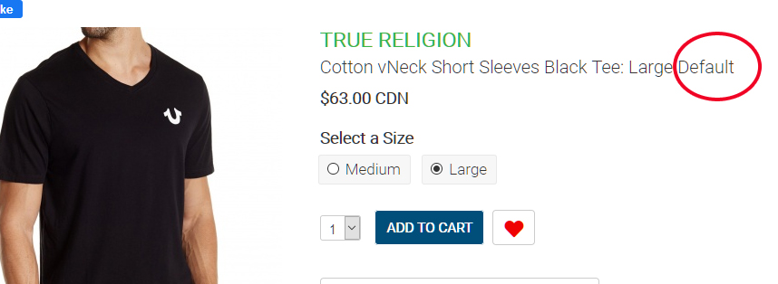

How do I remove the Characteristics from the product name, as per the attached. It should not be there.
Thanks!

5 years 10 months ago #323717
Hi Philip,
In order to do what you suggested, I would have to go through ALL the products and rename the variants - that is too much :(
Is it possible that I can add a class around the characteristic so that I can hide it? That would make things much easier/faster.
If not, I will just hope that in the near future the "Characteristics dynamic display" will not work ONLY when you have more than 1 characteristics.
www.hikashop.com/support/forum/product-c...g-issues.html#322784
Thanks!
5 years 10 months ago #323736
Yes, you can use a custom css code to remove the "extra" variant name, with this kind of code :
span.hikashop_product_variant_subname {
    display: none;
If you use this, as a result on any page the variant subname won't be display anymore.
If you want only remove it on a specific context, you can process like this :
div.specific_html_page_class span.hikashop_product_variant_subname {
    display: none;
Hope this will fit your needs.
