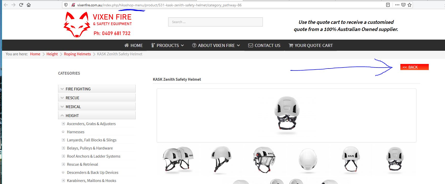

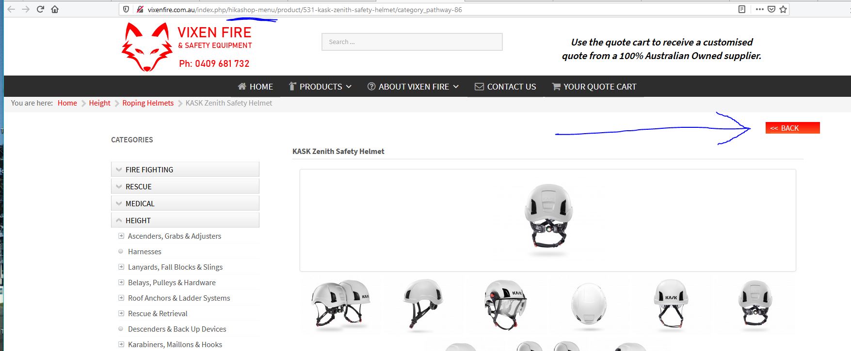

Hi, as HS does not have a BACK button feature, I made one using the simple code:
<a onclick="history.back();return false;" href="#">BACK</a>

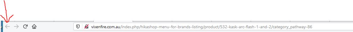

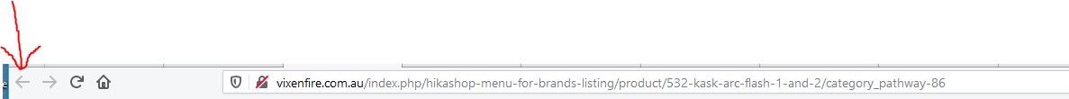

It works great except after a search, and selecting one of the results, there is no Back functionality, not even the browser back button.
If I take the exact url and paste it in to the address bar, the Back function works ok.
Result from a search:

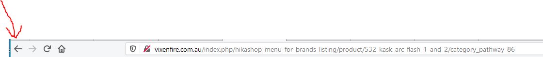

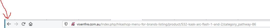

Cut/Paste that exact url and the Back function works:
How do I enable a Back, or Back To Search Results on these pages?
Many thanks
Paul

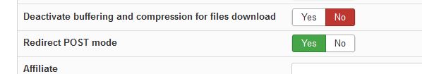

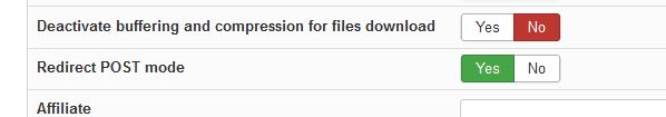

Try turning on the "redirect POST mode" setting of the HikaShop configuration and it should help.
  • Posts: 42
5 years 10 months ago #322782
I did that but unfortunately there is still no BACK functionality after clicking a Search result.

5 years 10 months ago #322800
I checked on your website and it seems that you're talking about the Joomla search module at the top and not about the Hikashop filter system.
And from what I can see, it's normal that there is no back when you click on a result of that search module as it opens the result on a new tab.
This is actually controlled by the setting "New page" of the HikaShop products search plugin. So you want to edit that plugin via the Joomla plugins manager and turn off that option. In that case, the result page will open on the same tab and you will have the possibility to use the back button.
  • Posts: 42
5 years 10 months ago #322816
Oh wow, I can't believe I didn't notice that it was creating a new tab :-(
That change has fixed it, thank you so much.
