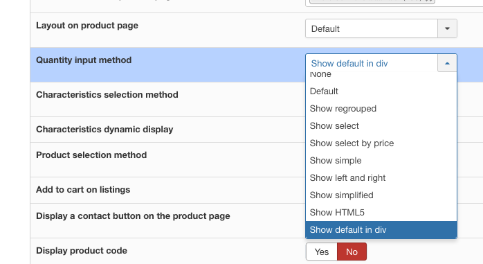

After updating from 4.3 to 4.4 the default "1" has disappeared from the hikashop_product_quantity_field_
Where should I fix this?

I would recommend checking the different values of the "Quantity input method" setting in the HikaShop configuration.
You're apparently using the old input method with a HTML table for the layout. I would recommend switching to something else and that might also help with that issue in the process on top of looking better.

The setting is default,
I have tried all the other options, even "none"
None of these make a difference
you mean these, don't you?
5 years 10 months ago #324846
From what we can see in your setting, and more especially that changing the setting didn't impact the display seems to indicate 2 possibilities :
1. You have an Override view ( Documentation ), try to save it on your side and remove it to process a test
2. Your template make some modification on the Html, try to process a test with a default template like ProtoStar.
Awaiting your returns to be able to progress on your subject.

5 years 10 months ago #325020
THANKS Phillip!
All issues solved
