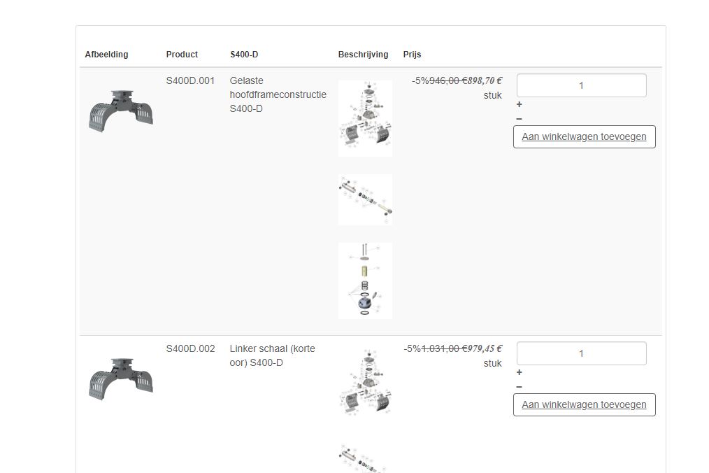

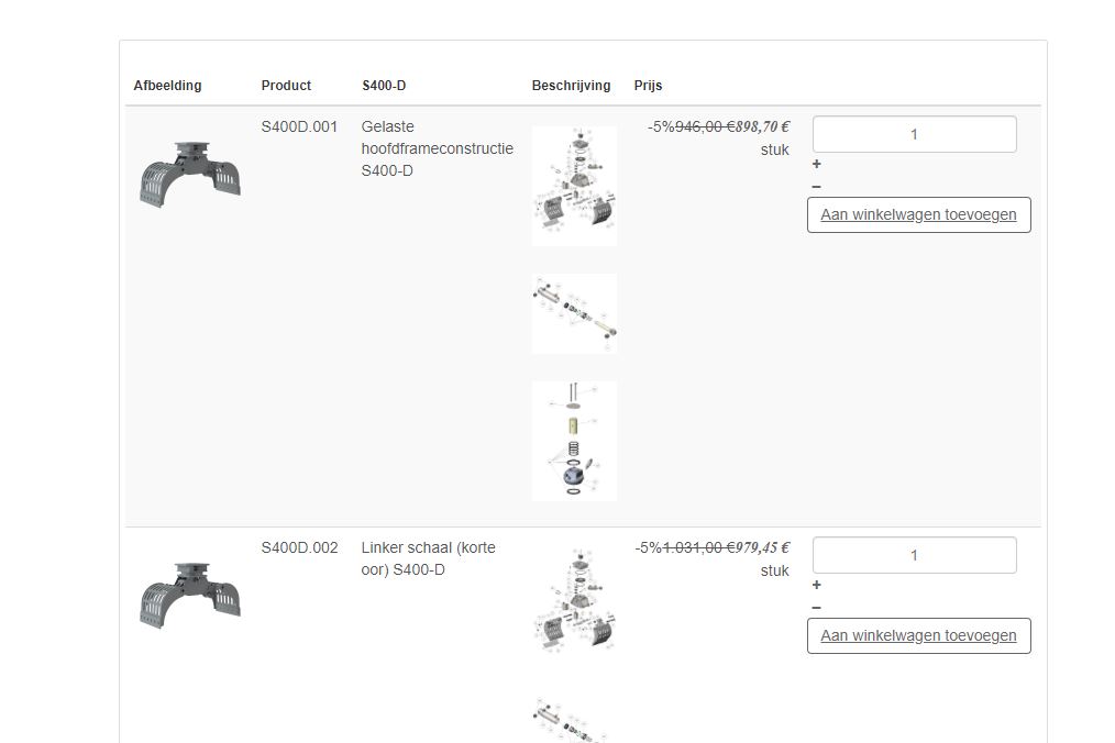

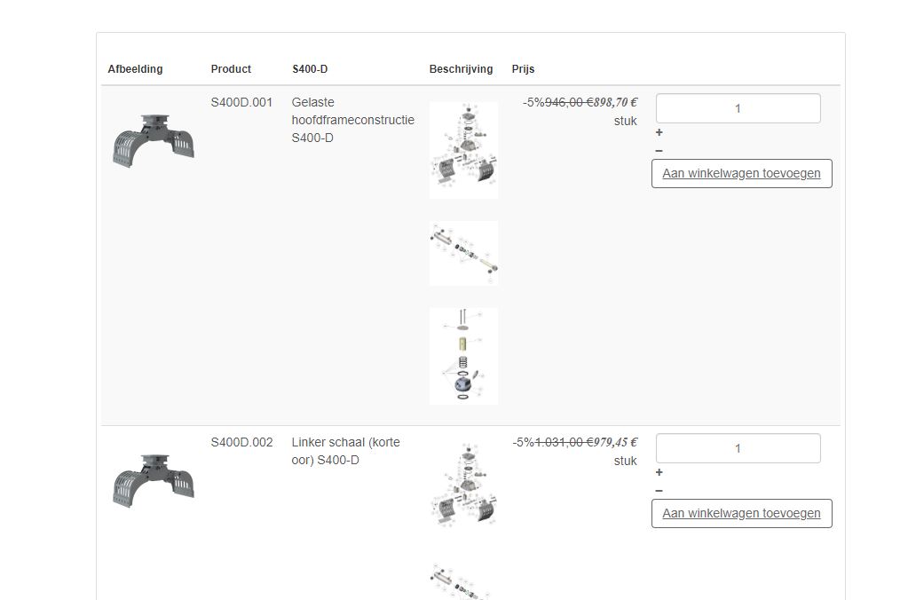

I've a problem with export and import products.
When i export products and use the exact same file as import, the product characteristics are messed up.
These are suddenly shown with an image (which is not linked to it) and a description) that is not there.
These are then taken over from the product itself. This does not happen with all products and characteristics
Kind regards,
Matthijs

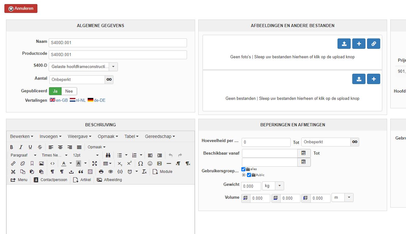

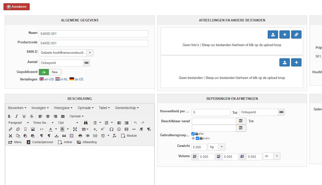

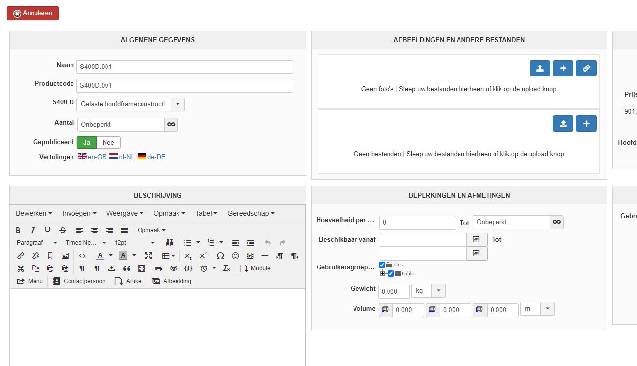

5 years 9 months ago #325727
Do you see the images linked to the variants in the backend too when you edit a variant under the variants tab of the product edition screen ?
And we would also need a copy of the CSV as well as a link to the page where you made that screenshot to check on the situation.
  • Posts: 30
5 years 9 months ago #325749
HI,
No, these are not visible in the back-end.
In the appendix the export.
I can give the link to the site, but it is not "open" to the public yet because we have to solve this first.

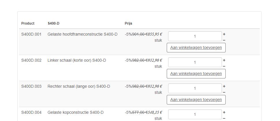

  • Posts: 30

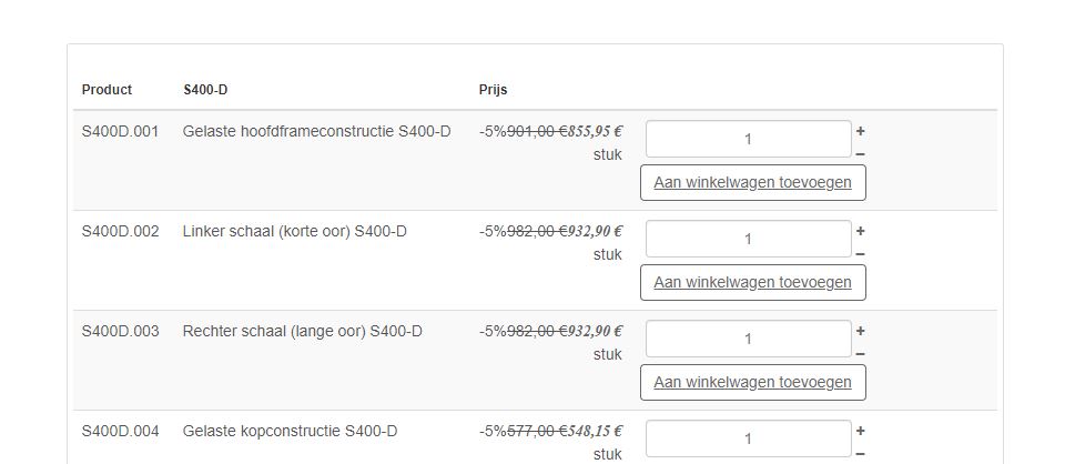

5 years 9 months ago #325781
Hi ,
It happens after the import, before the import the data was right/
I have emailed login details via the contact form.
You can try it yourself by exporting the product S1402-D and then importing it again.
I've made a backup, so you can try whatever you want :)
Kind regards,
Matthijs
  • Posts: 86045
  • Thank you received: 14176
5 years 9 months ago #325798
I've run some tests on your website and as I expected the issue is with the mechanism on the product details page to check if the variants have different images.
After the import, you end up in an edge case of that algorithm for one of the variant.
So I made a patch to it so that it properly handle that edge case.
I've added the patch on your website and on our end.
So I can confirm it now displays fine on your website after the import, and we'll have that patch on our end for the next version of HikaShop too.

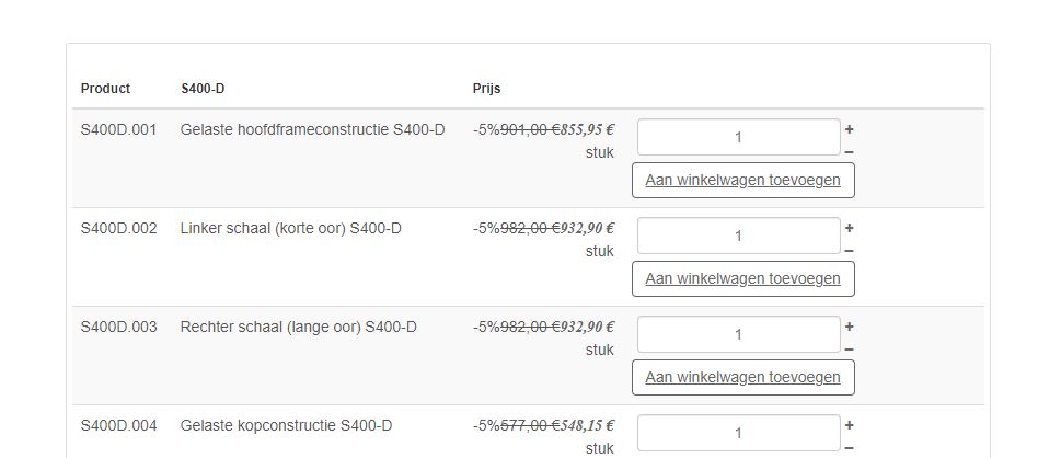

  • Posts: 30
5 years 8 months ago #326018
HI,
That works!!! Thank you very much!!!
  • Posts: 30
5 years 8 months ago #327196
HI,
The problem is back. Can you provide the patch, so I can install it?
Greetz
