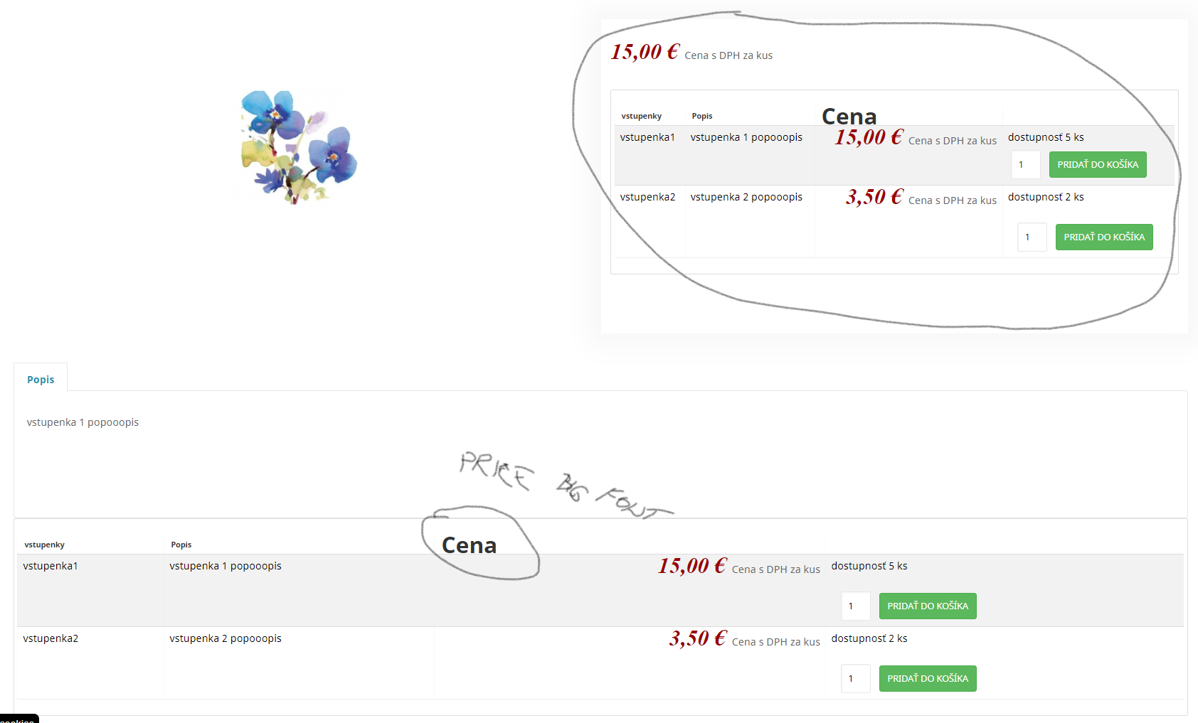

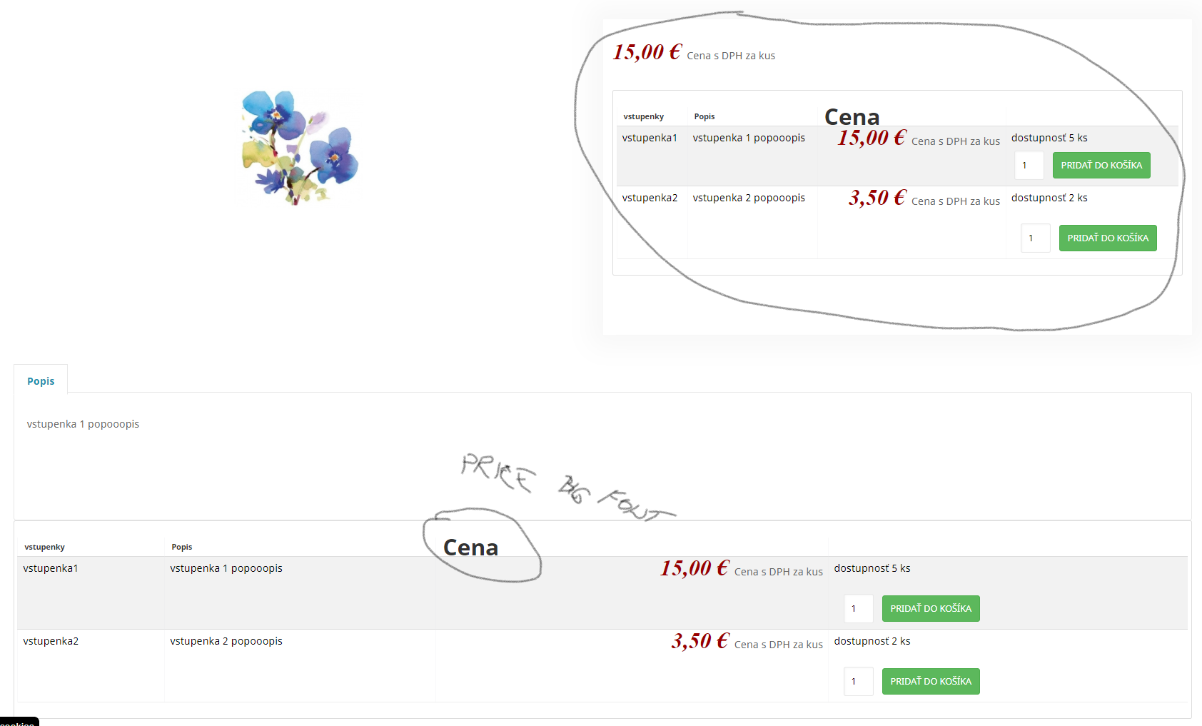

  • Posts: 24
5 years 9 months ago #325980
Thank you,:)
here is my code at the beginning of that view file:
<?php
* @package HikaShop for Joomla!
* @version 4.4.0
* @author hikashop.com
* @copyright (C) 2010-2020 HIKARI SOFTWARE. All rights reserved.
* @license GNU/GPLv3 www.gnu.org/licenses/gpl-3.0.html
<?php
if(empty($this->element->characteristics))
return;
<?php
$mainCategory = reset($this->categories);
if($mainCategory->category_id == 48)
$this->params->set('characteristic_display', 'list');
<div id="hikashop_product_characteristics" class="hikashop_product_characteristics">
<?php
if($this->params->get('characteristic_display') != 'list') {
$config = hikashop_config();
$characteristics_dynamic_display = $config->get('characteristics_dynamic_display', 1);
$this->characteristics=&$this->element->main->characteristics;
it works, but list view is viewed as on attached picture. The characteristics block is viewed two times and text "cena" (english price) have big font. :huh:
Last edit: 5 years 9 months ago by jokysax.

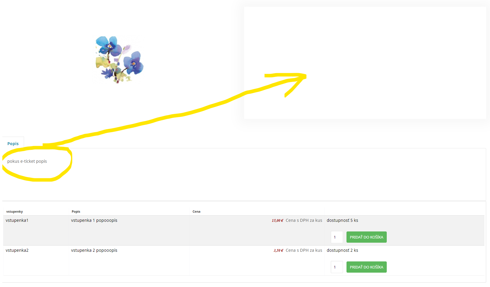

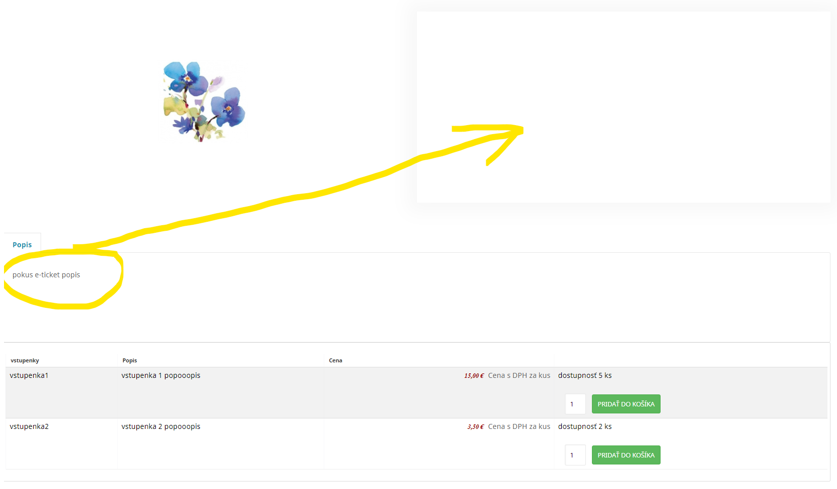

  • Posts: 24
5 years 9 months ago #326059
thank you, it works now:)
Its possible to move product description to position as on attached picture ?
Thank you.
  • Posts: 86095
  • Thank you received: 14199
5 years 9 months ago #326080
It should already be there but hidden with some CSS.
So just change / override that CSS to have it appear and add more CSS to hide the other one.
