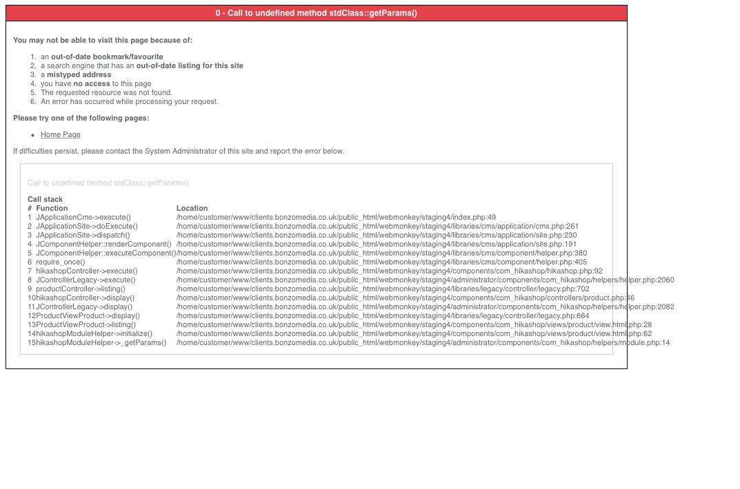

5 years 8 months ago #326121
Just downloaded Hikashop 4.4.0 against a Joomla 3.6.5 PHP 7.3.24
site and getting the same error when accessing the Hikashop products listing or category listing.
Last edit: 5 years 8 months ago by bonzomedia. Reason: Added error output screenshot showing call stack

5 years 8 months ago #326137
That's strange.
Try changing the line:
if(HIKASHOP_J30)
to:
if(HIKASHOP_J30 && method_exists($menu, 'getParams'))
in the file administrator/components/com_hikashop/helpers/module.php
That should hopefully fix the problem.
  • Posts: 131
  • Thank you received: 7
5 years 8 months ago #326147
Thanks Nicolas,
That fixed the issue in : administrator/components/com_hikashop/helpers/module.php
I also had to add that to:-
components/com_hikashop/views/product/view.html.php
  • Posts: 131
5 years 8 months ago #326148
...in components/com_hikashop/views/product/view.html.php there are multiple places where this mod need to be applied.
I can now view product list and product detail without the error...
What could be causing this issue?
  • Posts: 86052
  • Thank you received: 14180
5 years 8 months ago #326150
I suppose it must be linked to your version of Joomla. Joomla changed several times the way we can access the parameters of a menu item in the past 10 years and so we adapted the code.
I'm actually not even sure that Joomla 3.6 is fully compatible with PHP 7.3.
Updating to the latest version of Joomla 3 will probably fix the issues with getParams without doing any code change.
