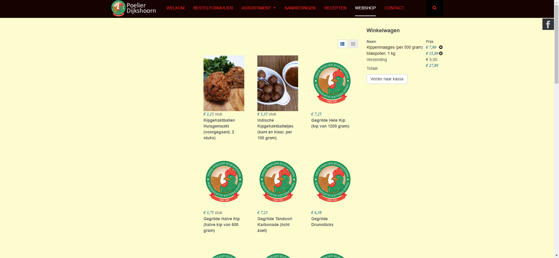

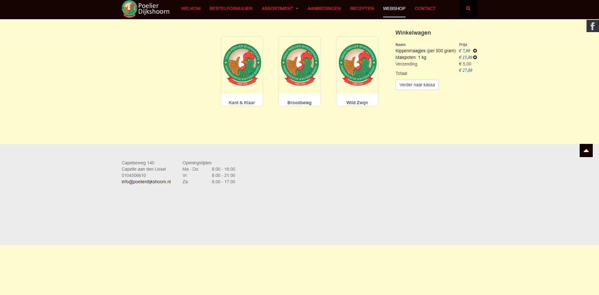

  • Posts: 40
5 years 8 months ago #326443
I thought it would be a cache issue since it worked in edge and it worked on my home pc using chrome, but now I replicated the error.
I placed a test order on my own website and after ordering it was broken again. I added screenshots
  • Posts: 86051
  • Thank you received: 14180
5 years 8 months ago #326462
I don't see anything broken there.
When you click on a category, the categories listing area will display the sub categories of the category you selected.
And since you don't have any sub categories, it doesn't display anything in the categories listing.
There is no mechanism to keep displaying the main categories when you go in subcategories of a categories listing.
You could try to go around that by create a categories listing module of your main category's sub categories and configure it to display on the products listing.

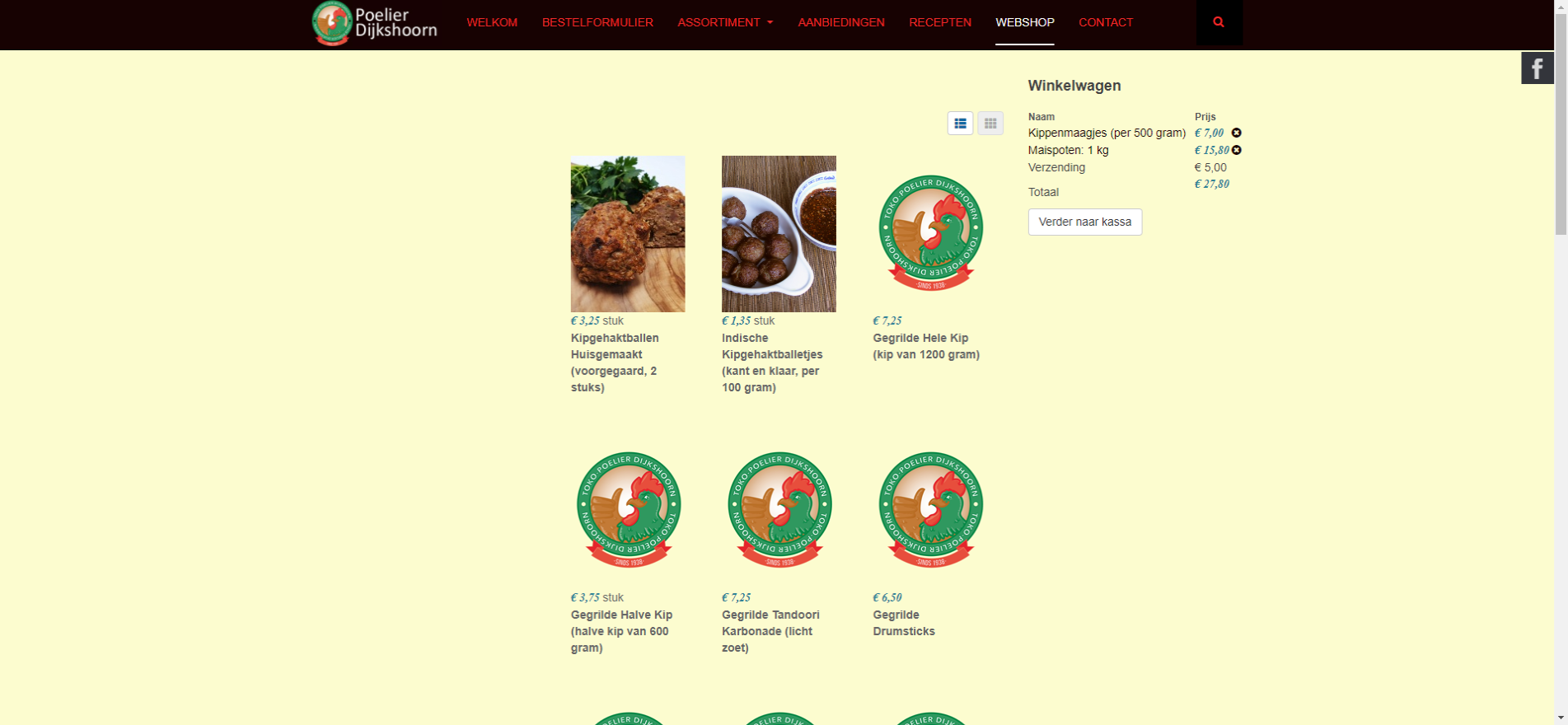

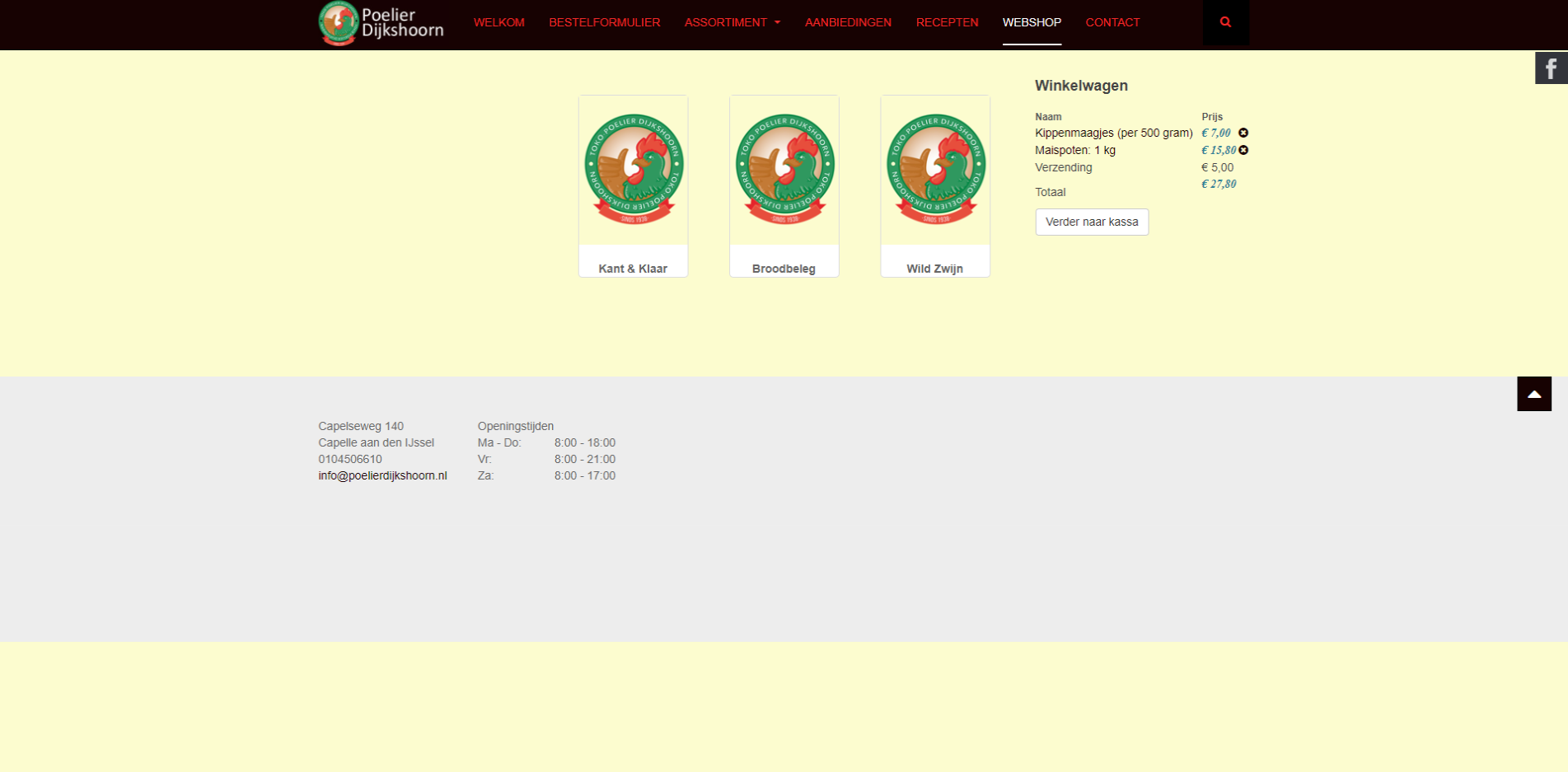

  • Posts: 40
5 years 8 months ago #326486
Thank you for having a look. I'm now able to replicate the issue in Edge. I'll click "Kip & Ander Vlees", then "Kant & Klaar". The category module on the left disappears and doesn't come back anymore. Also, when i go back to the "Kip & Ander Vlees" subcategory overview I only have 3 categories left when there should be almost 25.
