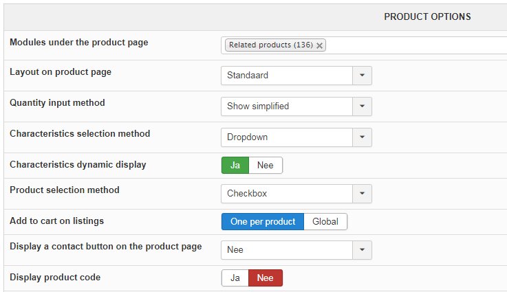

That being said: I can not change characteristics value to dropdown.
The only thing that changes is when I choose list display. Any other characteristics display stays on radio button.
That way the product image is always set to the default value image which is a solid color in this case.
Maybe it´s because of my template but I can not find where the problem is.
I already installed Hikashop again and checked the database a couple of times but that didn´t help.

The latest stable version is indeed the 4.3.0. The latest version is the 4.4.0. We didn't made the 4.4.0 stable yet as we're waiting to have enough feedback from people who manually update before doing so.
When you select dropdown" or "radio" in that setting of the configuration, you have a similar setting in the options page of each characteristic so that you can change the selection mode for each characteristic.
In list mode, the display is totally different and it doesn't allow to have characteristics with a different selection mode.
So I suppose that you must have select "radio" in that setting in each characteristic, which supercedes the setting of the configuration when not in list mode.

Thank you Nicolas,
I totally overlooked the dropdown setting in the characteristic setting.
I only changed it in configuration.
Sorry for the inconvenience. All is good now, thank you.
