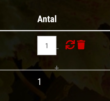

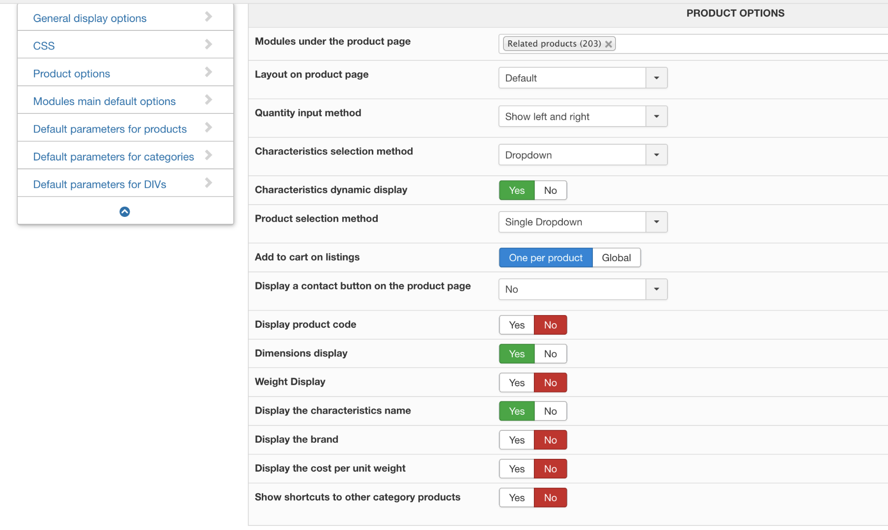

In the settings I have set the Quantity input method to Show left and right, but this layout is not on the Cart Display page.
Is there somewhere special I need to change taht?

5 years 8 months ago #327104
No, that file doesn't excist.
So you see attached?

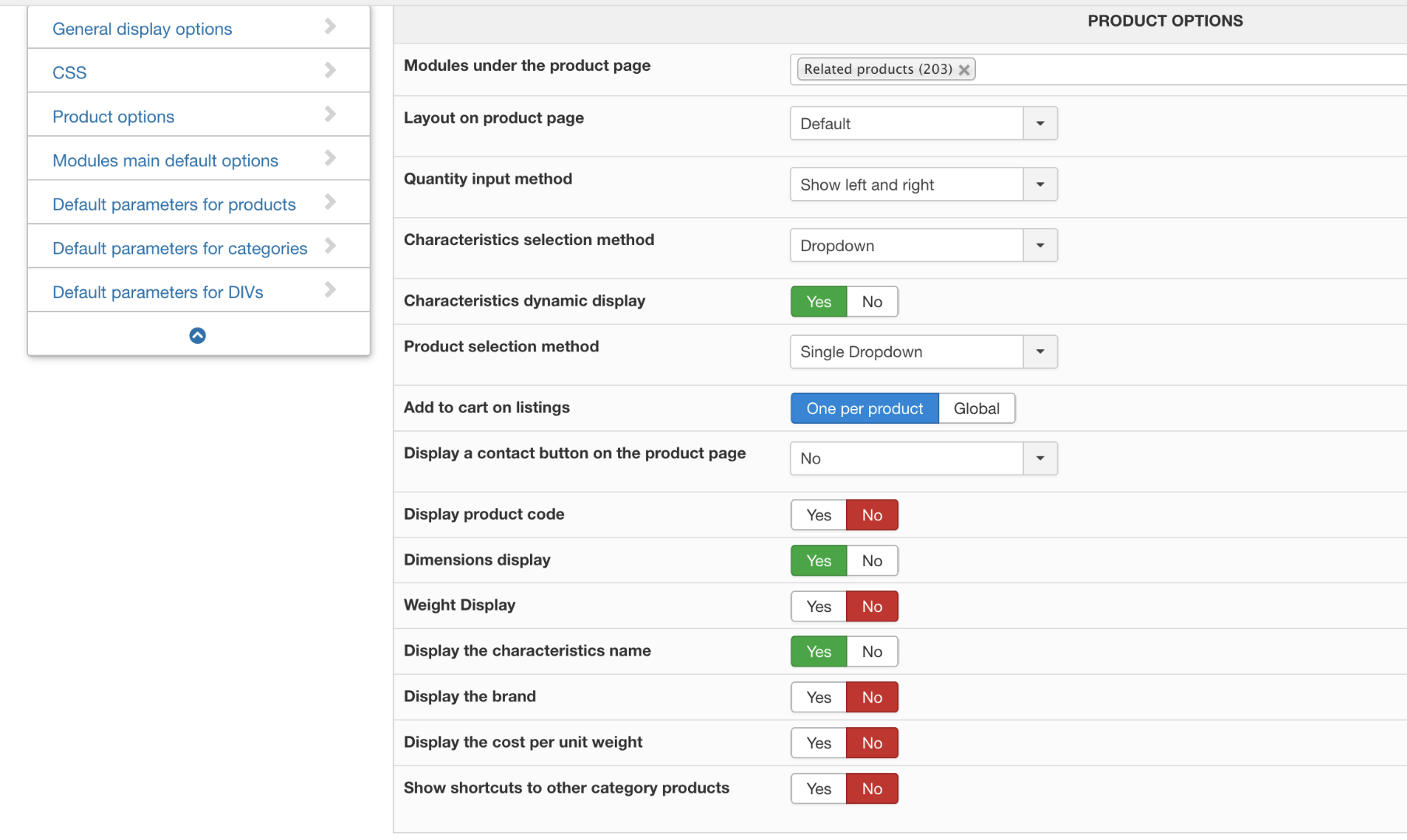

Could you maybe do some screenshots on how your product is configured and how you configured the settings under the "Display" tab of the HikaShop configuration ?

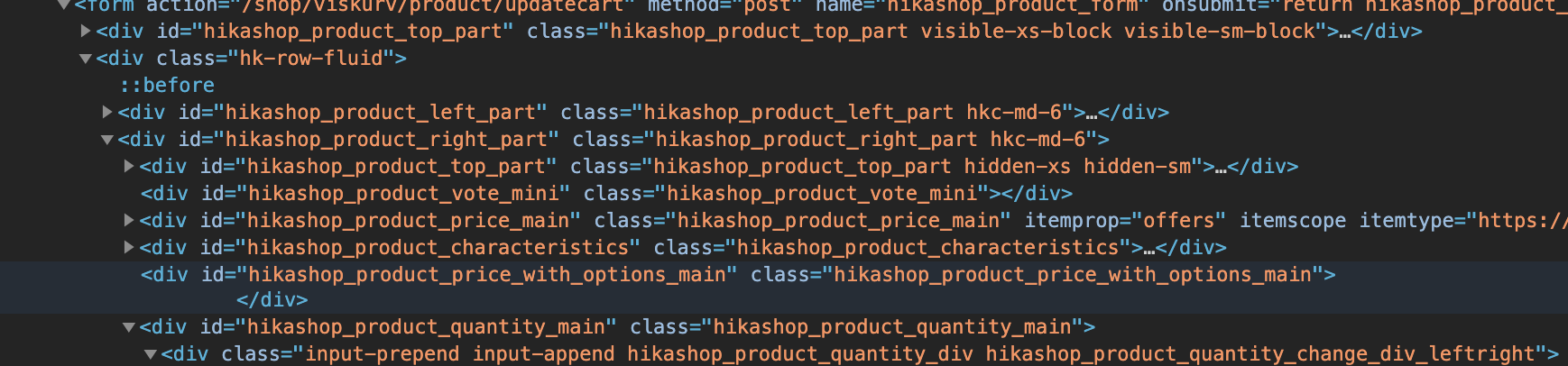

5 years 8 months ago #327168

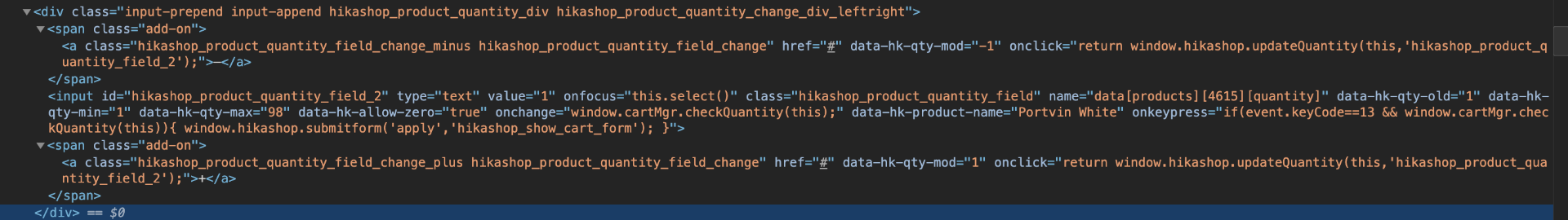

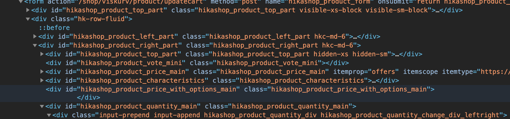

When I check the source code on temp.tasteofport.dk/shop/viskurv I don't see the same code, as on temp.tasteofport.dk/shop/viskurv/portvinsplakat
Thanks!

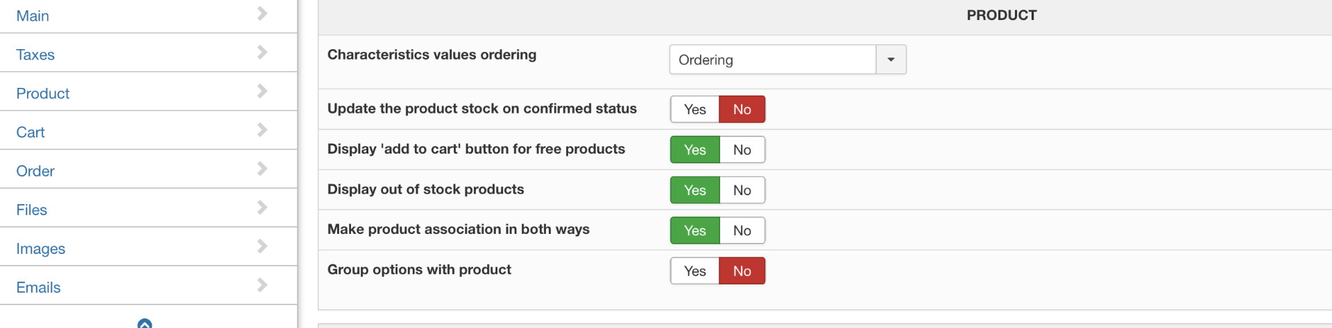

You didn't provide a screenshot of the settings of your product.
Looking at the screenshots you provided thus far, I would say that the problem is probably with the "quantity input" setting of the product which must not be set to "inherit" and thus overrides what you have set in the configuration.

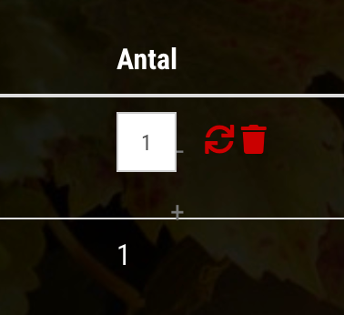

But still LEFT RIGHT isn't working for me on the cart display - it's not on the check-out cart, its the Cart Display you can choose as a menu.

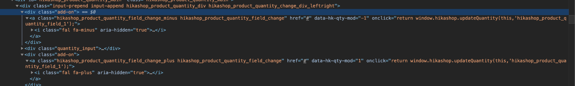

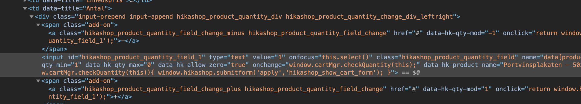

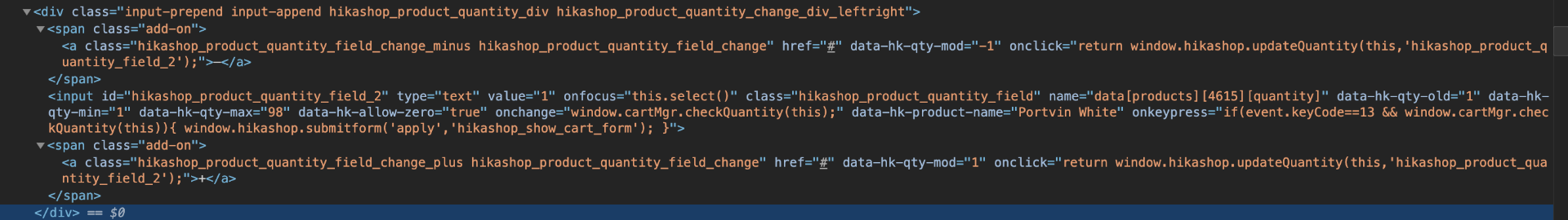

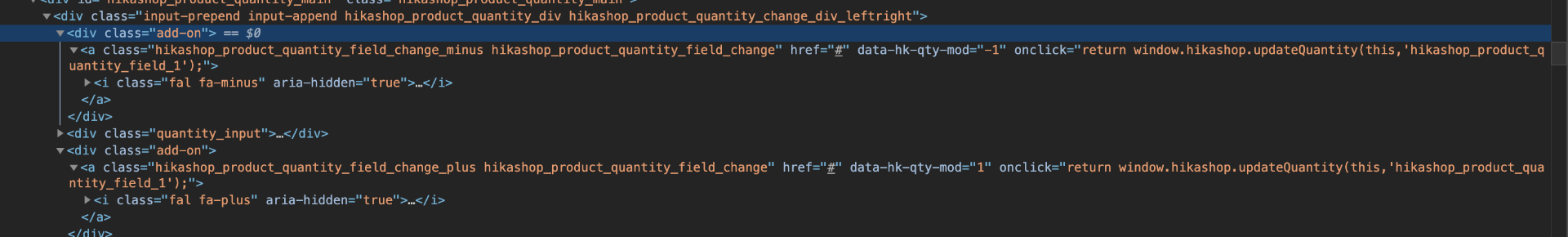

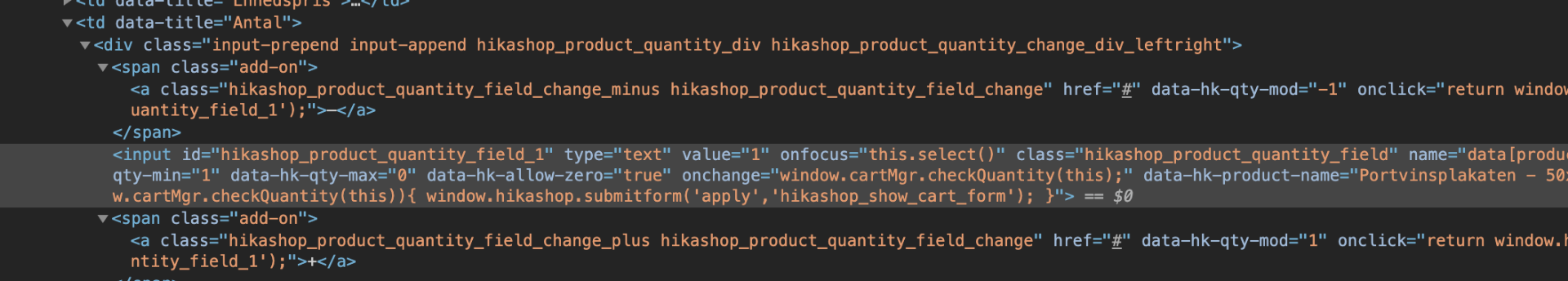

It's like the code on Cart Display isn't using the same files as on the product pages.
Both places have the left right in the code, but only on the product pages are my fontawesome icons - on cart display it's your + and - that are showing.
So it seems like the cart display has its own file to override?
Cart
Product
