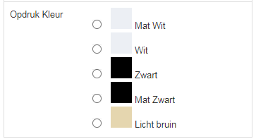

You could use the "radio" type. In each value of the custom field, you could enter an img tag, with the URL of the print image in the src attribute, as "title".
That way, the custom item field would display for all the products and the customers would see the image of the print when selecting it.

Your suggestion is awasome! Thanks.
For the images I requested it for it won't work really, as there are 200+ and that would make the product page HUGE.
However, on a different product I can use it for a color selection and later on also for a font selection.
Above is with first the img tag, then the color name and then a br tag to keep them inline :)
