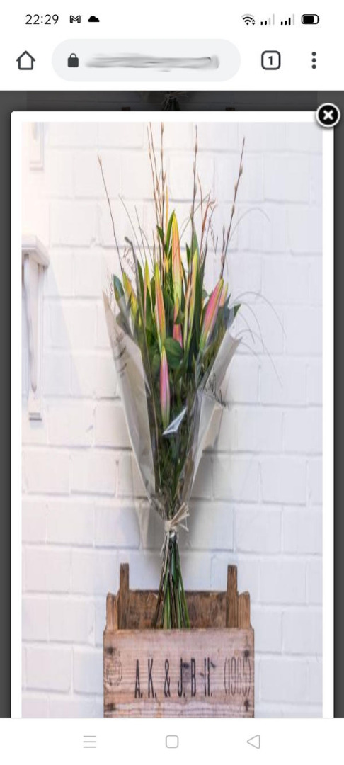

When product images are clicked on, they are displayed modally. This is fine on large screens, but on smaller screens the image proportions are not kept as the image is squeezed into long portrait aspects. The image pop-ups are not responsive. Please see attachment

That's disappointing, as I understood Hikashop was suppose to be responsive. However if it's not possible to view product images using smart phones, without the images being distorted - then I don't consider HikaShop "responsive". As you can see in the attached image of the initial question, the image is so distorted it makes the business look very unprofessional and the image is of no use to customers.

Now, the popup not displaying properly is a problem with the popup system used to display the image.
Looking at your screenshot, it seems that in the "image popup mode" setting, you've selected "mootools" which is an old popup system from 10 years, not well adapted to smartphones.
The default mode is "shadowbox (external)" and it shouldn't have the problem you're describing. If it does on your website, we would be happy to have a look at the situation if you could provide a link to a page with the issue.
Also as I said, the plugin provided by obsidev on our marketplace offers more popup alternatives, with some of them even optimized for smartphones. So you might want to look at it.
