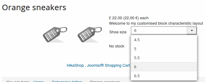

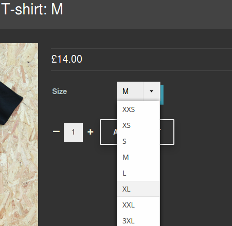

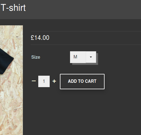

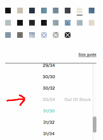

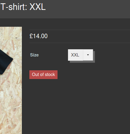

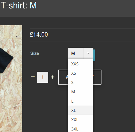

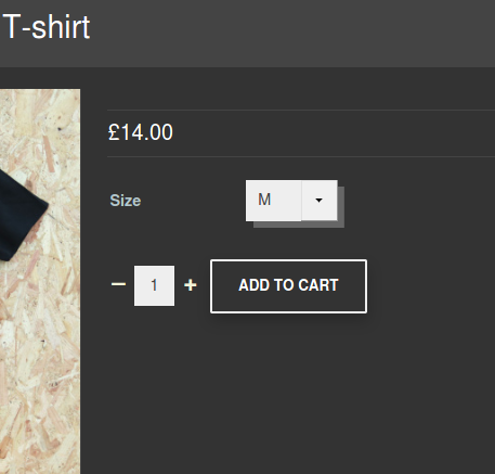

Is it possible to show the stock level of the variant before it is selected - for example - in the dropdown?

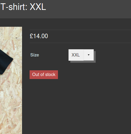

For example, the size XXL is out of stock but the customer won't know this before they have selected it - then are greeted with an out of stock notice - which may cause annoyance.
I know I could just unpublish that variant until I have stock available but I want to keep it active because I will be adding the notify button to the product page - and people might want to know that we can order more, if they request it.

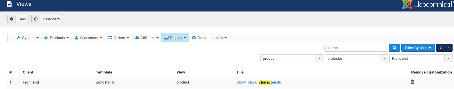

So far in HikaShop there are no options to do that unfortunately... But it's always possible but via an override view ( Documentation ).
Now to be clear we can guide you to perform yourself this custom as usual, but this will require advanced knowledge in Html, Php AND HikaShop view.

I have done some work with overrides and have very basic PHP knowledge but couldn't find the part I would need to change to add an extra word(s) in in this scenario. If you could advise what I would I would need to change that would be much appreciated.

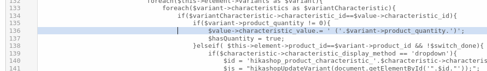

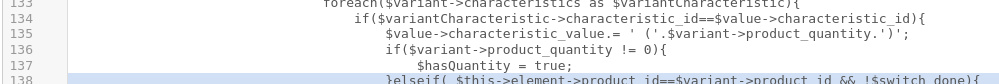

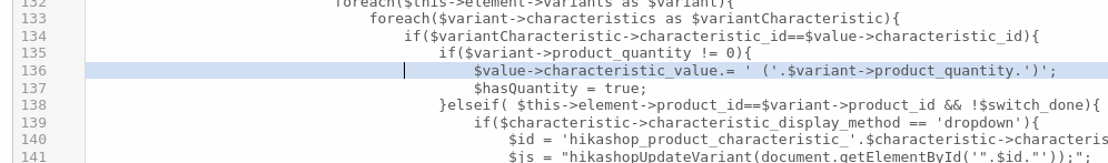

To change that, then you would be left with custom coding as philippe said. In the file show_block_characteristic.php try to add the code:
$value->characteristic_value.= ' ('.$variant->product_quantity.')';
before the code:
if($variant->product_quantity != 0){
This will add the stock of one of the variants for the value in the dropdown.
So it will work fine with one characteristic, but if you have products with more than one characteristic, it will display a quantity that shouldn't be there.

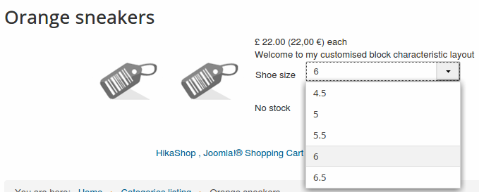

5 years 6 months ago #330312
Thank you, this sounds like what I want.

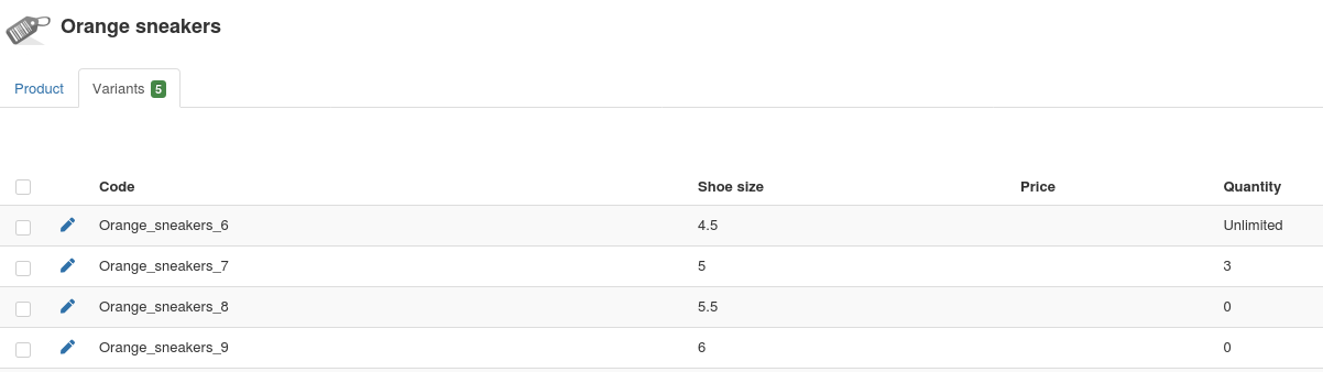

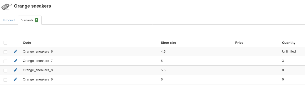

However, I've just tried this on my test site and it doesn't show anything extra in the dropdown. I have added variants to the 'Orange sneakers' product and made sizes 5.5 and 6 out of stock.
(Credentials same as in my other topic)

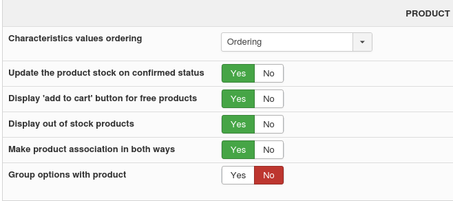

  • Posts: 86220
  • Thank you received: 14223
5 years 6 months ago #330314

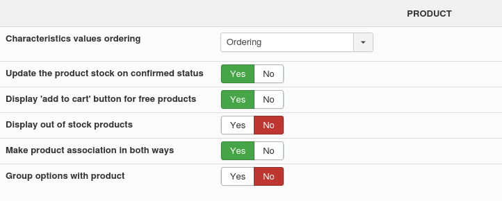

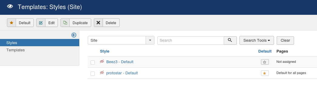

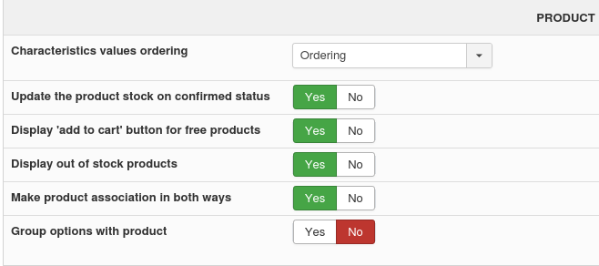

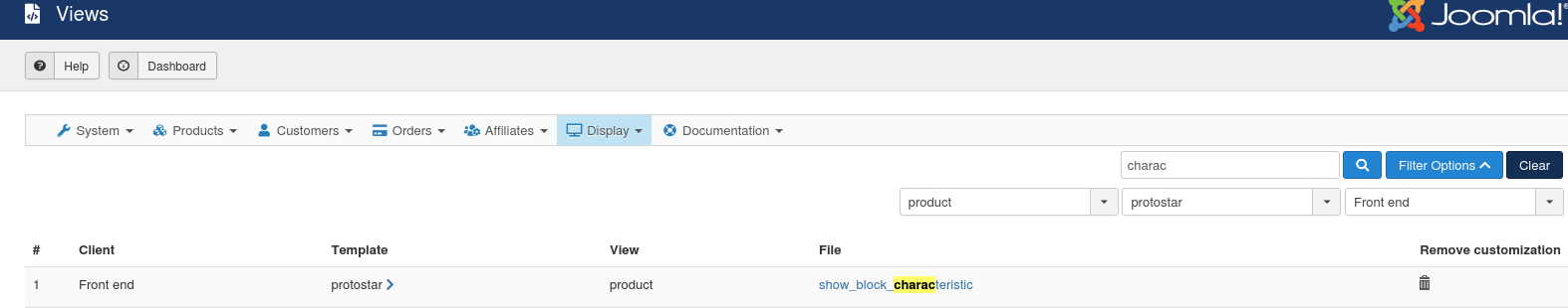

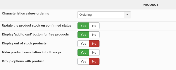

It could be because the option "Display out of stock products" is turned off in the HikaShop configuration, or it could be that you've added the modification for another template than the template you're using on your frontend.
Note also that I've said to add the code BEFORE the other code so that it displays for all the variants whether they have stock or not.
You've added it after, which means that it will only display the stock if it's above 0 and won't change anything otherwise.
So based on your screenshot of the variants, only the choice "5" should have a (3) appear next to the 5.
  • Posts: 50
  • Thank you received: 4
5 years 6 months ago #330325
Apologies, I must have misread. I have now moved the code above instead of below.

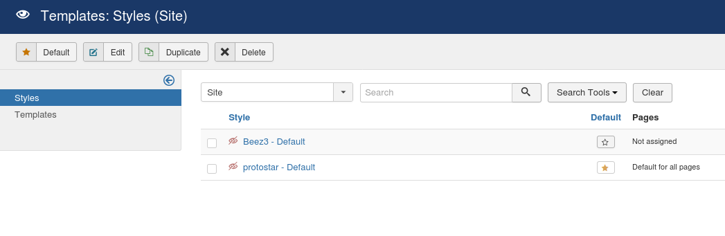

However, 'Display out of stock products' is switched on, and the override is for Protostar, which is the frontend template I am using. (My original post/screenshots are from my live website which I am not using for testing).
It still doesn't show anything.
  • Posts: 50
5 years 6 months ago #330326
When I set 'Display out of stock products' to 'No' it works but obviously I want to see the out of stock products!

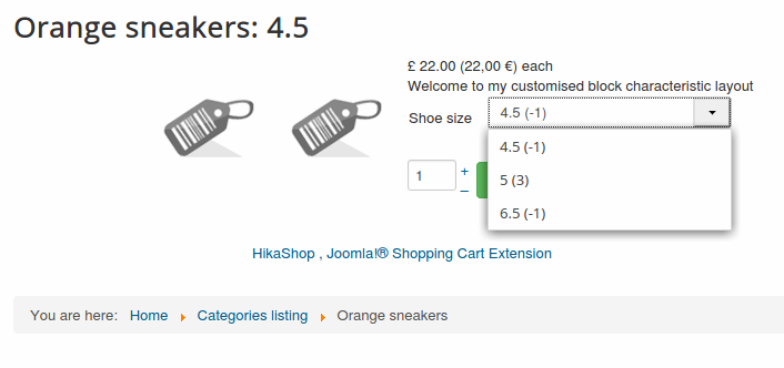

5 years 4 months ago #332427
Hi, sorry about the delay.
I have made this amendment but the out of stock items are not showing in the drop down.

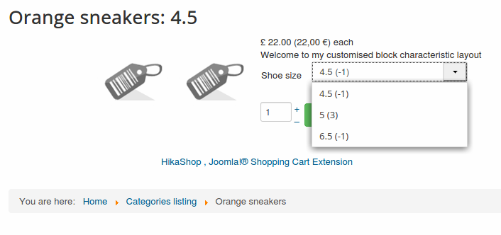

What I would like to see is:
4.5 (-1)
5 (3)
5.5 (0)
6 (0)
6.5 (-1)
But what I am seeing is
4.5 (-1)
5 (3)
6.5 (-1)

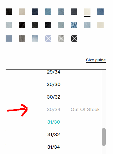

  • Posts: 50
5 years 4 months ago #332456

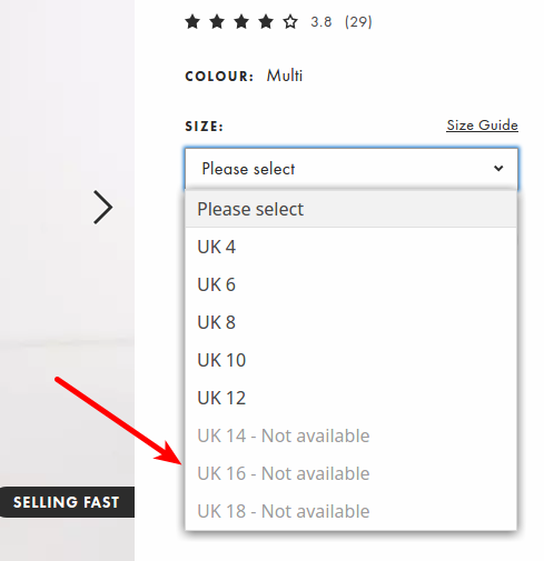

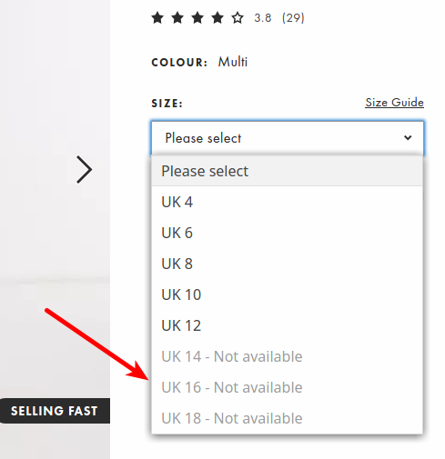

This is a feature of many other online shops (examples attached), please consider it a feature request.
You said that the code you provided above would achieve this, which it hasn't. I have implemented it exactly as you have advised.
