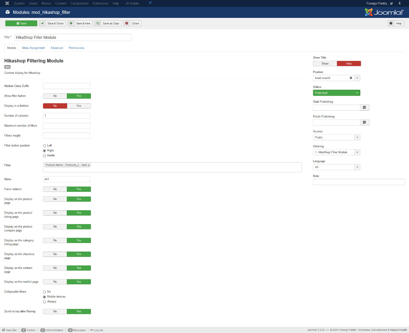

Sounds good. I tried it right away. I created a menu item on my main menu named products. The menu type is HikaShop products listing. My problem is when I enter for example "bread" or "kimchi" and hit the filter button NOTHING happens.
Last edit: 5 years 5 months ago by andrewwinkler.
  • Posts: 86051
  • Thank you received: 14179

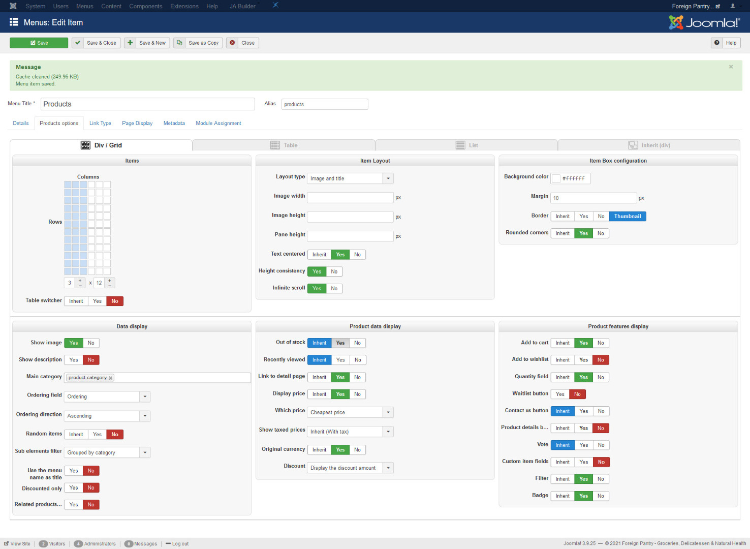

5 years 5 months ago #330788
So several things:
- In the "sub elements filter" setting of that menu item, try to enter "all sub elements" so that you really have all the products of the shop.
-Make sure you turn off the "recently viewed" setting there, otherwise, only the products you looked at recently will appear in the listing of that menu item
- You didn't write that you entered the id of that menu item in the "menu" setting of your HikaShop filter module. So please make sure that it is the case and that you've activated the "force redirect" setting of the module.
If it still doesn't work even though you did all that please, provide the URL of that page along with a backend access and a link to this thread via our contact form so that we can check on the situation

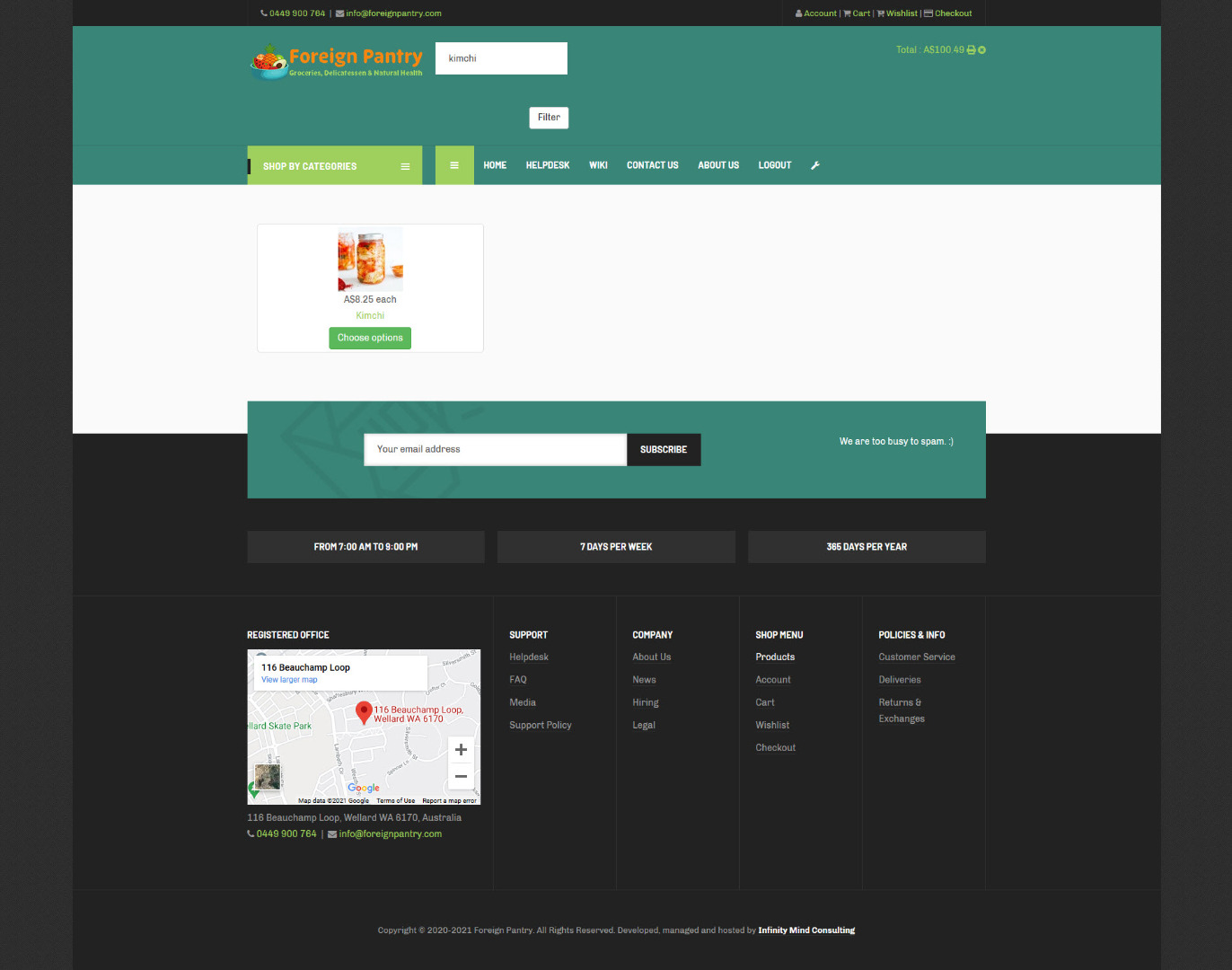

5 years 4 months ago #330910
I disabled Cloudflare for the site by setting it to "Development mode". Then I cleared all caches and tried again, with the same result. The "filter" button of the HikaShop filter module doesn't do anything, nor does anything happen if I press enter after entering "kimchi" or "toast" in the module's form.

5 years 4 months ago #330935
I checked your filter situation today again but I still see the elements from CloudFlare on your pages.
If you look at the HTML of the filter button with your browser:
i.imgur.com/l3KHiG4.png
You can see the code
if (!window.__cfRLUnblockHandlers) return false;
which is added by CloudFlare and isn't in HikaShop by default:
community.cloudflare.com/t/if-window-cfr...s-return-false/74787
Could you double check that you've really deactivated CloudFlare on your website ?

5 years 4 months ago #331152
I found the issue.
It actually came from the settings of the filter.
You've configured your products listing to display all the products under the "product category" category so that all the products of the shop appear on that page.
However, in the settings of your filter, you've selected many categories where you want the filter to appear, but you didn't select the "product category" category. And thus the filter was not activated on this page.
If you want the filter to work anywhere, you should either remove all the categories from the "category" setting of the filter, or select all the categories in it.
I've just added the "product category" in that setting of your filter and it's now working fine.

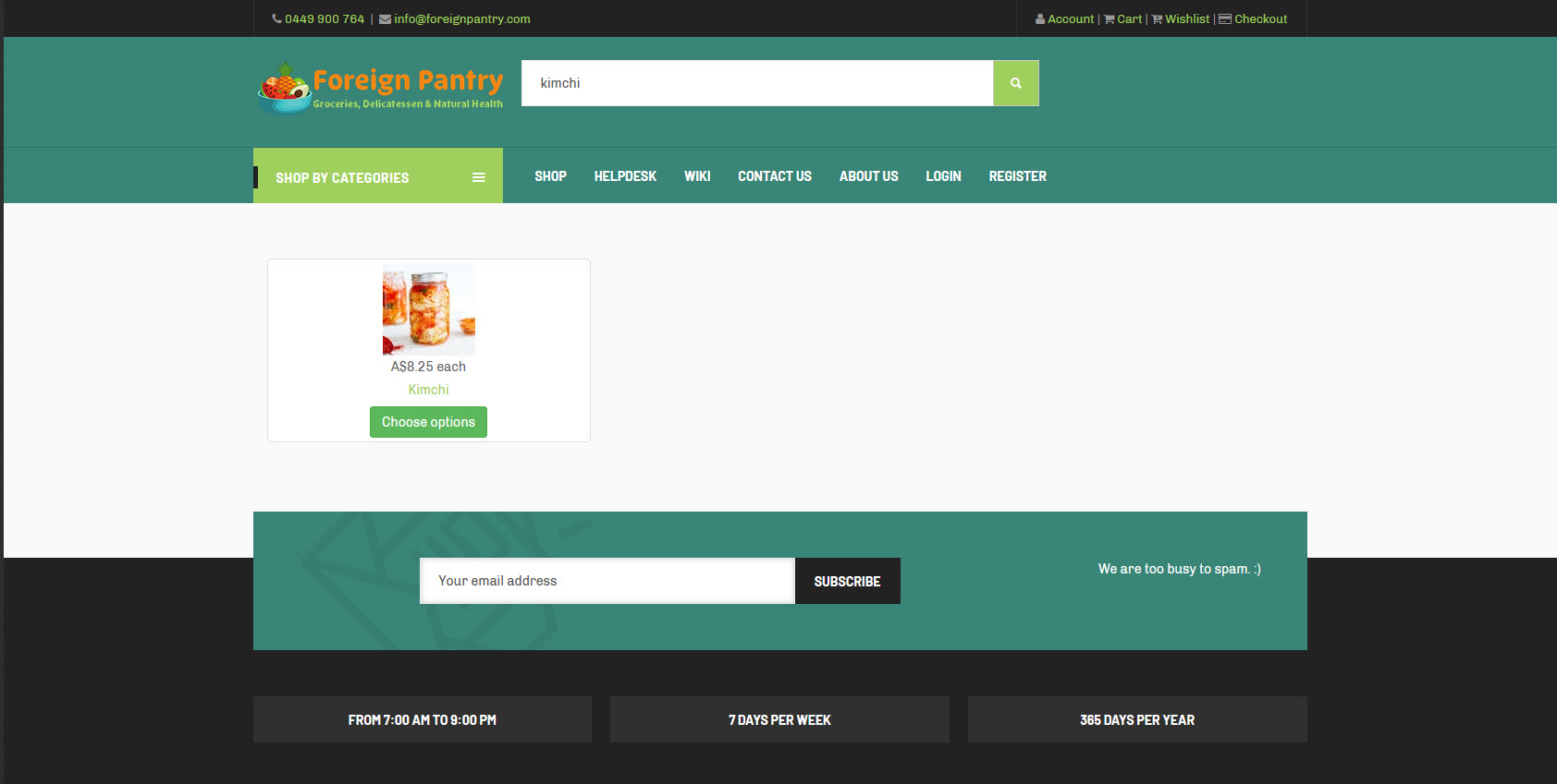

  • Posts: 121
5 years 4 months ago #331163
Great. It's working now. Thank you very much.
Now, how can make it look more like the standard joomla search module so that I can replace the latter on all the other pages?
In particular, I want to change the following things:
1. I want to increase the width to a similar size.
2. I want to move the filter button right next to the field where to enter the search word.
3. I want to replace the word "Filter" with the search icon.

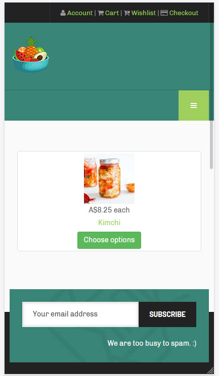

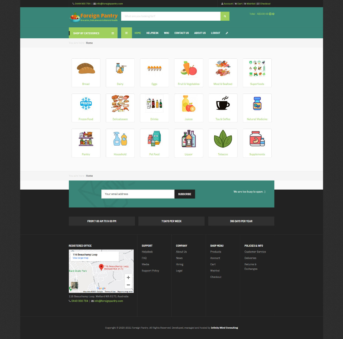

I got it to work on foreignpantry.com for the desktop screen, but for some strange reason, neither the category layout module nor the filter module are being displayed on the mobile screen.
Last edit: 5 years 4 months ago by andrewwinkler.
5 years 4 months ago #331311
We just go to your website to see your issue by ourselves and it appear that you solve your mobile display issue for your module "Shop by categories", but not for your filter module.
For this can you try to go to your Filter module settings and define "Collapsable filters" on always value.
Hope this will solve your issue.
Last edit: 5 years 4 months ago by Philip.
  • Posts: 121
5 years 4 months ago #331368
When I do this, the filter search bar is being displayed as an expendable icon on the desktop screen, but still nothing on the mobile screen, so I switched it back to "never".
5 years 4 months ago #331373
Then, can you process a test with a default template like ProtoStar to see if your module is now present in the mobile view in this specific case.
If with a default template your module is always present in classic view, but not in mobile view then, we will need to this this by ourselves.
And so, can you provide backend access (url link & admin ref) via our Contact us form, don't forget to add in your message an Url to this topic (in order to keep the link).
Awaiting your element to be able to progress on your subject.
The following user(s) said Thank You: andrewwinkler
  • Posts: 121
5 years 4 months ago #331401
The problem has been resolved by removing the template's "hidden-xs" bootstrap code for the "head-search" module position.
