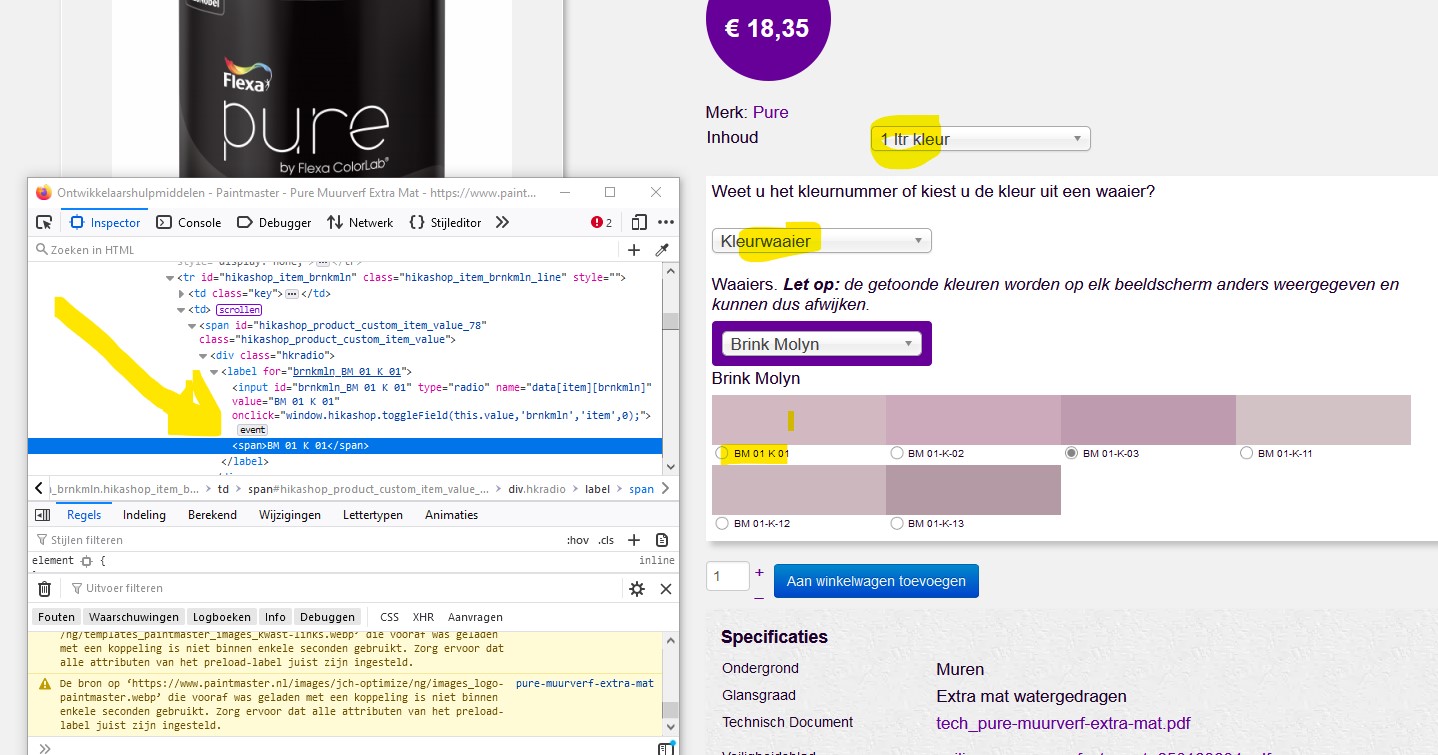

Hi there,
In order to speed up the page where I have many (hundreds) of color-values in a custom field, I want to remove all the <span> tags inside the part
<label for="brnkmln_BM_01_k_01>
<input id="brnkmln_BM 01 K -1" .......>
<span>xxxxxxx<span>
</label>
Is this possible by using an override? I could not find te right override-file. In show_block_custom_item.php the value is echod, but where is the value set?
But maybe more important to speed up the page: is the a way to use Ajax to chooose the color-value dynamic? In that way all values don't have to be loaded on forehand.
Best regards,
Peter
