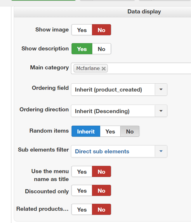

Now regarding the 404 error, I'm not sure why you would get a 404 error. Could you provide a screenshot of the settings of the category ?

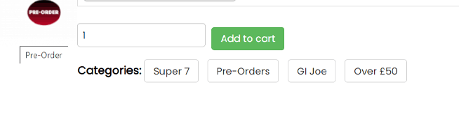

the Macfarlane category is already set up as a product listing and if I click that menu item I get the product list as expected. There are 2 categories within that also Warhammer & My Hero Academia which show at the top before the listings if I click the Macfarlane link from the product detail page. I get sent to /action-figures/gi-joe/category/mcfarlane If I then remove /gi-joe/category so the /action-figures/mcfarlane the page displays correctly. So in the attached screenshot (cat-buttons) If you click Super 7 it goes to action-figures/super-7/ not action-figures/super-7/category/super-7
The pre-orders is set up in the same way. As I have said though I have ended up with packaging at the end which fails. The products are often in more than one category.
David
Last edit: 5 years 4 months ago by davec. Reason: additonal image & description
