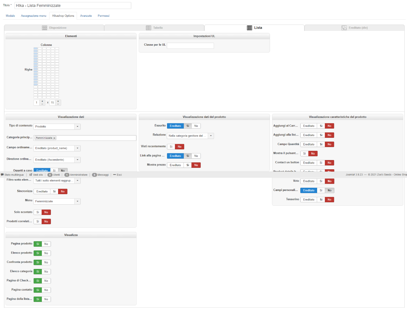

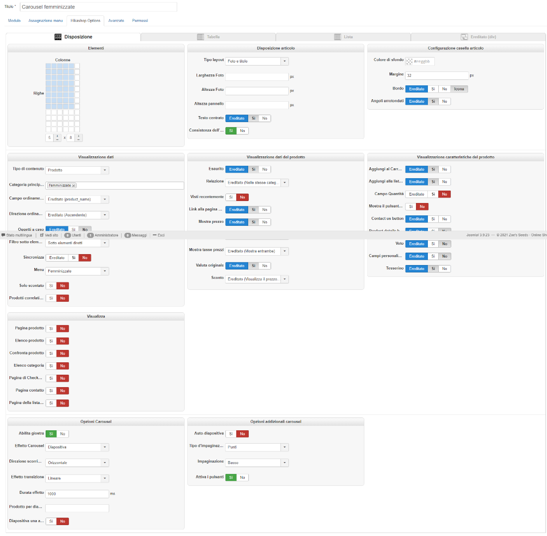

- All my modules/carousels have a specific menu item selected in the menu drop down option.

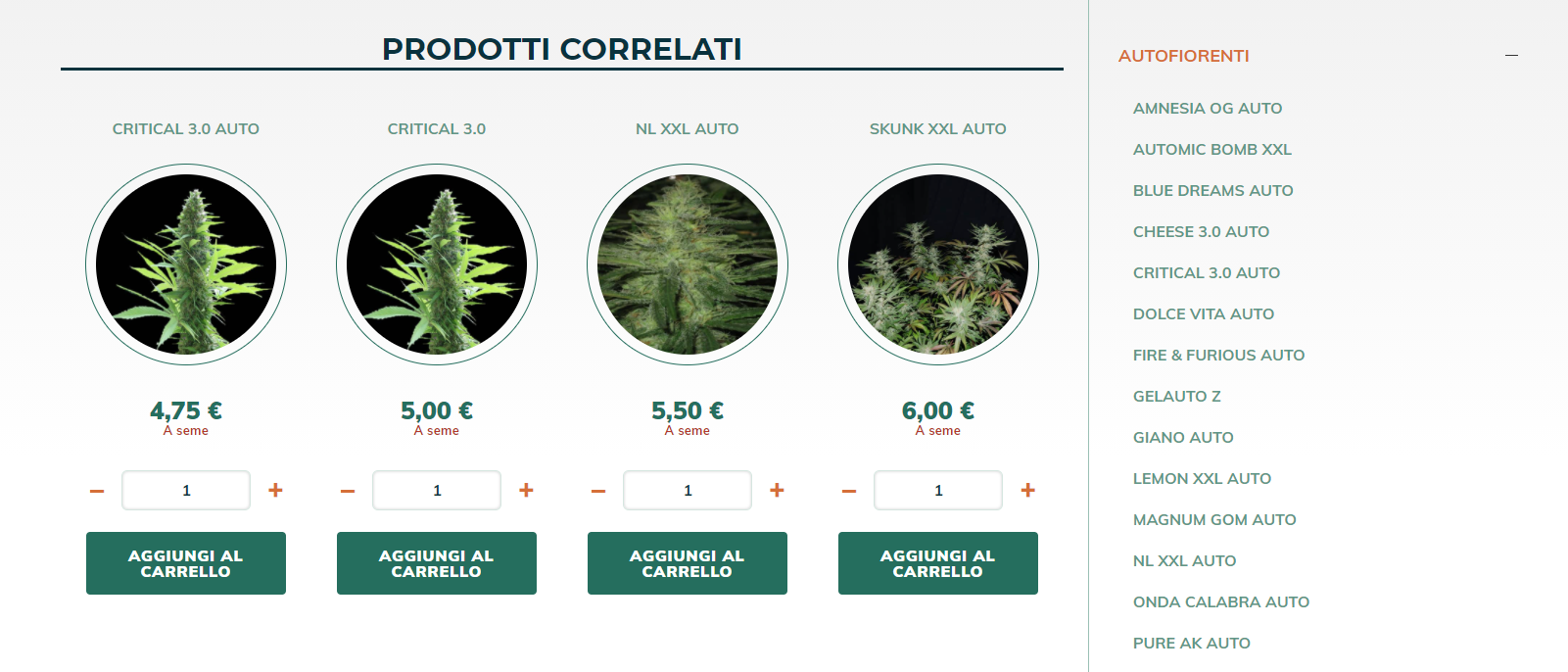

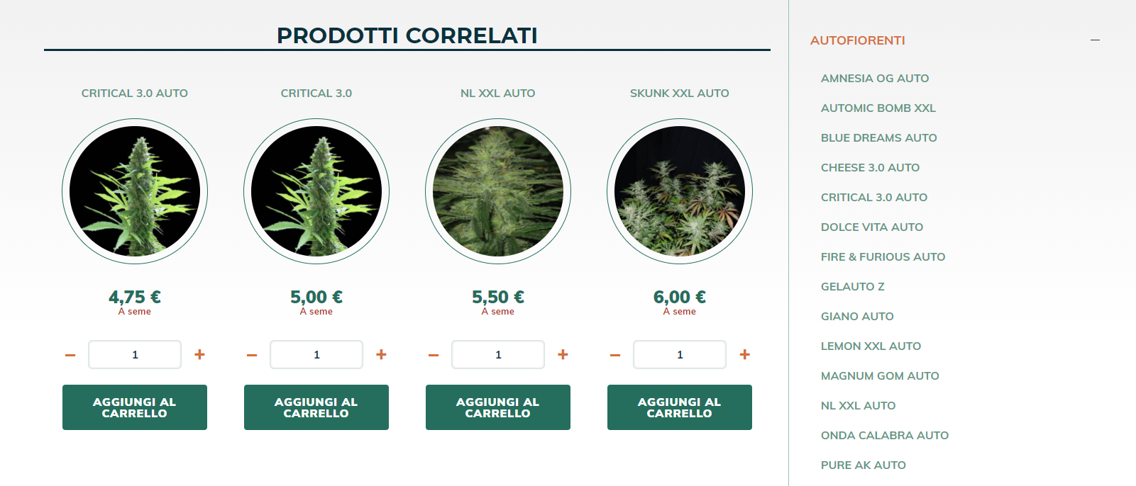

- Carousel are loaded only in the home page, while the content modules are displayed on every product page as list inside an accordion, like a menu beside the related products module, which has his menu item specified.

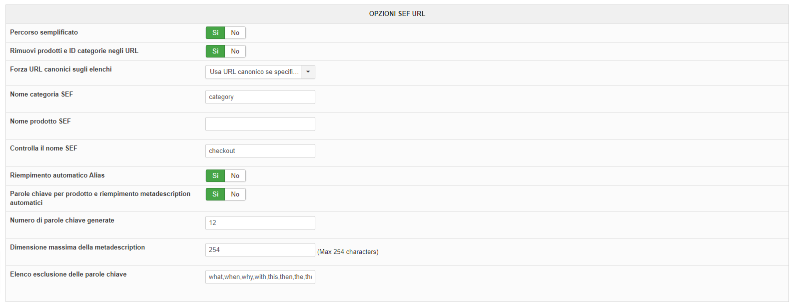

- Sef config is set to force canonical.

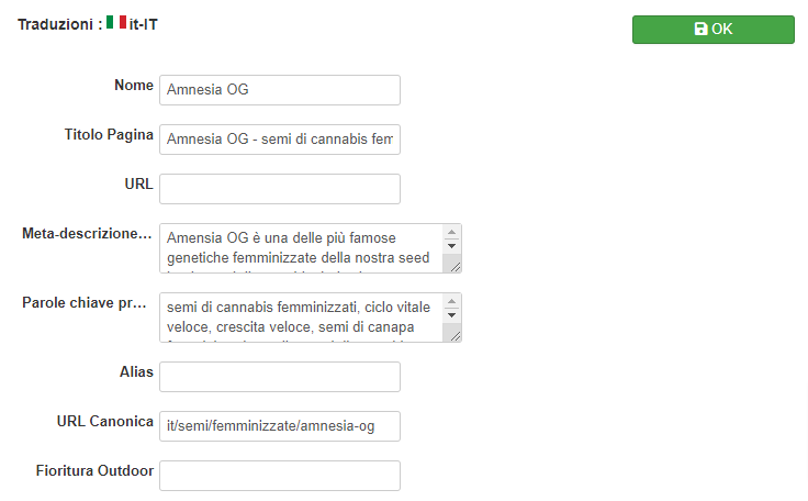

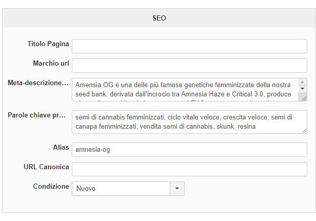

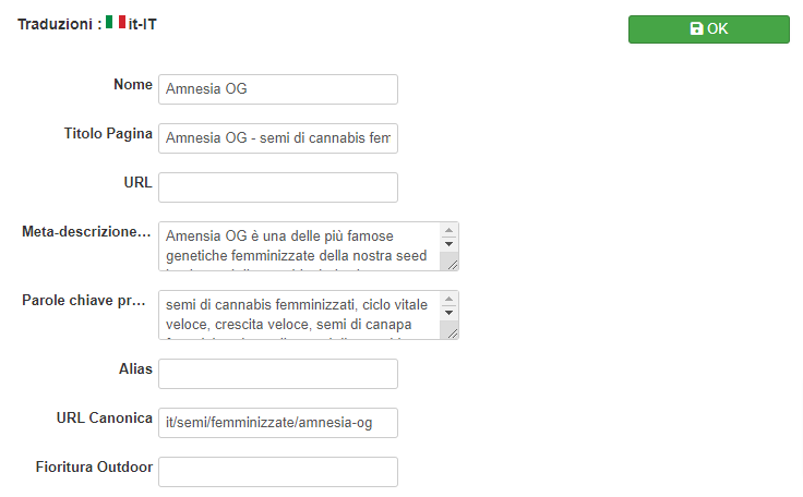

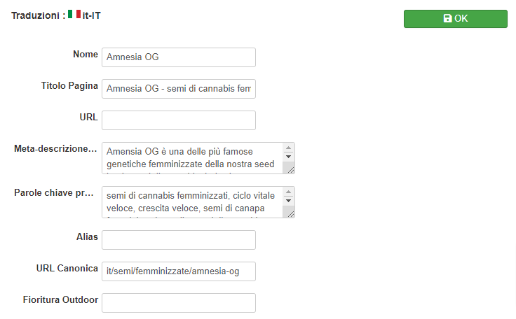

- All the pages in the Italian version of the site have the canonical url defined, using falang pop up; not in the general product page (is this correct? Or should I write a canonical url in the general product view too?)
They lack in the french and English version, cause of I was testing them on Italian version before replicate them on the others.

That also means that it is not HikaShop adding that canonical header tag since HikaShop would add the canonical URL you would have specified in the canonical URL field of the category (or the translation) and thus it would be the same canonical URL regardless of the extra parameters.

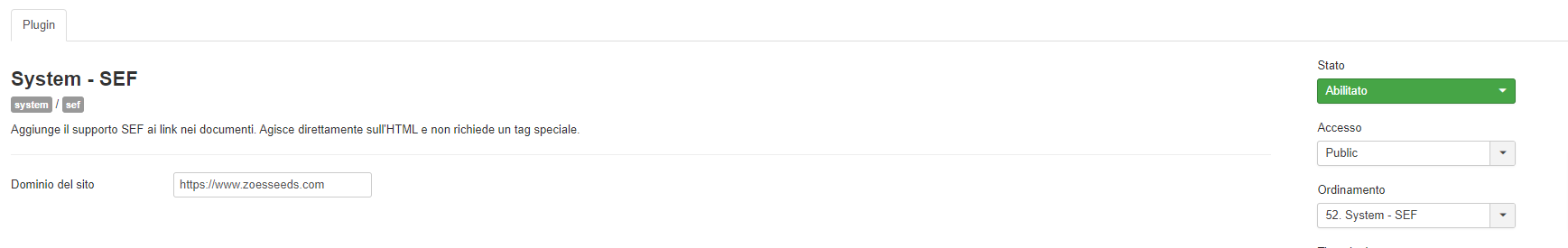

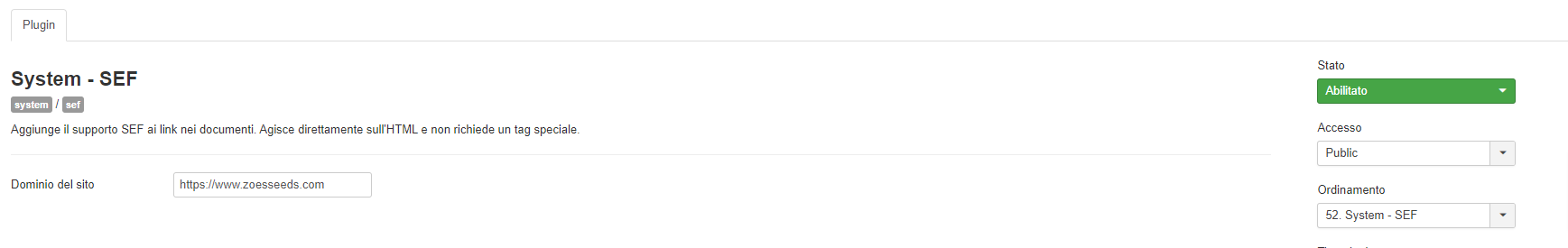

From experience, I know that this can happen with the SEF system plugin of Joomla. So if you have it activated, try turning it off. Instead, I would recommend using a third party canonical URL component dedicated to that purpose. It will allow you to have a fine grained handling of canonical URLs and help your SEO endeavours.

For now I've cleared the Site domain Url in the System - SEF plugin; doing so I'm not seeing the rel="canonical" attached to the site urls, except for hikashop pages, meanwhile I'm looking for a new plugin that doesn't mess the Hikashop canonical config.
If I turn it off completely I lost many images (I've seen a post on forum about that during search)
Anyway, this could be just a temporary solution as we're building a blog too and we'll need to have canonical urls enabled for the articles.

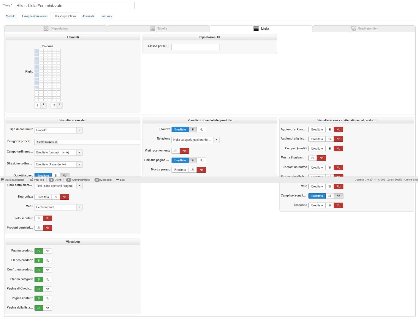

Today I have also trashed all the hikashop content modules, displayed as lists, that I was using like simple menus, even in the footer, so basically on every page; instead I'm using Joomla menu modules.
Calling those links above give me an error 500 as the listing_seed_card (a personal override of default listing) isn't found anymore.
But there are still plenty to investigate.

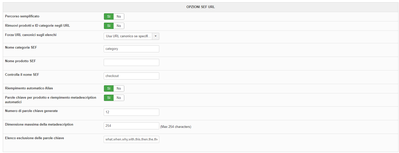

As said I have Hika SEF config to use the specified canonical URL and Joomla SEF plugin turned on but without a specific domain (just to see the images).
I'm not going to touch the config parameters until your answer; just check and correct the canonical urls in the english and french version of Hika products.
