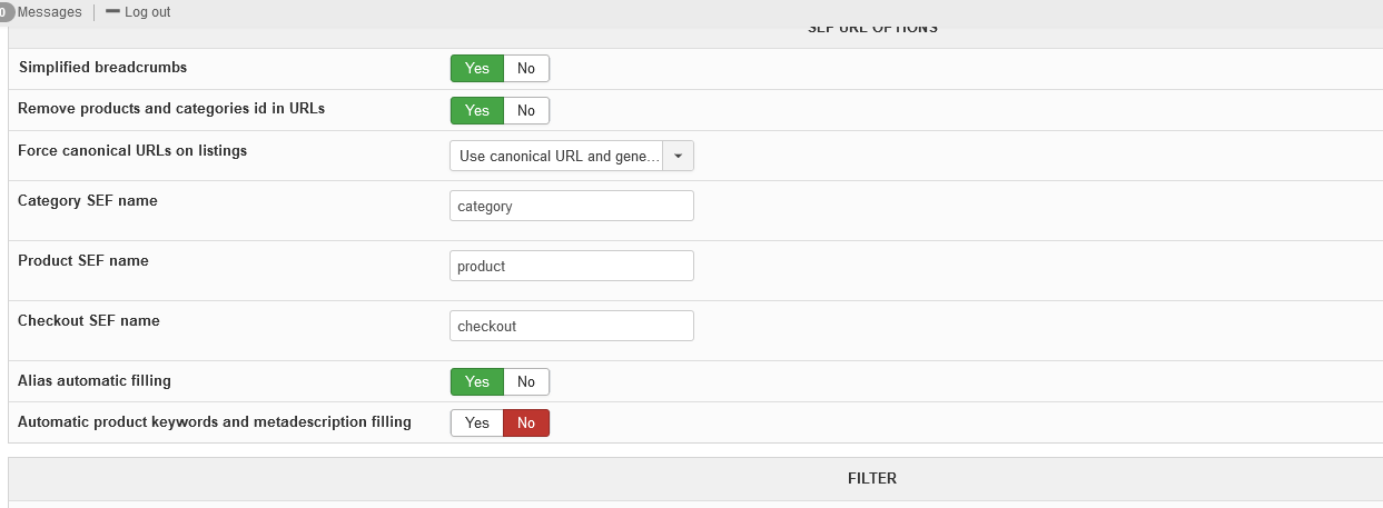

First, we would need a screenshot of the settings you have in the SEF section of the HikaShop configuration and that you tell us if you have something in the "canonical URL" setting of the product / category with the issue and if so what do you have there.
That should allow us to have a better view on the situation. Also, it would be great if you could provide the URL of the page where you got that URL wich results in a 404 so that we can check the HTML there.
These will allow us to better understand the situation to be able to provide a solution.

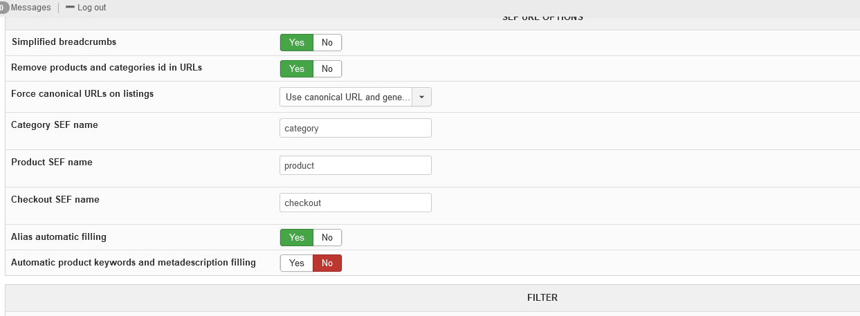

5 years 3 months ago #332565
Here is the link, and attached a screenshot of the SEF settings in Hikashop.

  • Posts: 86051
  • Thank you received: 14179
5 years 3 months ago #332567
It's a shame you didn't provide all the information I requested.

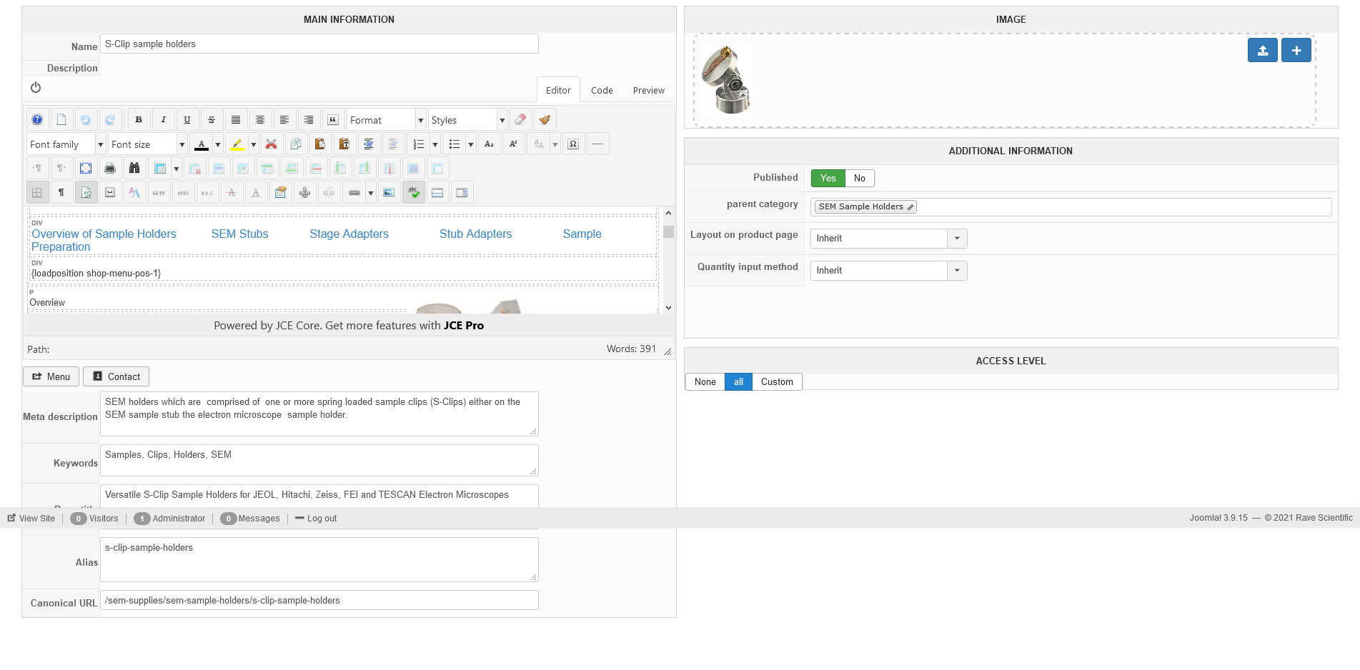

5 years 3 months ago #332574

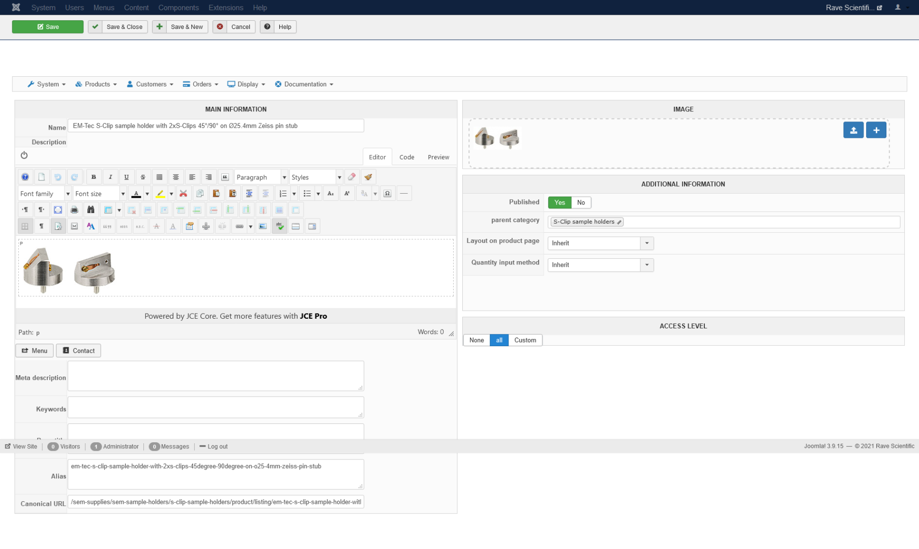

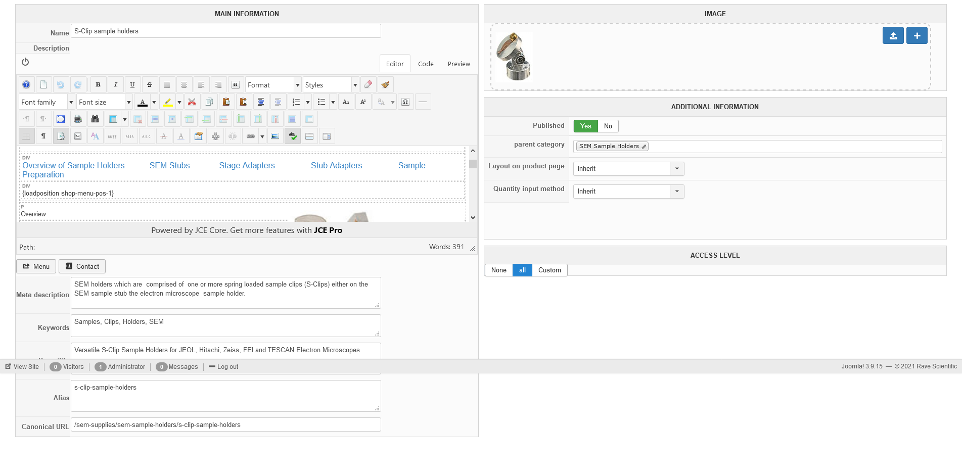

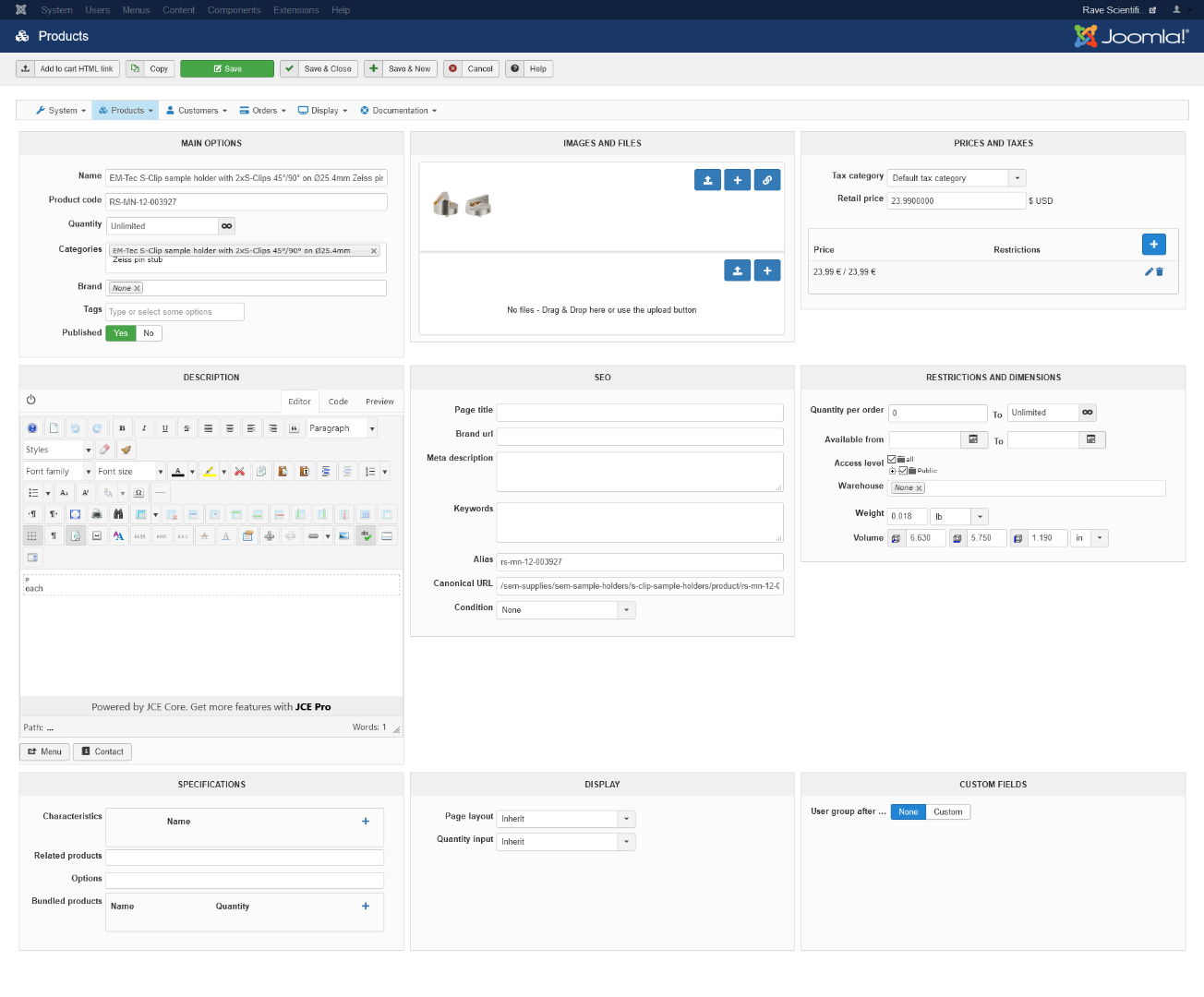

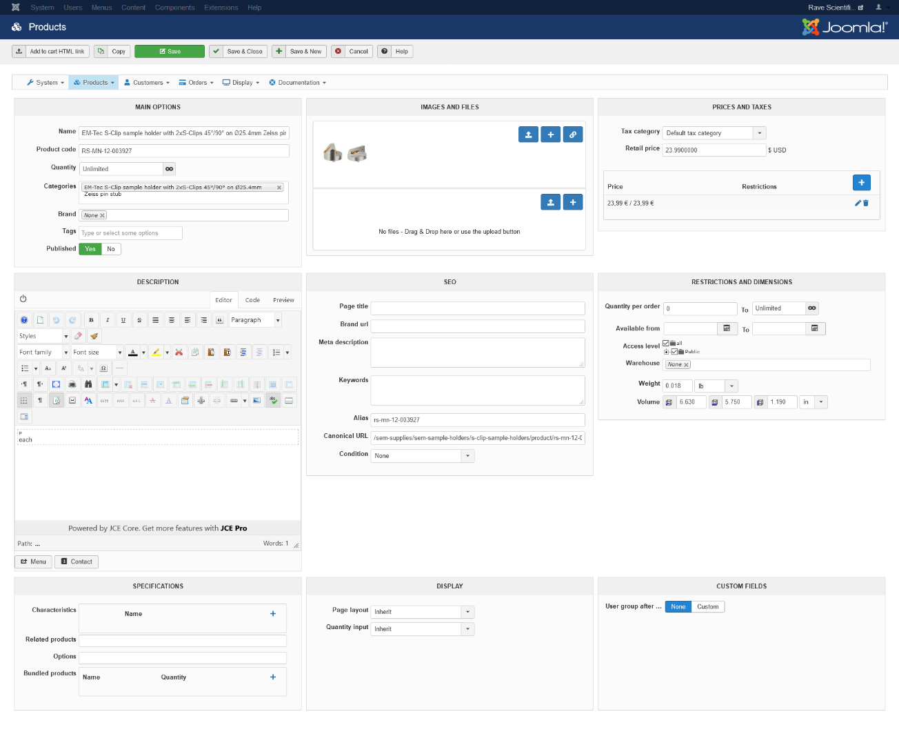

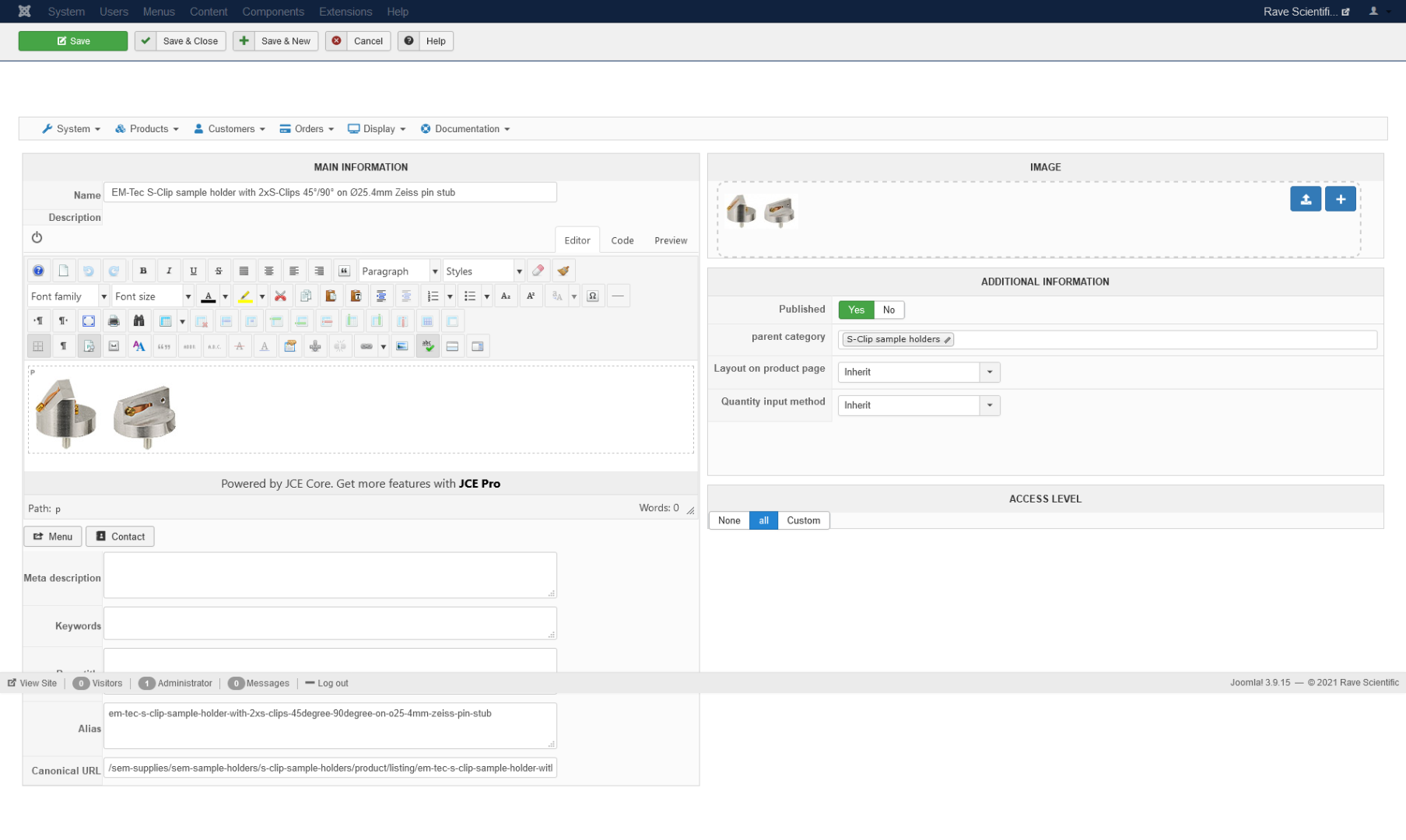

I'm sorry. I thought I provided everything you asked for. My mistake. I'm going to assume that you are also looking for screenshots of the product and category settings for these. So I'm adding them too. I hope that is what you mean.
Regarding your questions about the " URL of the page where you got that URL which results in a 404" I provided you the link and also the link after I modified it "to no longer have special symbols in it". Those pages give a 404 response. These are found through Google Search Console. I think I may have come across them from searching too.
