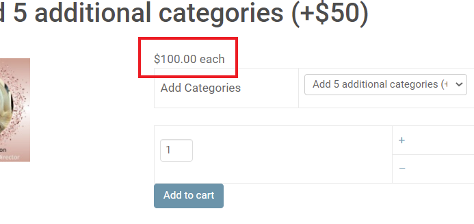

In the product page, I want this item to be larger only here.
I tried using CSS to make it larger and it did! But it also made it larger in the actual cart.
How can I change it only on this page?
Pam

In your CSS code, you must have done something like that:
.xxx { ... CSS styles... }
However, that xxx class name is used on both the product page and the cart.
So solution is to prefix your CSS class with another class only used on the product page in a HTML element parent of the area you're targeting.
For example, you could change your CSS to :
.hikashop_product_page .xxx { ... CSS styles... }
That way, it would work the same, but only on the product page.

Eureka that worked! It changed it just fine!!! And left the font size in the actual cart the normal size!
.hikashop_product_price_main {
font-size: 4rem;
You're my hero.
