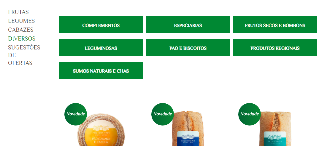

I needed your help to understand if it is possible to put the names of the categories visible within a product listing.
At this moment I have set up a list of categories that after clicking on the links with the products no longer appear.
What needs to happen is that the links are always on the page and you can navigate between various categories without being necessary and to the main menu.

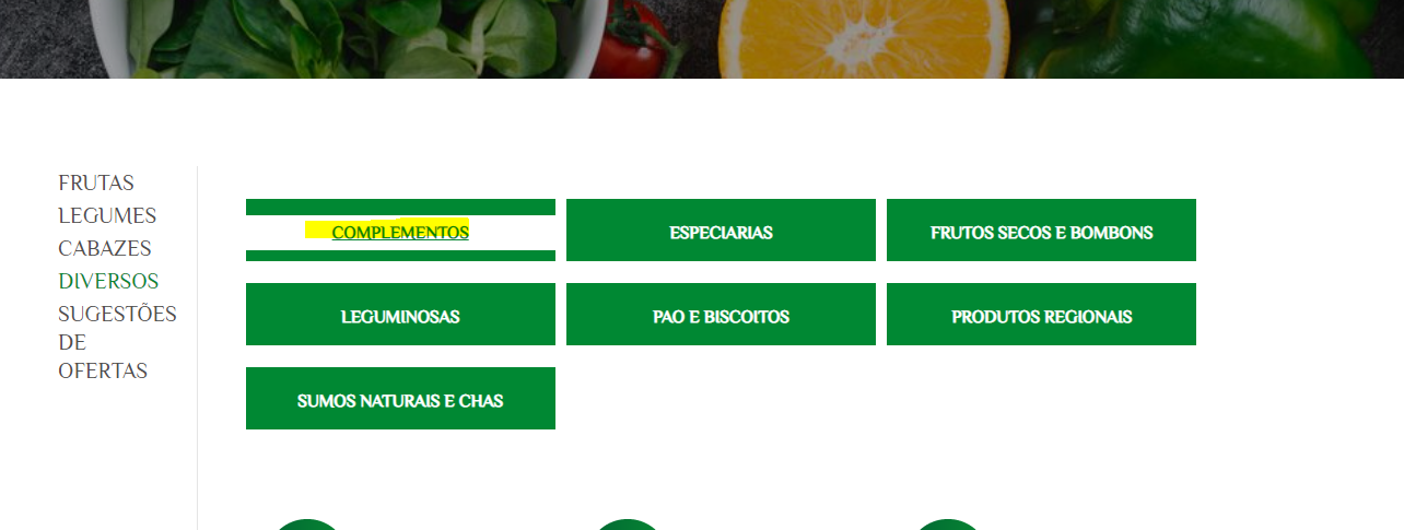

It's possible.
You need to do two things:
- configure your menu item to be of the type "products listing" instead of "categories listing".
That way, you'll only get the products displayed.
- configure a new module instance of the type "HikaShop content module" via the Joomla modules manager to display the listing of your categories and configure it to appear on that menu item only, and for the position of your template at the top of the main area (so just above the products listing).
The look will be the same and it will work the same, but the module will still list the categories even when you access a category.
