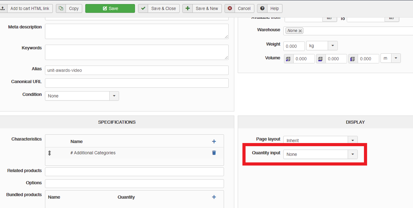

I was looking for the same but this does not work for me. I have set it to none but the quantity box is still visible (I have deleted cache etc). Is there another setting that has to be made first? I do work with a template override, not sure if that matters. Is it maybe possible to remove it from the template override for the category? Since I need the quantitiy box to only show in one category and not show in all the other categories.
Thanks in advance.

On the Product page, there's a section for Display ....

Yes, like I said, I did that, but the quantity box is still visible. So it's not working. Is there another way? Or can I hide it in my template override by removing the code of the quantity box? And if so, what code do I have to change?
Thanks in advance.
