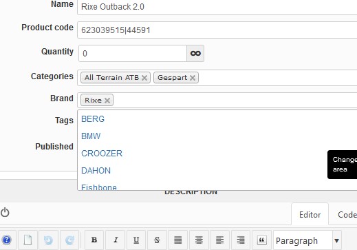

after updating brand information (eg description ) the product listing will not shown anymore in brand view. Error was already in 4.4.2 but tested also with 4.4.3 on my test system.

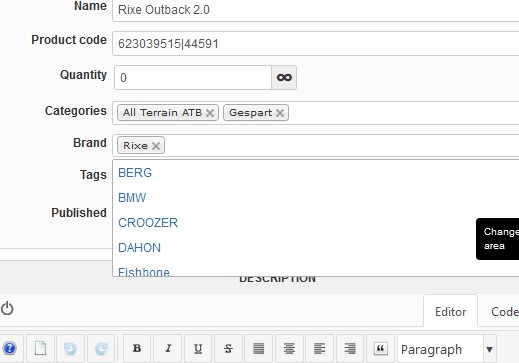

But after doing so you have 2 additional fields in the brand backend.
Also the brand is not available in the drop down list of the product page.

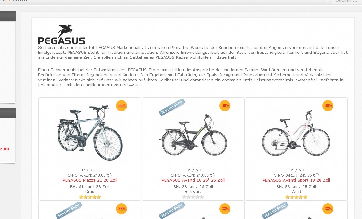

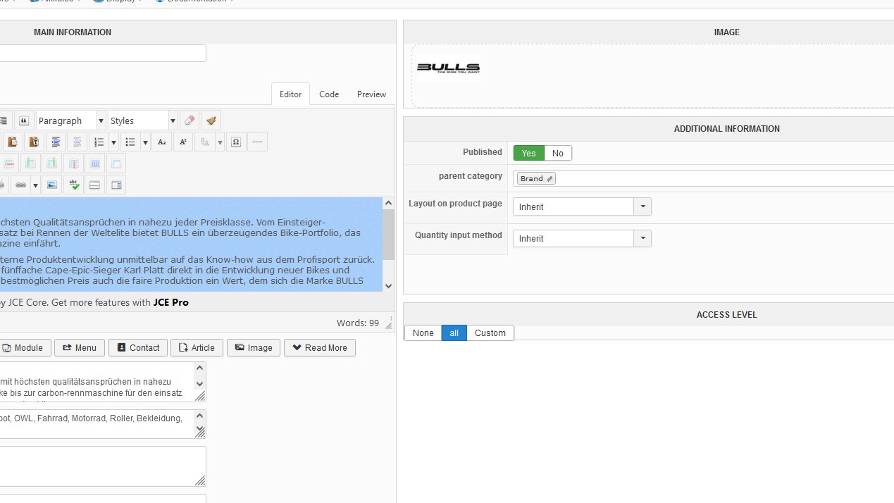

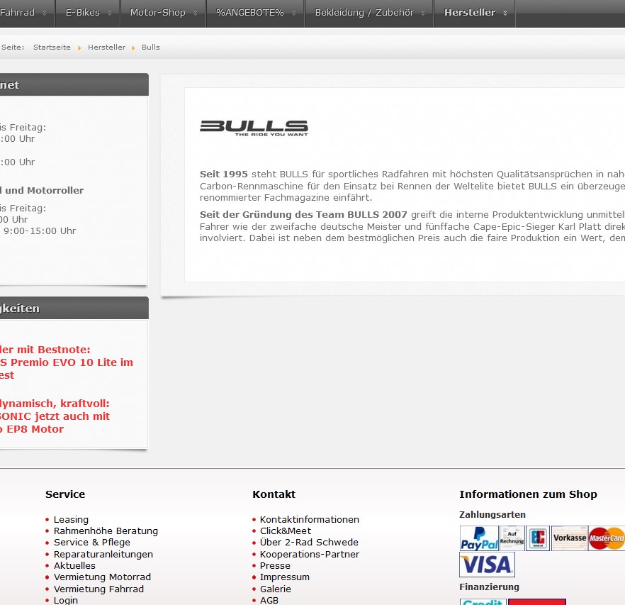

Thanks for your reply but you misunderstood me. Everything worked before.

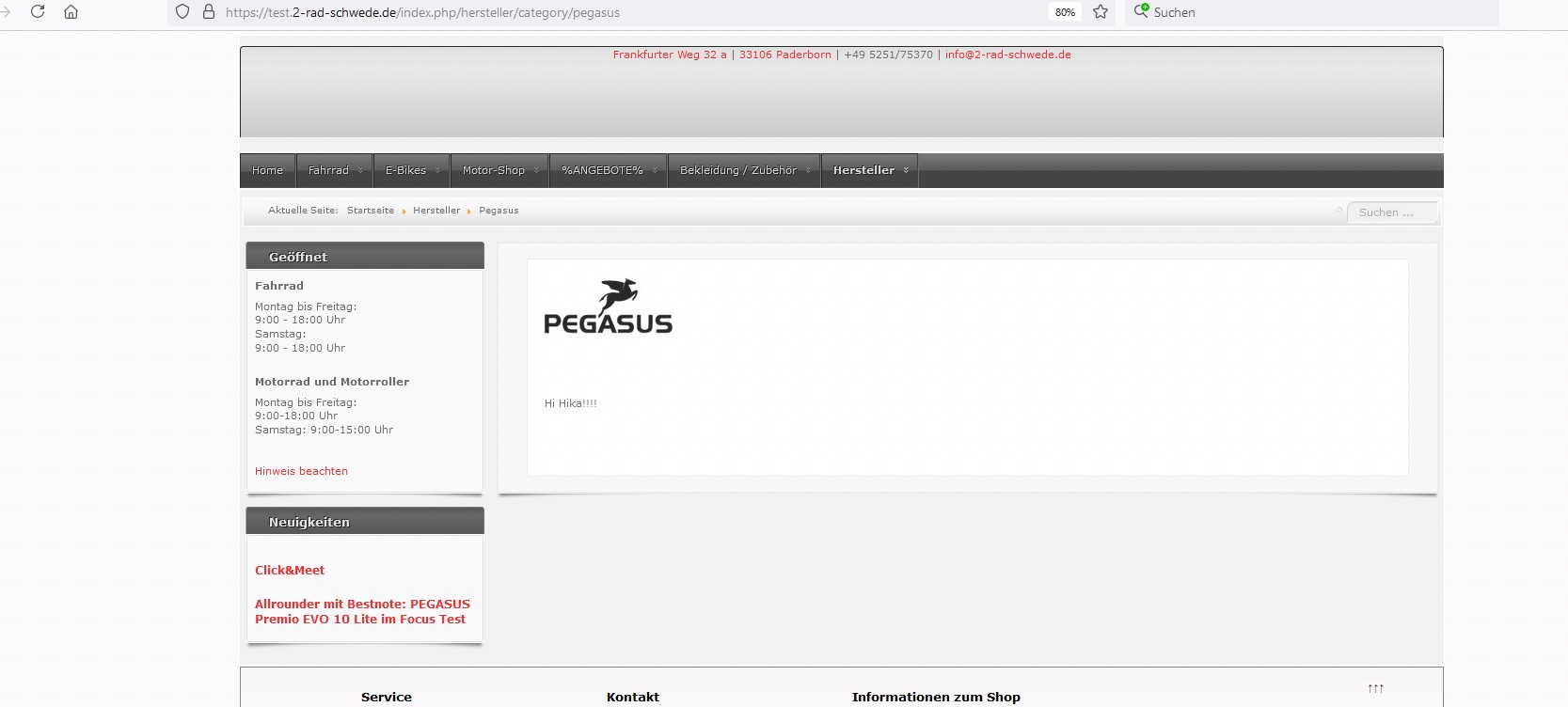

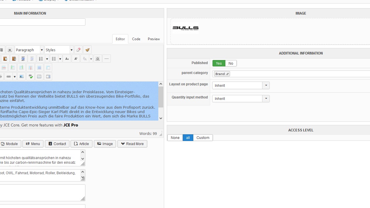

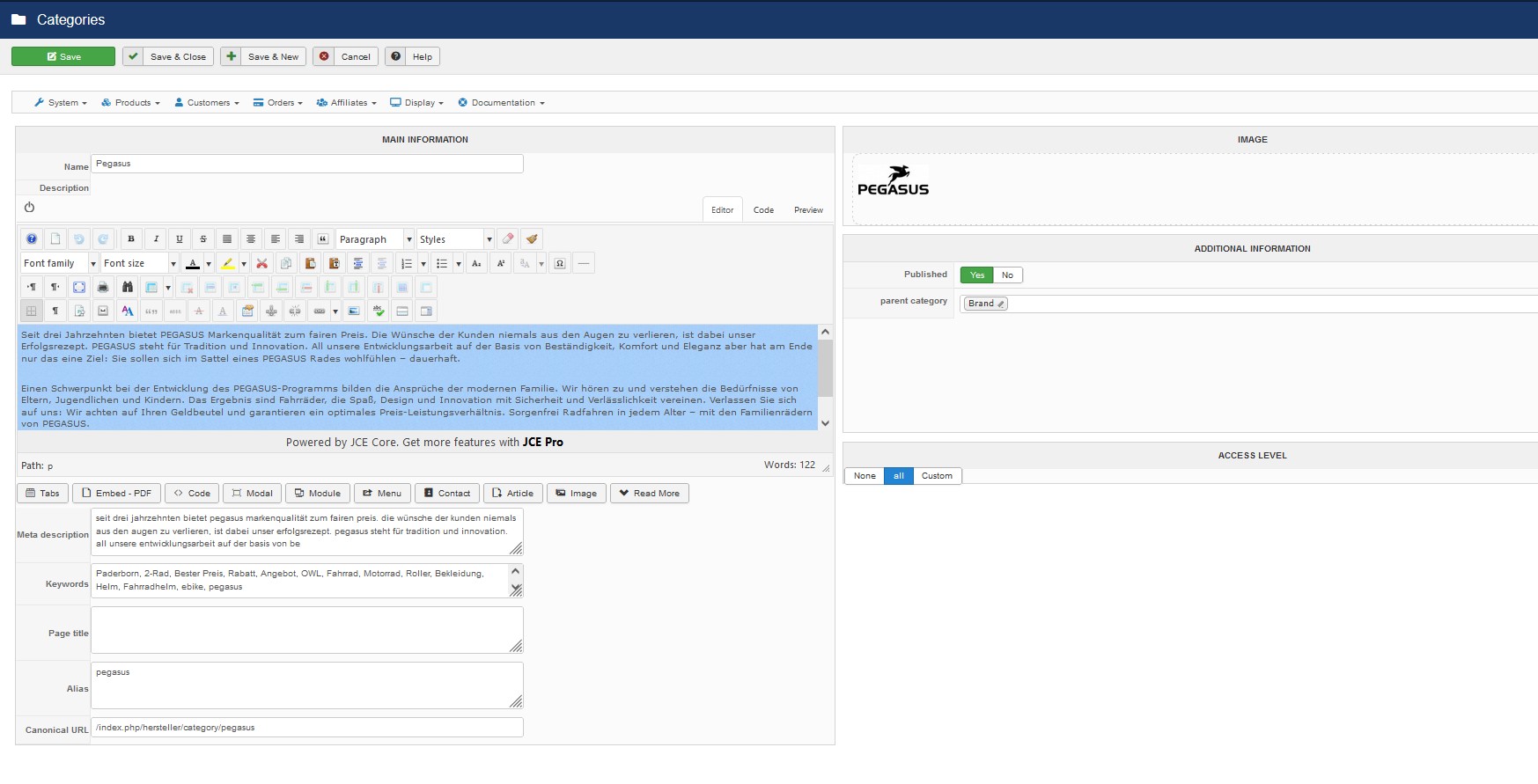

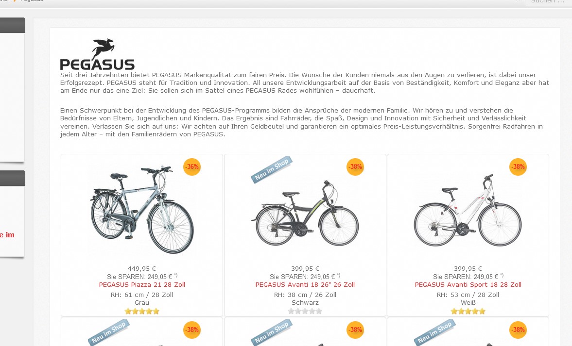

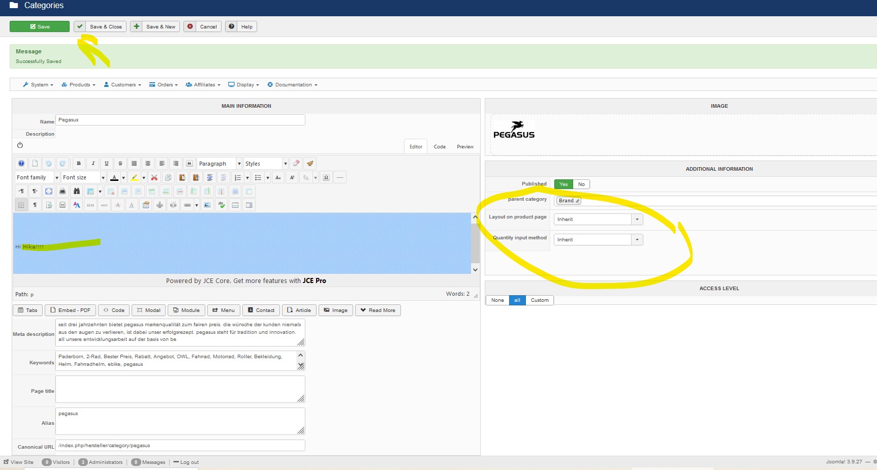

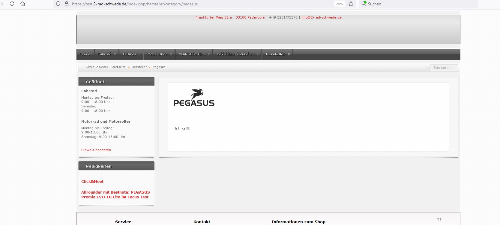

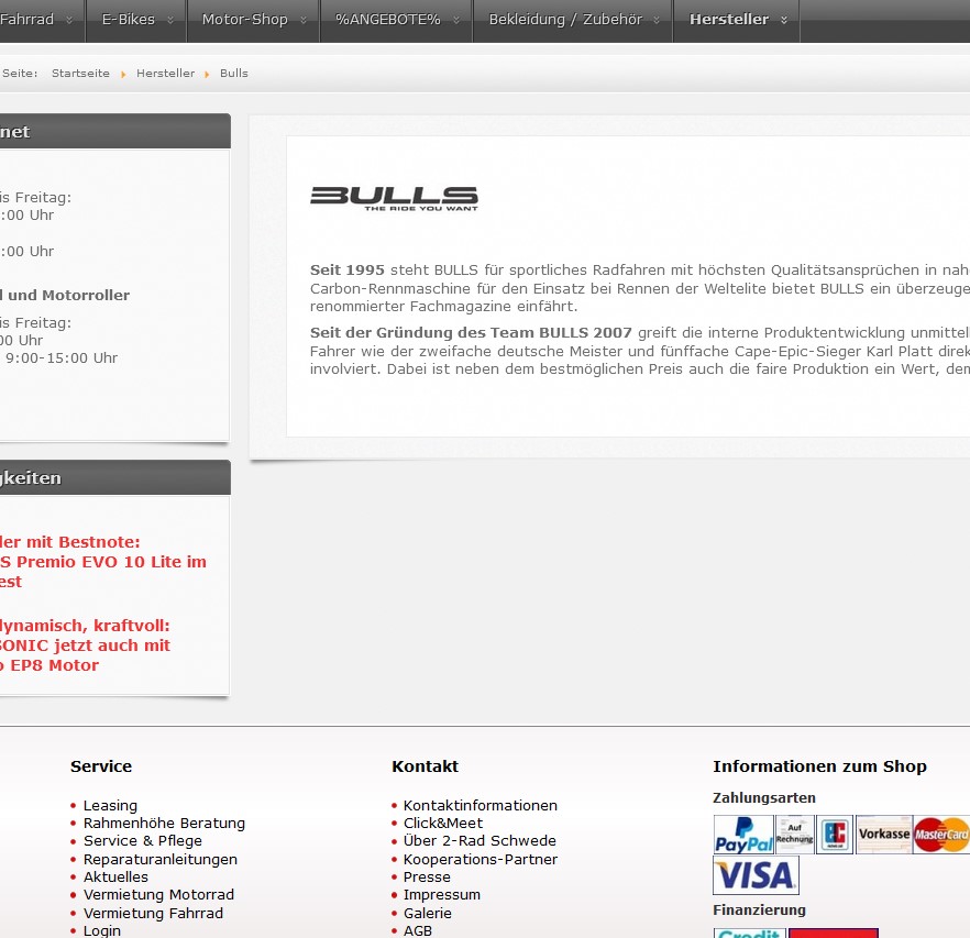

Let me show in more detail what happened in our Testsystem (on 4.4.3 but same issue we have also with 4.4.2 on Production). The corresponding screenshots you’ll find attached.

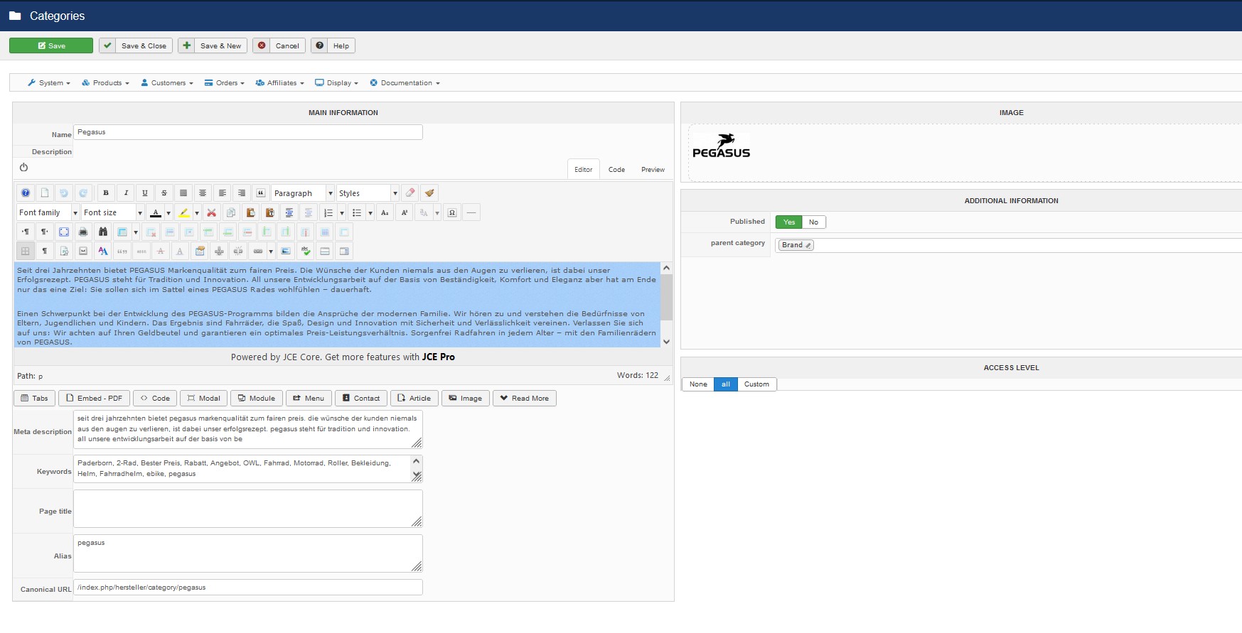

1) Everything fine and you see Products below the brand
2) This is how is configured in the backend

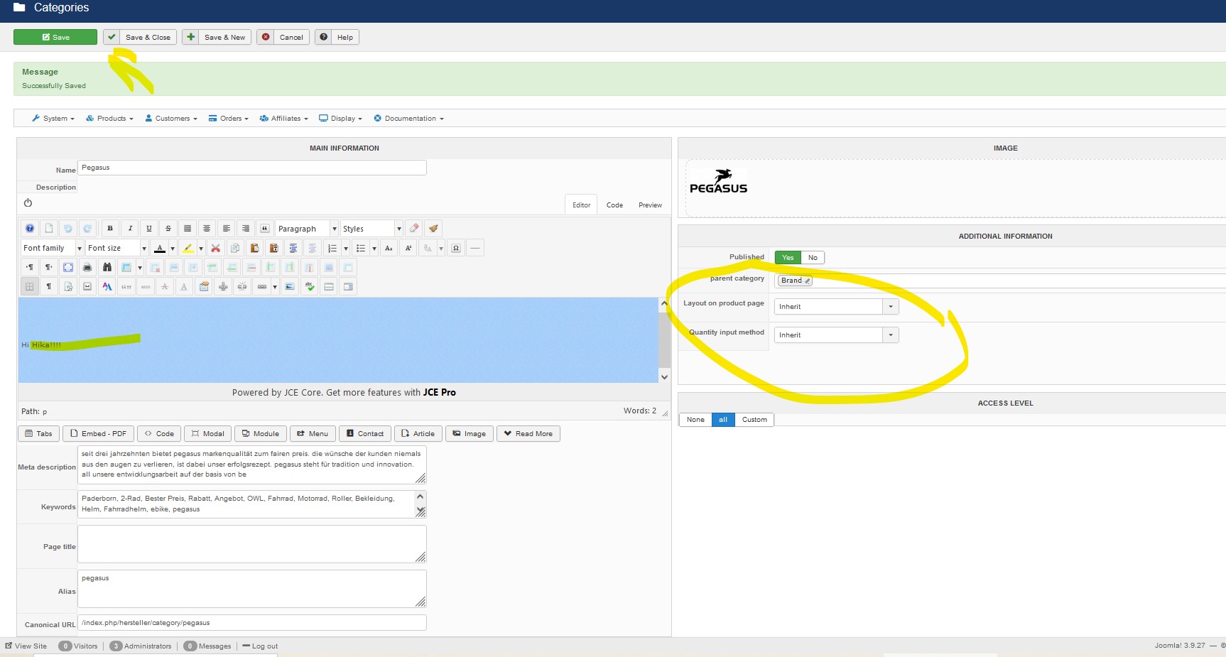

3) Then I just change the description and the safe the entry!!! 2 new fields appears on the screen in the backend
4) In frontend you see the updated description but the products are gone.
Neither Category Rebiuld or the Fixing the DB helps.
I hope that helps to find the issue
Thanks Markus

For some reasons, you had two brands with their "category_type" changed from "manufacturer" to "product" in your database, including this Pegasus brand.
I've modified these brands with a mass action and now it works again.

thanks for your feedback. But none of the category_type changes were done manually. From my point of view - the real problem is that if you safe the brand backend page the category_type will be updated faulty. I again tested with the brand SCOTT. Still the same behaviour. The shop shows all related bikes and after updating the backend all are gone (and I would guess that also the category is set faulty).
