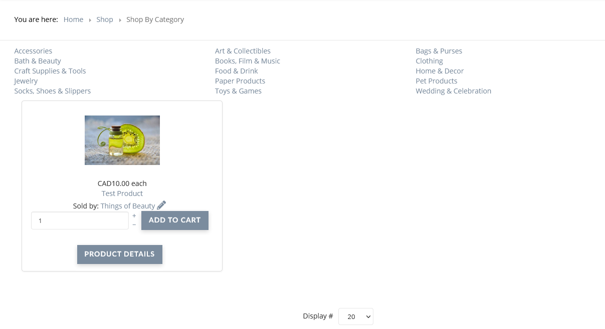

Set up a category page (list) but it's showing products under the category list.
I don't want to show these at all - just the category list on that page. I checked the obvious places (Display, modules etc.) but can't find where to remove this from the page.
Please help!

4 years 11 months ago #333804
Nevermind. Figured it out. Just had to set random items to no.

4 years 11 months ago #333790
Edit your menu item via the Joomla menu manager and make sure that the "sub elements filter" setting, under the "products options" tab, is set to "direct sub elements". If it's set to "all sub elements", you'll get the products linked to the sub categories below the sub categories listing.
If that is already the case and you still see some products below the sub categories listing, it's probably because you directly linked these products to the current category of the page. So in that case, you need to check the "categories" option of these products so that the products are only linked to the sub categories and not the main category.
