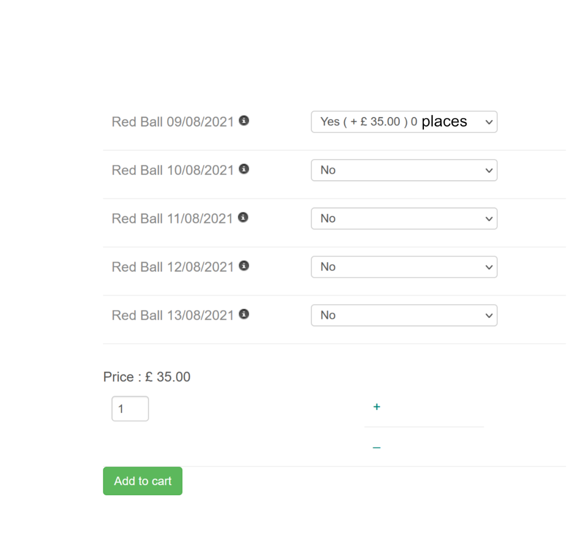

It it possible to show a product option even if it is out of stock?
On this page I wanted the option Red Ball 09/08/2021 to appear in the options list.
tennislife.sheenltsc.co.uk/index.php/sho...d-ball-week-9-13-aug

  • Posts: 3
4 years 10 months ago #334871
Perfect. Thanks.
Would it be possible to add static text next to the stock amount in the dropdown?
4 years 10 months ago #334873
To do it, you'll probably just have to edit the line you previously changed :
$option_values[] = JHTML::_('select.option', $optionElement->product_id, $text. ' '.$optionElement->product_quantity);
And replace it by :
$option_values[] = JHTML::_('select.option', $optionElement->product_id, $text. ' Your_Static_Text'.$optionElement->product_quantity);
Kind regards,
Mohamed.
