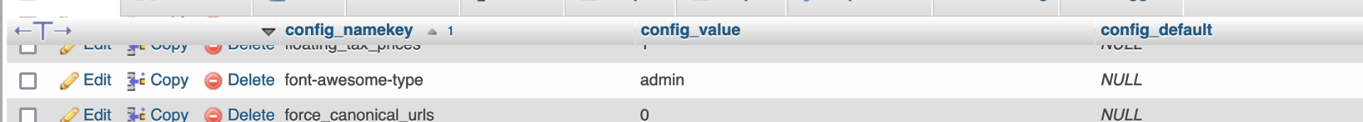

You can't remove it just for the cart module.
You can remove it on the frontend.
To do that, you can add an entry with the namekey font-awesome-type and the value admin in the hikashop_config table via your PHPMyAdmin. That way, font awesome will only be loaded by HikaShop in its backend.
  • Posts: 366
  • Thank you received: 26
4 years 11 months ago #335473
Thanks!
I have made this entry, but there's no difference?
Am I missing something?
  • Posts: 86089
  • Thank you received: 14195
4 years 11 months ago #335478
Make sure you don't have extra space at the end of the namekey or value there or the setting would be ignored.
Also, if you have caching on your website or in your browser, you might need to clear it to be able to see the difference on the frontend.
Besides that, I don't see a reason why it wouldn't work, unless you don't have the 4.4.3 of HikaShop but a 2 years old version of HikaShop.
If that really doesn't work, please provide the URL to a page with the issue so that we can look at it.
  • Posts: 366
4 years 11 months ago #335496
Checked for extra space and cleared ache, but same result.
Please take a look at: new.novame.dk

4 years 11 months ago #335583
So I checked your database and I can see that you have HikaShop's tables three times:
i.imgur.com/AorvVOG.png
And I can see that you've added the font-awesome-type entry only to the first one au2m8x_hikashop_config
Now, since you didn't provide the backend access of the website new.novame.dk/ I'm not sure which one of these tables is used by that website.
Looking at the configuration.php file of the FTP access you provided, I can see that the Joomla website of that FTP website is using the table prefix vsr8v3o_
So I tried adding the ont-awesome-type entry only to the vsr8v3o_hikashop_config table and it seems to have worked. Please confirm.
  • Posts: 366
4 years 11 months ago #335599
Hi Not sure why there were 3 tables, but I have removed the ones not used.
I have cleared my cache and restarted my Mac.
I see the icon in Safari, but still not in FireFox and Chrome. Do you?

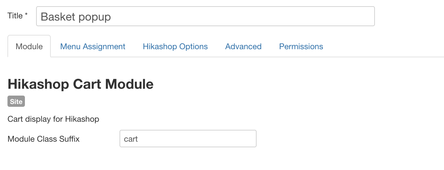

  • Posts: 366
4 years 11 months ago #335675
Thanks!
Can you point me in the direction of the files used for Hika Cart Module?
When I disabled that module, things are working fine - enabled the error appears again, so I will look into the code there :-)
