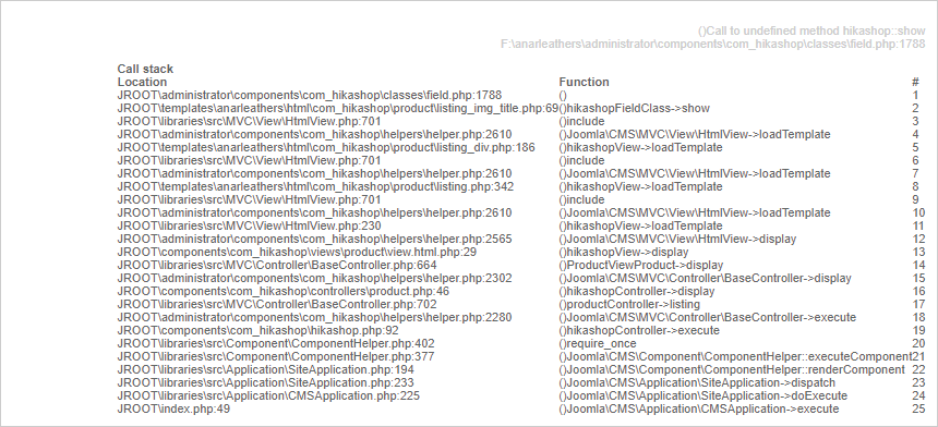

5 years 3 days ago #337357
by khashiz
Replied by khashiz on topic Display Custom Field
I turned on debug system and atached the screenshot :
5 years 3 days ago #337358
by khashiz
That was a kiddy mistake by me ... the code worked perfect. thank you.
