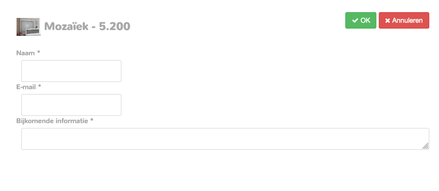

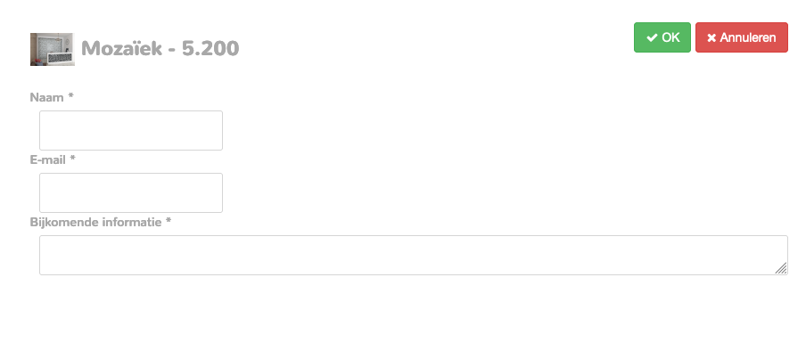

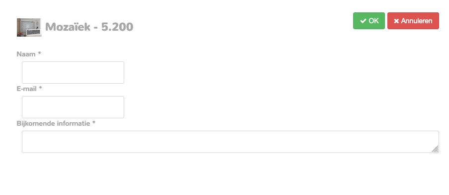

Is it possible to add a link to the product page in the email a shop owner receives when a visitor uses the contact button on that product page. Now it's hard to know about which product an inquiry has been made.

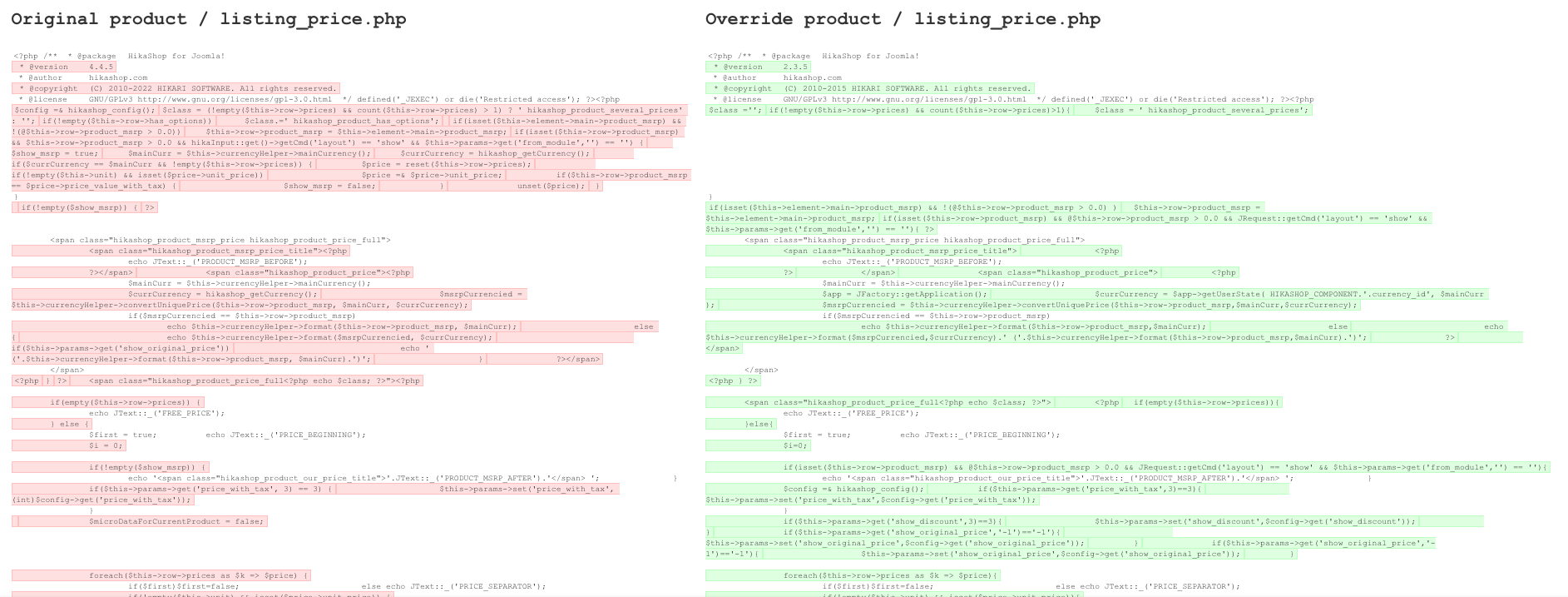

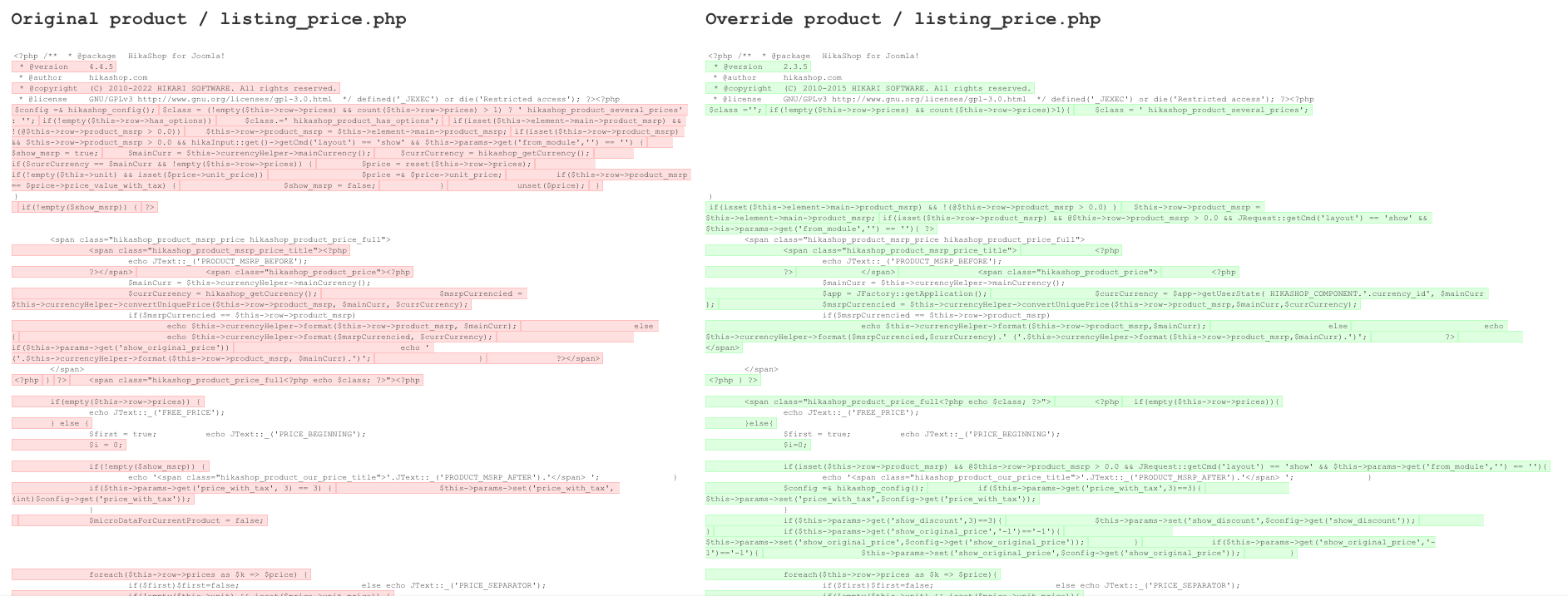

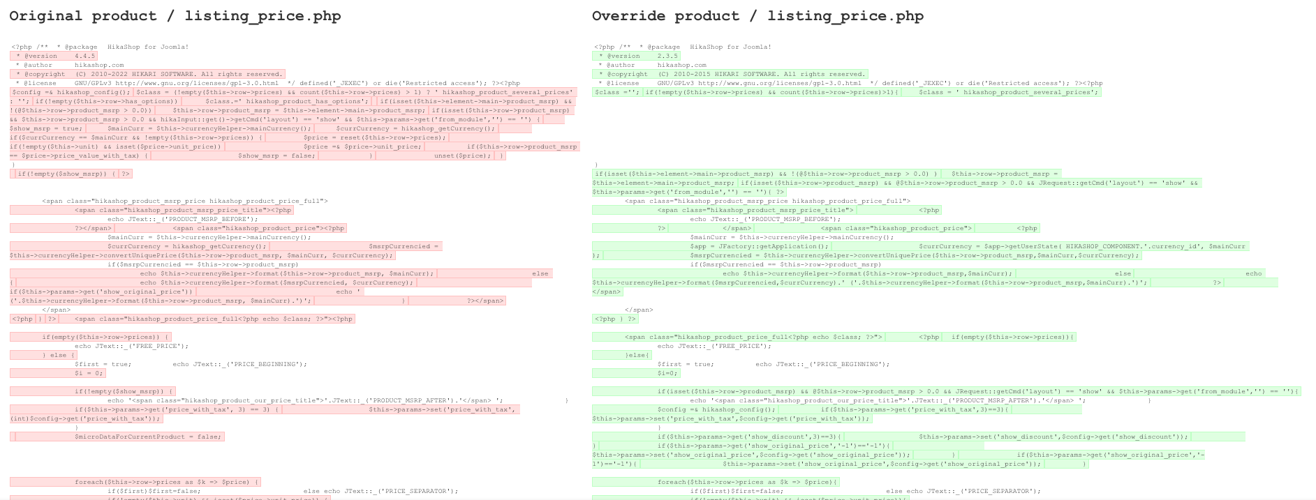

Another question following this one (or better to start a new topic?) -> How to deal with this kind of modifications when updating Hikashop? Is there a way to know if a modification blocks new code added in the update? I see green and red colors when looking at the modification pages, but not sure how to interpret it fully and how to deal with it. See attachment I came across. This is a very old modification and I can't tell any more what has been modified at that time (Hikashop 2.3.5).

What is in red is the code which is in the default current version of the view file that can't be found in your override.
What is in green is the code in your override which can't be found in the default current version of the view.
So you can't know what was modified with this.
You can just know what is different from what is currently in HikaShop.
Also, as you can see if you look closely, most of the things highlighted there are because there are extra spaces, or the formatting of the code is different, but the code itself is actually the same.
But the tool comparing the code doesn't know it.
