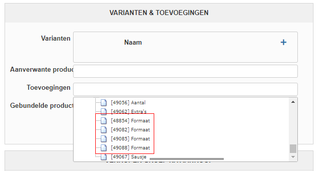

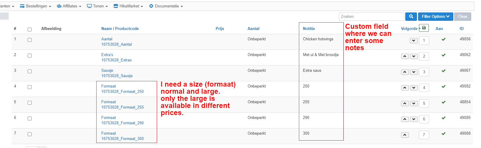

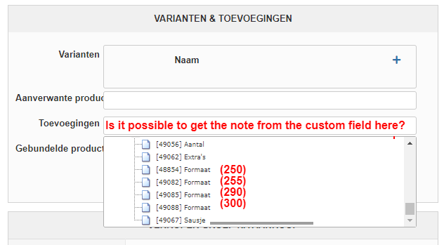

I now have several products on which I hang a size normal and large. Where the additional cost must be stated in the display... so I have to do that with options.
For example:
1. Normal
2. Large (+2.50)

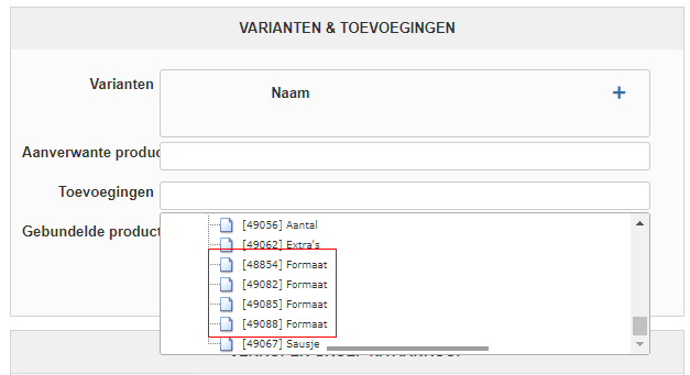

But because I have different prices for the large, I have to create different options. And because the label is "Formaat" everywhere... I don't see any difference when pairing an option!

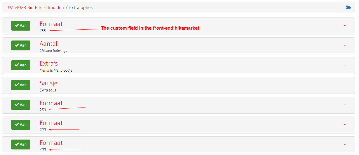

We have already created a custom field that is shown in the backend AND for the verdor is visible on the frontend.
Backend:
Front-end

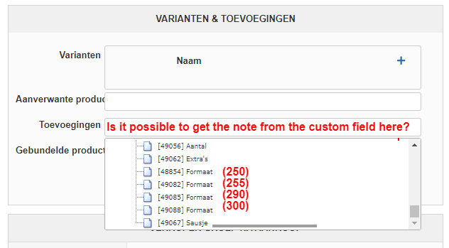

Is there any way we can tell these options with the same label apart? A nice solution would be to show the custom field behind it...
We try to help make Hikashop even better ;) :silly:
Michiel
  • Posts: 86051
  • Thank you received: 14179
4 years 2 months ago #341764
In the file product / form that you can edit via the menu Display>Views, you have this code to display the options selector:
	if(hikashop_acl('product/edit/options')) { ?>
			<dt class="hikashop_product_options"><label for="data_product_options_text"><?php echo JText::_('OPTIONS'); ?></label></dt>
			<dd class="hikashop_product_options"><?php
				if(hikashop_level(1)) {
					echo $this->nameboxType->display(
						'data[product][options]',
						@$this->product->options,
						hikashopNameboxType::NAMEBOX_MULTIPLE,
						'product',
						array(
							'delete' => true,
							'sort' => true,
							'default_text' => '<em>'.JText::_('HIKA_NONE').'</em>',
				} else
					echo hikashop_getUpgradeLink('essential');
			?></dd>
<?php
There, after the line:
try adding the line:
'displayFormat' => '[{product_id}] {product_name} {xxx}',
where xxx is the column name of that Notitie custom field and it should appear in the opions selector.
