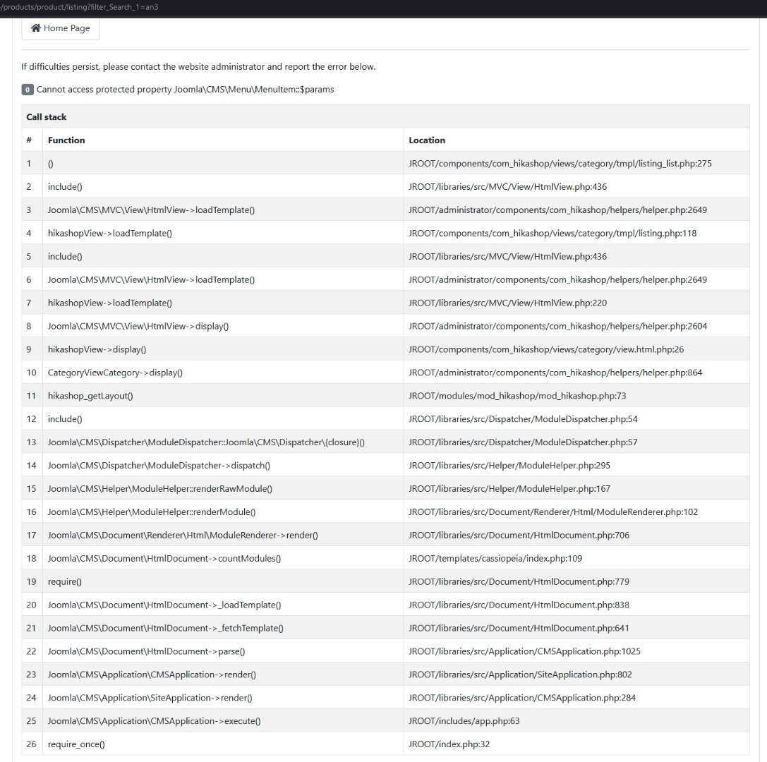

I created a Search filter menu item function per instructions I found on this forum and in the associated documentation. Unfortunately, I'm getting an error upon trying to Search on the front end: "Cannot access protected property Joomla\CMS\Menu\MenuItem::$params"

Thank you. The screenshot of the callstack is great.
This error happens due to a compatibilty issue with Joomla 4 when displaying a categories listing module with a specific set of settings.
In the file components/com_hikashop/views/category/tmpl/listing_list.php try changing the code:
$hkParams = $menuItem->params->get('hk_product',false);
to:
$category_params = $menuItem->getParams();
						$hkParams = $category_params->get('hk_product',false);
That should hopefully fix the error.
