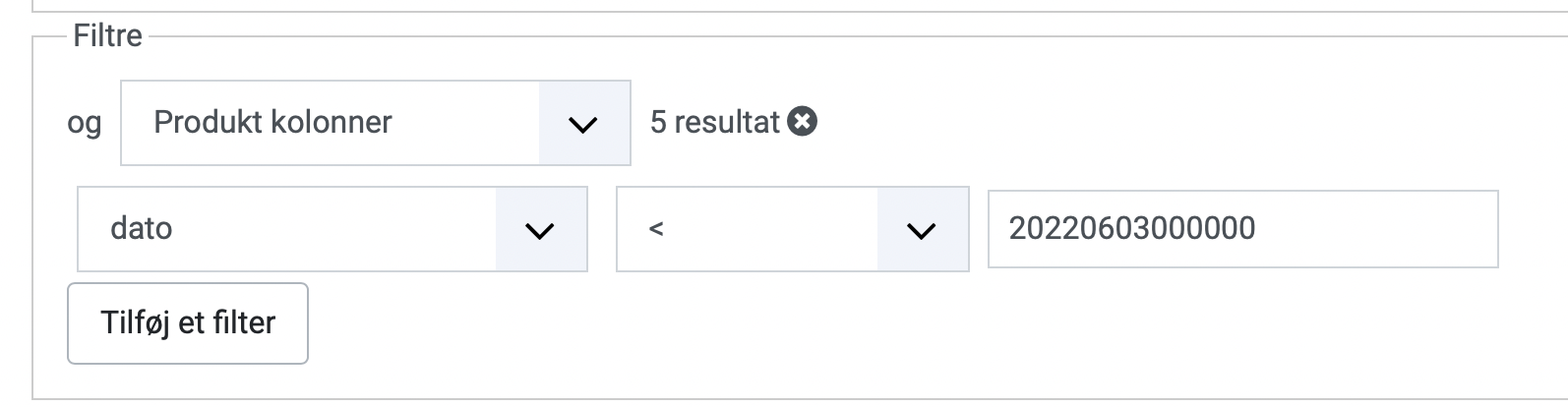

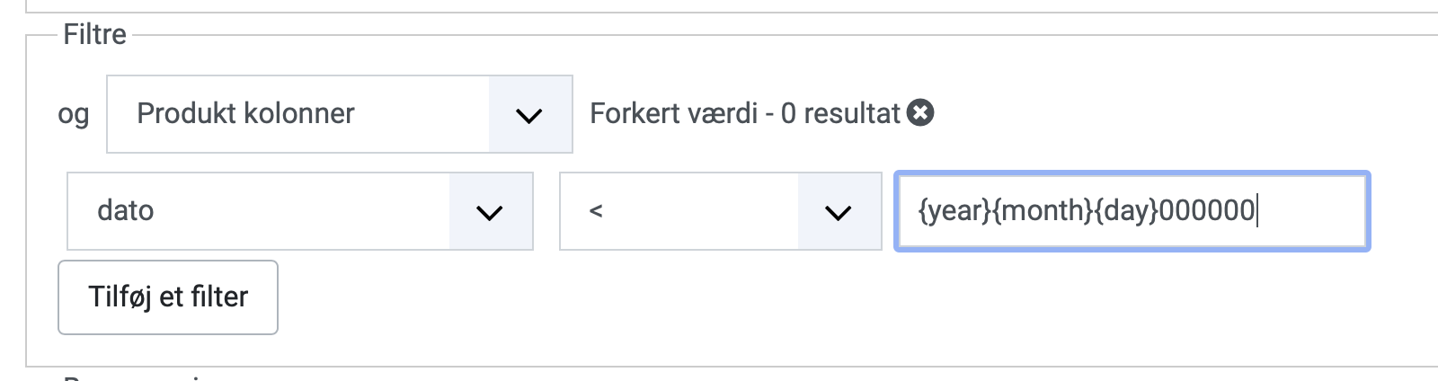

3 years 1 month ago #342133
Thank you. I have tried using your code but I don't get any results. If I manually enter todays date in the same way, I get 5 results. So it seems not to be accepting the tags?

3 years 1 month ago #342142
Indeed, there is a bug with these tags. I was able to reproduce the problem on my end and added a patch for it.
Download again the install package of HikaShop on our website and install it on yours and it will work.

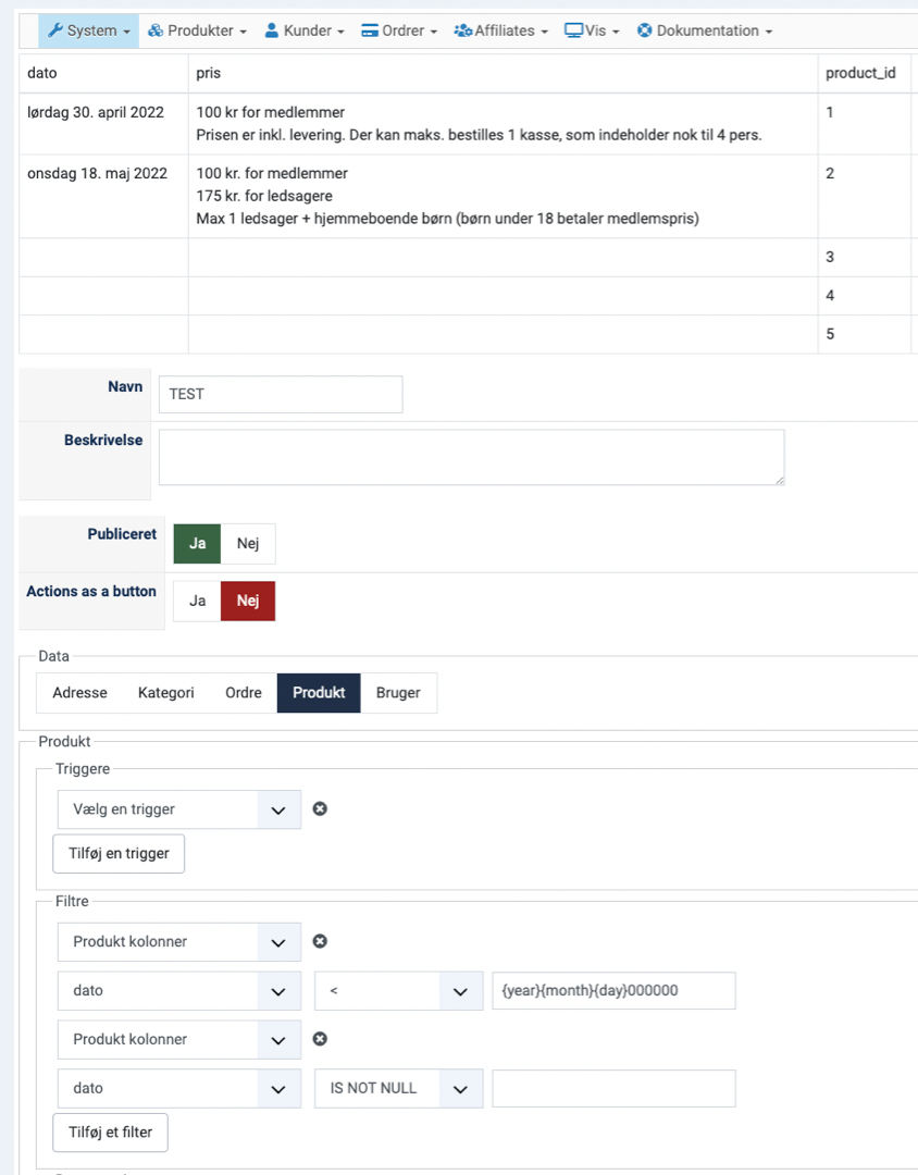

That fixed the issue with the tags indeed. However, I might have found another :-)
If you look at my attached screenshot, you can se I have a filter on Dato(date field) to only display if not null. However, I do get 3 results with no date. So it seems that "IF NOT NULL" is not working?

3 years 1 month ago #342280
In MySQL not null is different from empty.
So the column might be empty but not null.
And thus, you'll want a third filter with "different from empty". You can do so with the operator "!=" and leaving the value field empty.

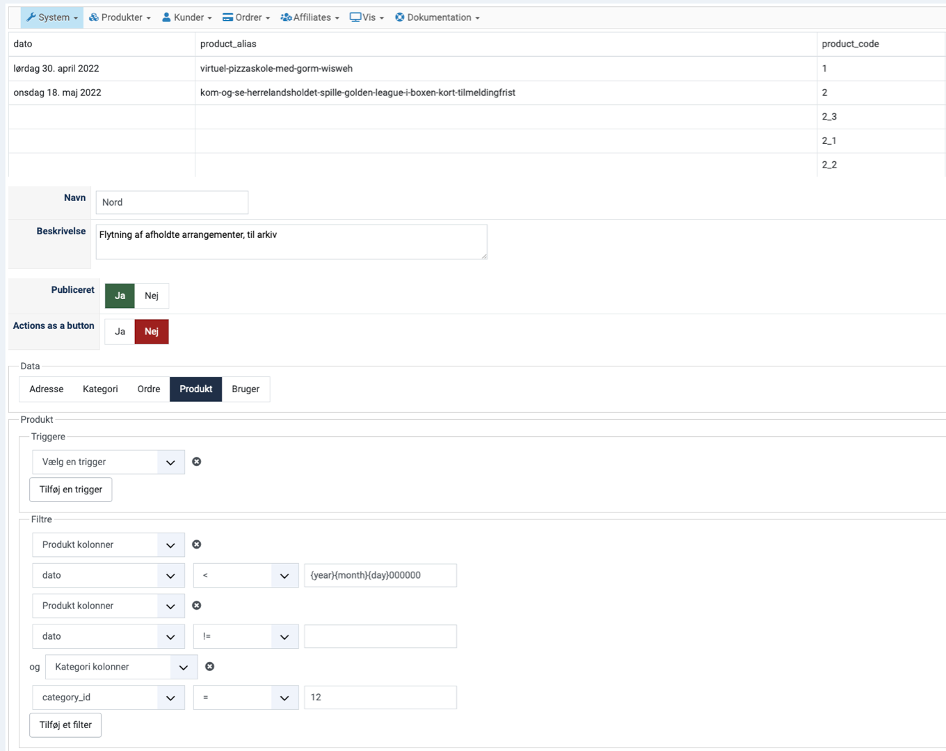

3 years 1 month ago #342291
I've tried that also, but I still get items with no date.

  • Posts: 84079
  • Thank you received: 13632
3 years 1 month ago #342300
Then it means that you have another value in that field for these products. Check the column dato in your table hikashop_product for the 3 products you see with an empty "dato" via your PHPMyAdmin. Maybe they have a value like 00000000 or something ?
