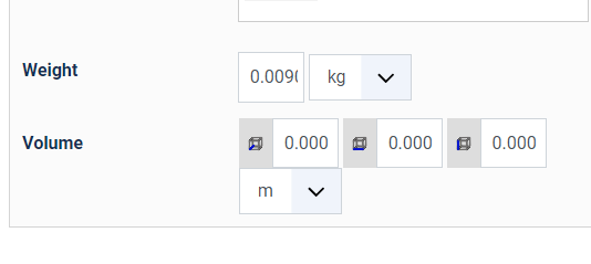

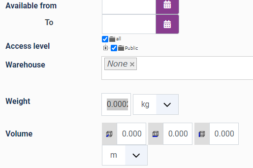

Can I change the decimal place in weights input display in the product restrictions and dimensions.
I products weight very little, but need to be displayed at 0.0018Kgs as per the actual product description from the manufacturers.
If I enter that value 0.0018kgs the system rounds it to 0.002kg

In your PHPMyAdmin, you need to open the table hikashop_product's structure and edit the product_weight column.
There, you need to change the type which is decimal(12,3) to for example decimal(14,5)
And that will allow you two more decimals in weights.
Another solution would be to use grams instead of Kgs. That way you could just enter 1.8 grams as the weight and it would work fine.

In the perfect world, grams would be great, but all the supply is in KGS.
So I am snookered on that front.
But I will do the fix, thank you so much.

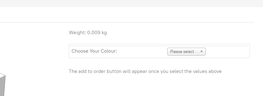

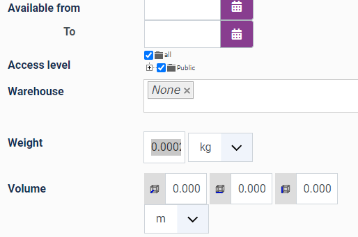

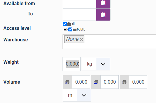

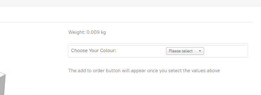

4 years 2 months ago #342234
Have changed the database structure and now stores perfectly.
Only issue on the product page it only display weights that are <=3 decimals.
Anything that has a >=4 decimal place eg. 0.0002 doesnt get shown.
Is there something I need to do in a display setting somewhere?
First product weight is 0.00025, second product is 0.009
MSF
  • Posts: 86051
  • Thank you received: 14179
4 years 2 months ago #342236
In the view file show_block_dimensions (you can edit it via the menu Display>Views), you have this line:
if(isset($this->element->product_weight) && bccomp($this->element->product_weight,0,3)){ ?>
it checks that the weight is greater than 0 to display it on the product page. The "3" in there tells the system to check up to three decimals. So you want to change that to 5.
