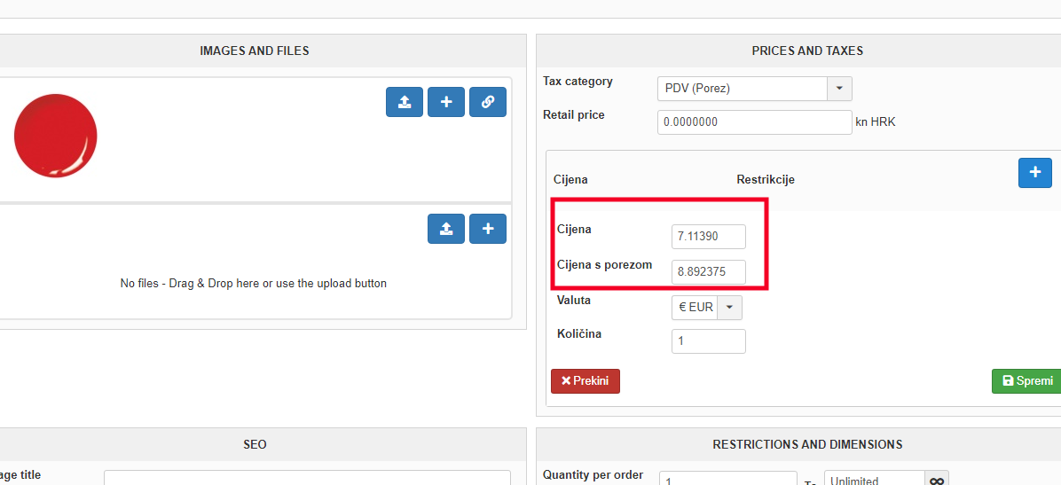

You didn't configure the product prices in EUR as I had explained.
I've done it for one product:
i.imgur.com/RikDrCq.png
And you can see you now have the price in both EUR and HRK on the frontend:
i.imgur.com/AduhyZP.png
And on the checkout, you only have the HRK price.
So you just need to update the prices like I did for this product.
Last edit: 3 years 11 months ago by nicolas.

nicolas wrote: Hi,
