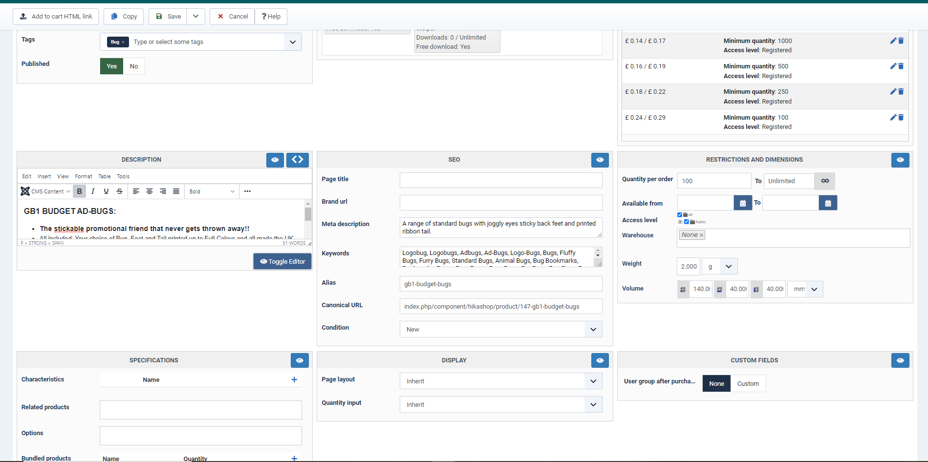

-- HikaShop version -- : 4.6.1 business
-- Joomla version -- : 4.2.2
-- PHP version -- : 8.1.0

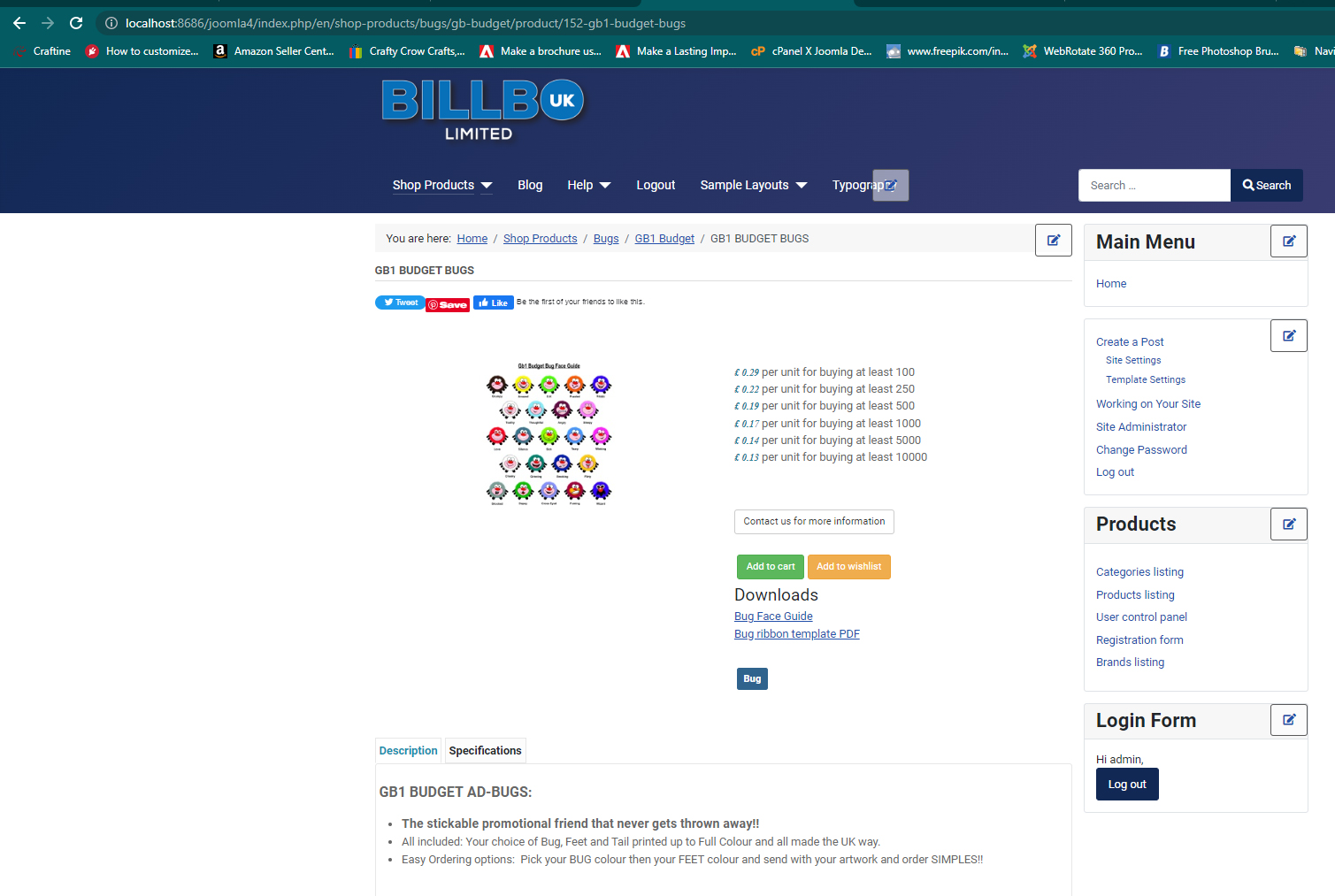

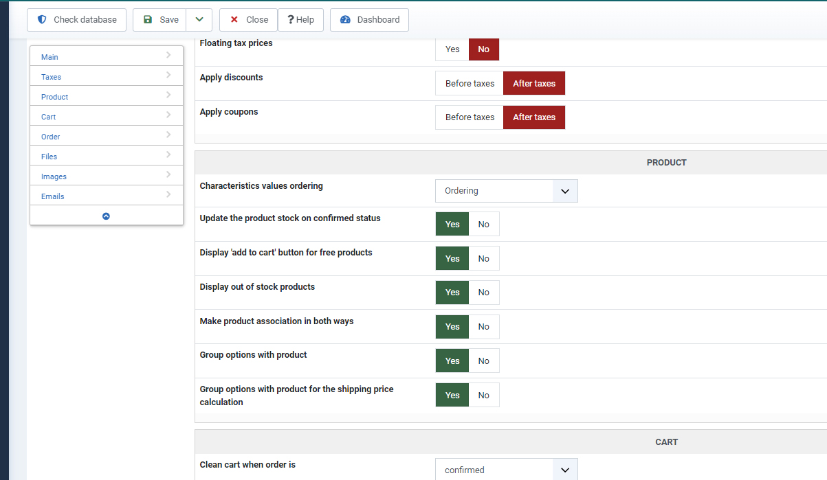

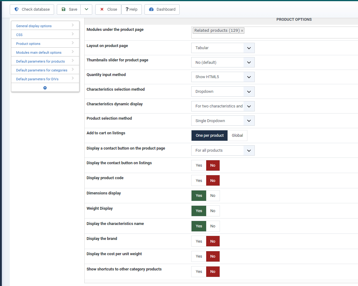

I have just started to rebuild my website on my pc ( localhost ) with a fresh install of Joomla and Hikashop Business.
I have added my first product but cant get the qty box to appear on the front screen.
I have attached screen shots of the settings from the backend and a screen shot of the product page.
I have used the same settings from my live site ( using older joomla 3 and old Hikabusiness) but still not displaying.

3 years 10 months ago #344908
The settings on your screenshots look good.
There is one thing I can think of besides all this:
In each category, you also have a "quantity input method" which will override the "quantity input method" setting of the HikaShop configuration for the products of the category. This can be overridden by the "quantity input" setting of the product itself, but since you set that one to "inherit", it will use the input method from the categories of the product and if they are all set to "inherit", it will use the one from the configuration. So I'm suspecting you might have set that setting to "none" in the category(ies).
And supposing that's the case, you probably did that because you wanted to remove the quantity input from the listings of the products of that category. But what you should have done instead is to change the settings of the menu item / module to turn off the "show quantity input" setting.

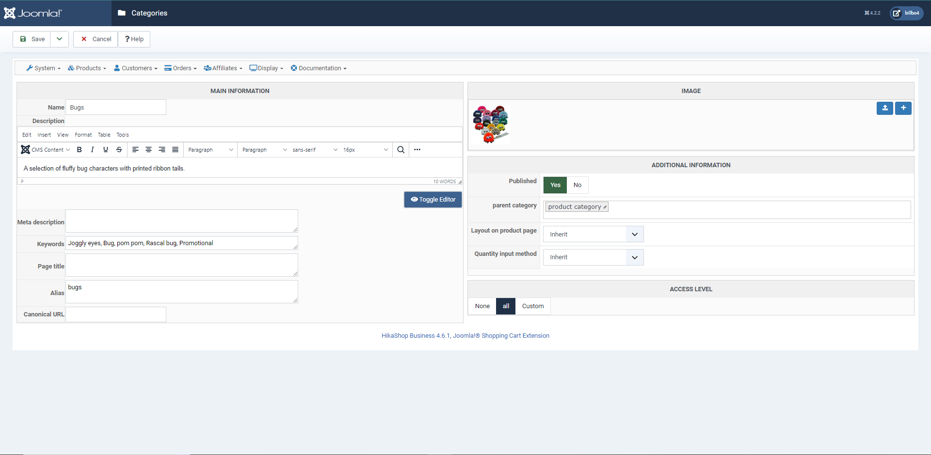

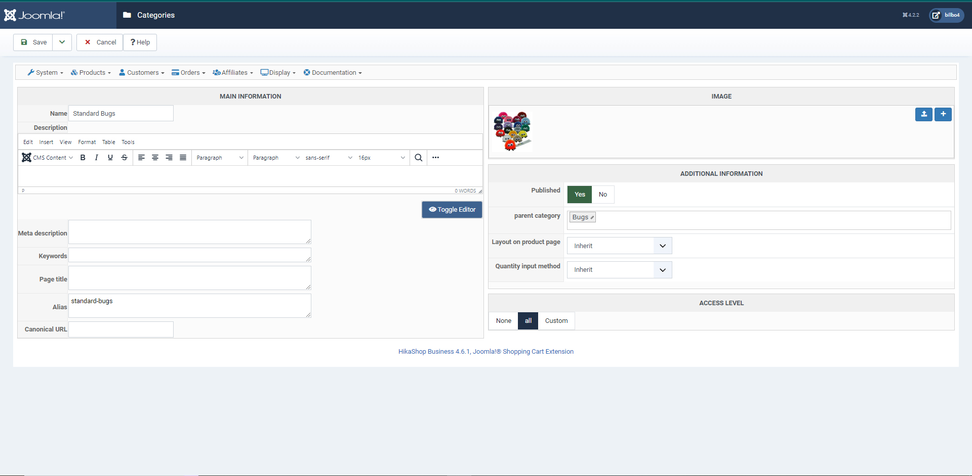

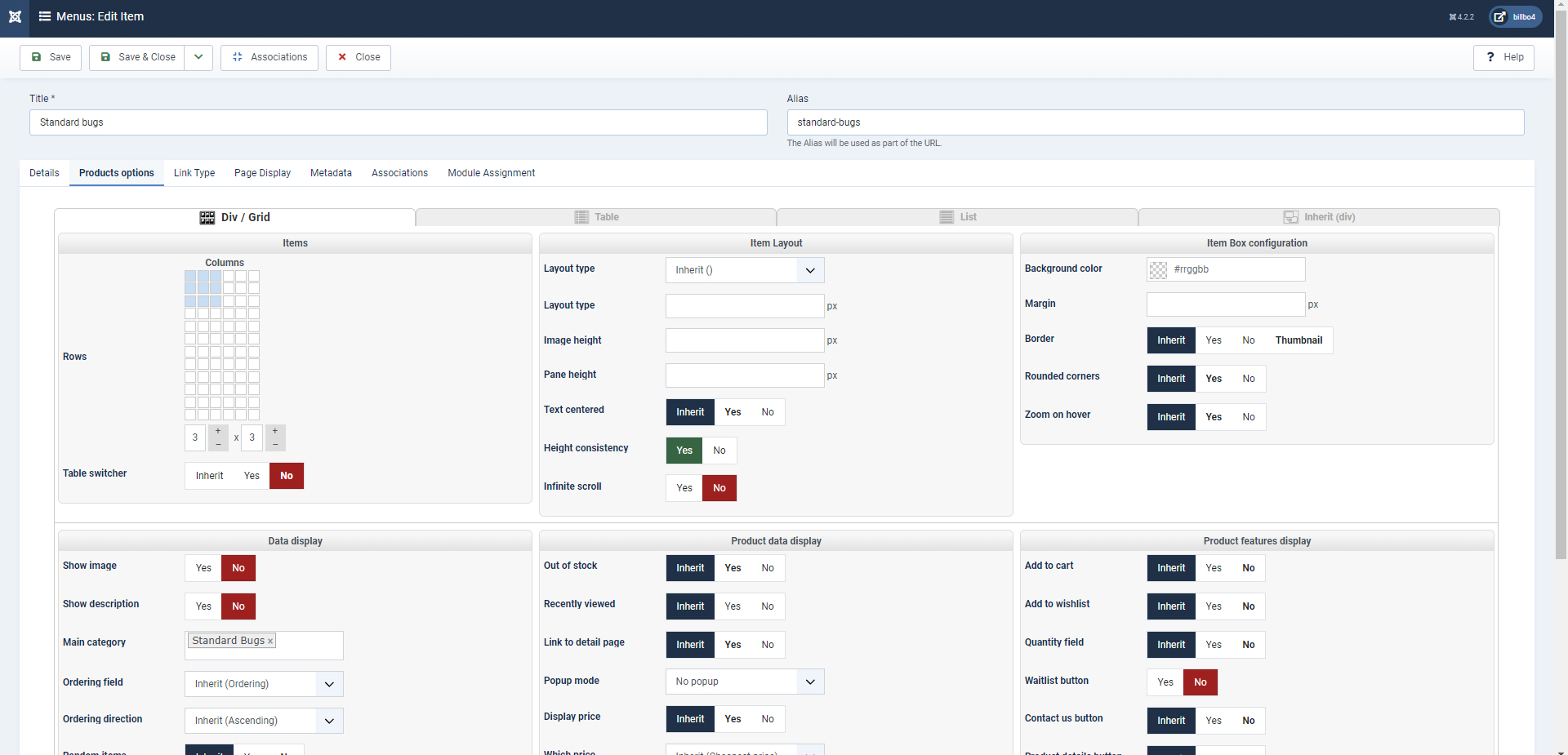

  • Posts: 50
3 years 10 months ago #344937
I have checked the settings in the menus and also categories ( see attached )
but still cant get the qty box to appear.

  • Posts: 86051
  • Thank you received: 14179
3 years 10 months ago #344940
From what I can see on the screenshot www.hikashop.com/media/kunena/attachments/11886/Billbo-3.jpg the category linked to the product is the category with the name "GB1 Budget". So you should check the "Quantity input method" setting of that category.
Also, if the product is in multiple categories (the categories setting of the product was not on your screenshots so I don't know), then you should check the other categories too.
If you could put your website online and provide a backend access, we could have a look at it directly.

All the categories are set to inherit on the qty input method.
If I wanted the qty box set as default for all products where would I set this.
I will look at setting up a temp site online as my old site is still running joomla3 so will let you know the details
