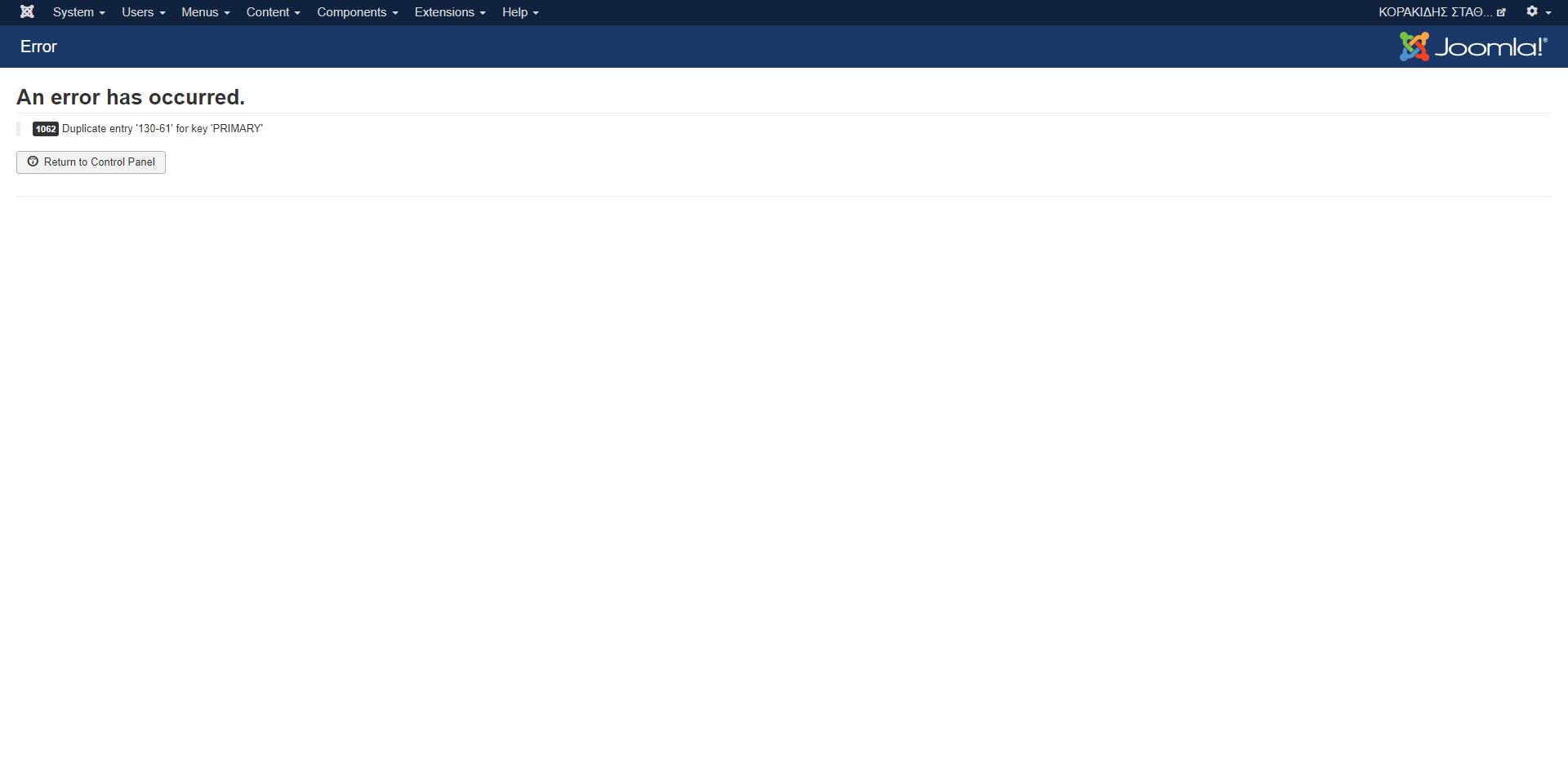

Hello!
For some reason i can't save a product, i get this message:
An error has occurred.
1062 Duplicate entry '130-61' for key 'PRIMARY'
Return to Control Panel
Thank you

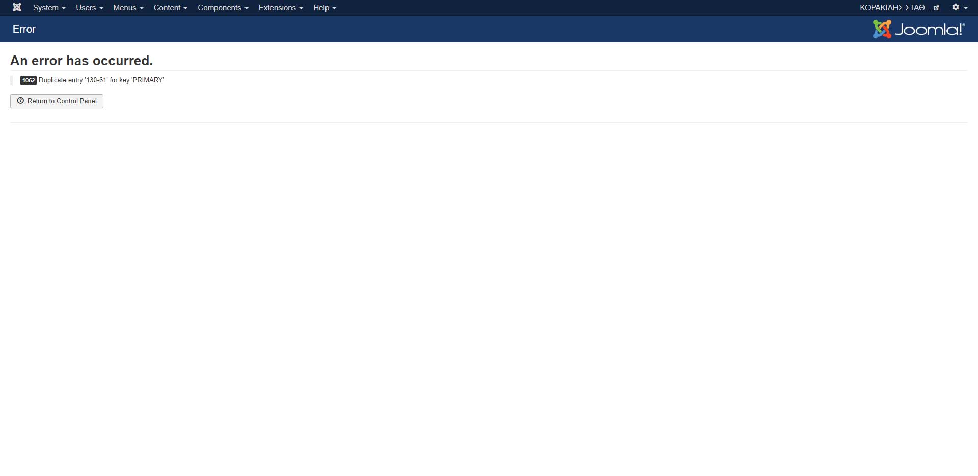

3 years 10 months ago #345227
Hello !
  • Posts: 86051
  • Thank you received: 14179
3 years 10 months ago #345231
Based on the error message and the callstack you have the same error as here:
forum.joomla.org/viewtopic.php?f=712&t=991541
This happens during the saving of a product because you have the Smart Search HikaShop plugin enabled.
So there are three things you can do:
- deactivate that plugin. If you don't use the smart search, you don't need it.
- Try reindexing all the data in the smart search component.
- The thread on the Joomla forum mentions that the issue came from the database caching for the person with the issue. So if you have such a mechanism in place, I would recommend looking into it.
