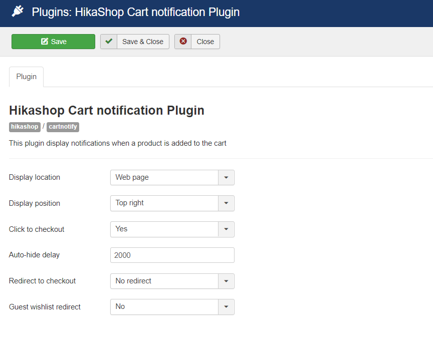

3 years 10 months ago #347179
by jiawen
Replied by jiawen on topic Add to cart redirect
Hikashop cart notification has turned on and applied with the webpage option.

3 years 10 months ago #347183
by nicolas
Replied by nicolas on topic Add to cart redirect
From what I can see on your link, the issue is that you've activated the redirect on success setting of the HikaShop cart notification plugin.
Turn that setting off and it will stay on the same page.
3 years 10 months ago #347190
by jiawen
