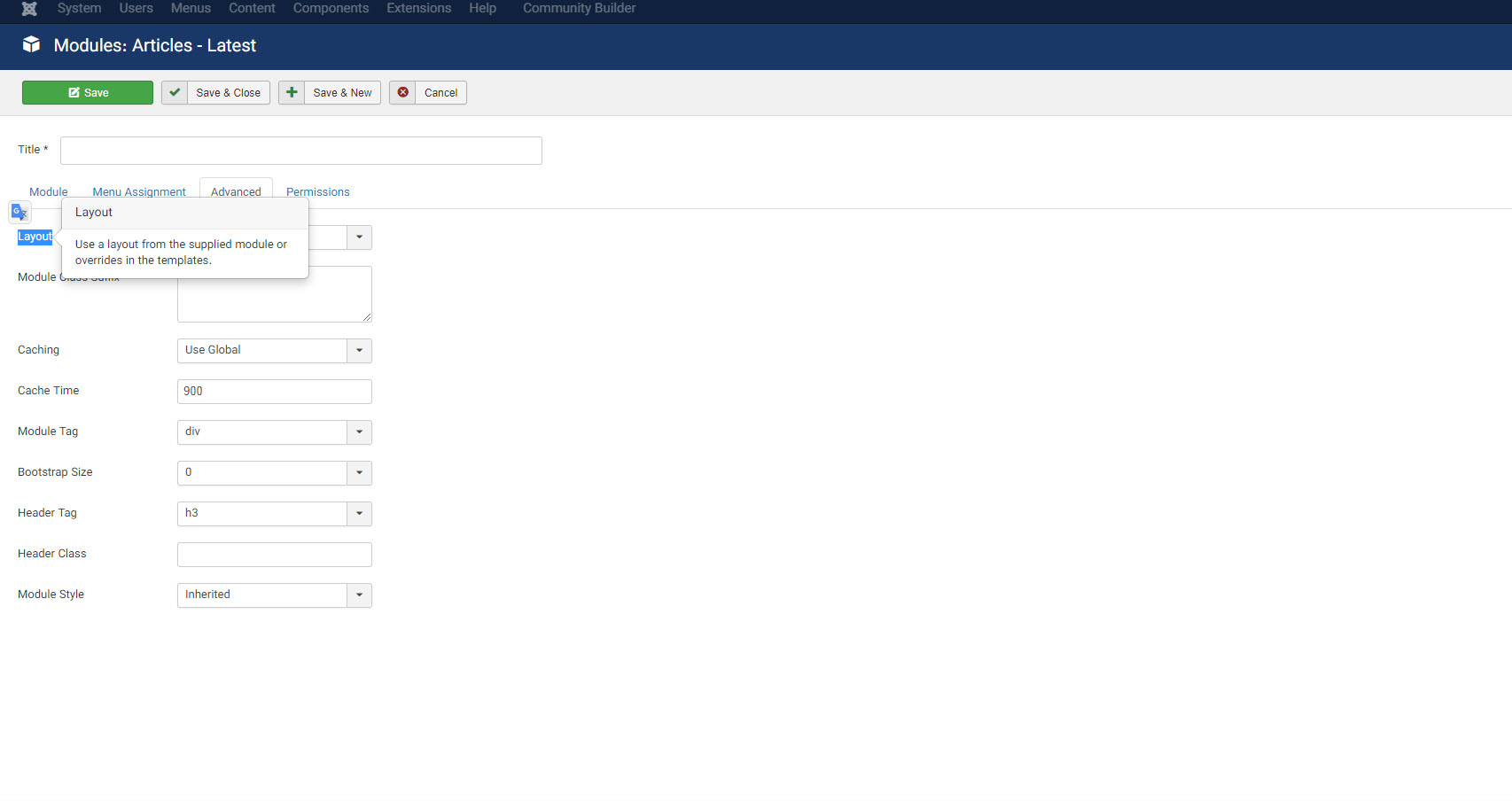

3 years 8 months ago #347451
hello
please forget mighty site and see this image: (it is from default joomla latest article module.)
with this field i can select any existing layout for each module to show different view for each module that show latest article. i want something similar this default field for each cart module in my different menu item.
