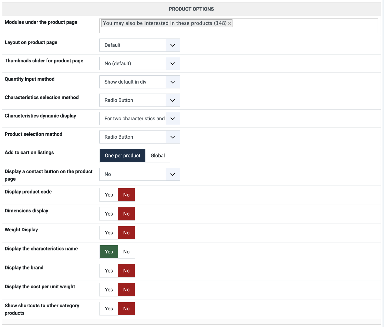

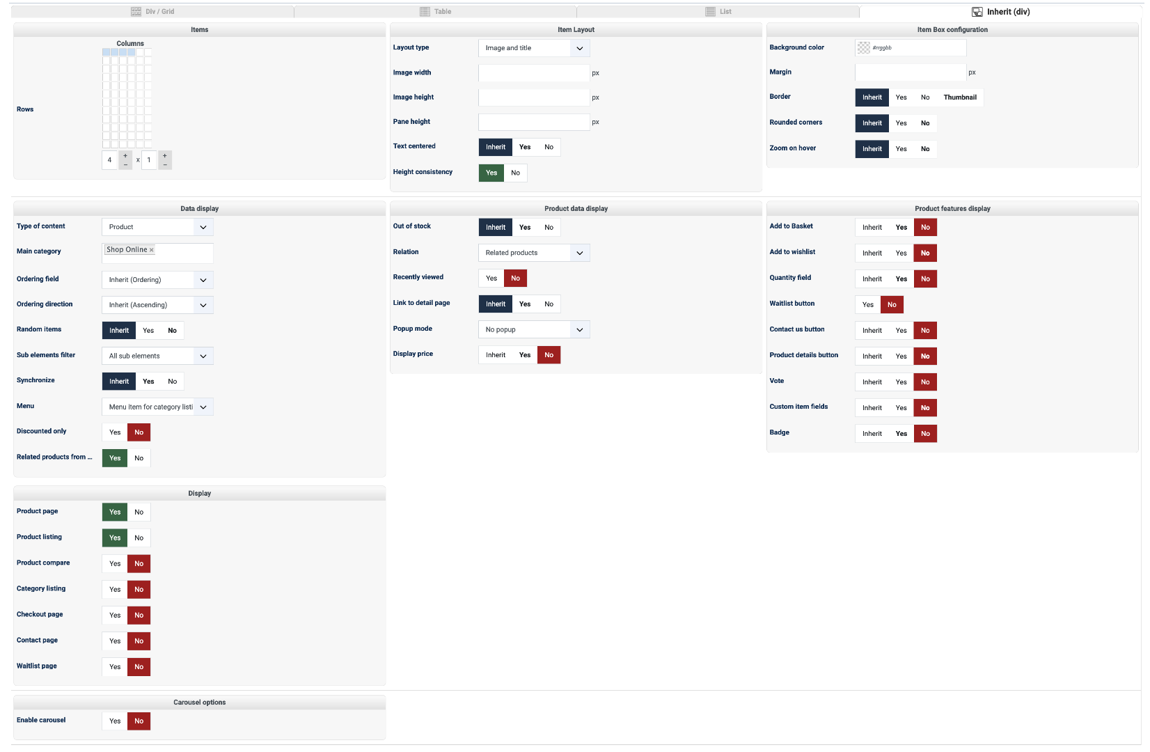

Could you provide a screenshot of the settings under the "HikaShop options" tab of the settings of the module in the Joomla modules manager and a screenshot of the "modules under the product page" setting of the HikaShop configuration ?
  • Posts: 237
  • Thank you received: 5
3 years 8 months ago #347520
Nicolas,
Here you go. Would a login help?
  • Posts: 86051
  • Thank you received: 14178
3 years 8 months ago #347521
You need to turn off the "related products from..." setting in the module.
With this setting activated, the module will filter out the products to only display the ones related to the products already in the current cart.
