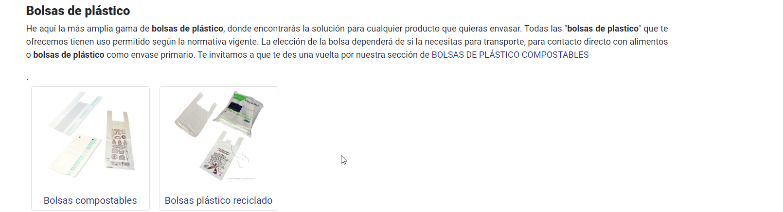

I tell you what I have done.
Within the general category of plastic bags I have created two subcategories (recycled and compostable).
I want it to show the description of the category or a text that I can configure above each image in the category.
I'll give you screenshots of my configuration and how it is displayed on the web.
  • Posts: 86050
  • Thank you received: 14178
3 years 2 months ago #352169
You want to change the type of your menu item from "category listing" to "product listing". Then, with the "sub element filter" setting set to "grouped by category", you'll get something closer to what you want.
Then, you'll just need a view override on product / listing to add the category description below the category name. That's quite easy to do, by adding the code:
<div class="subcategory_description"><?php echo $category['category']->category_description; ?></div>
after the code:
<h2><?php echo $category['category']->category_name; ?></h2>
