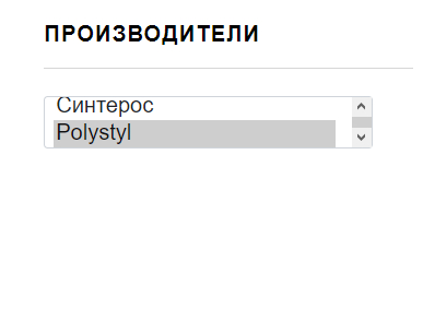

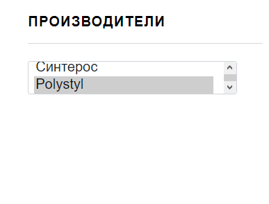

  • Posts: 220
  • Thank you received: 10
2 years 10 months ago #353761
Hello. Could you help? So that the multiple list is displayed correctly. If you include it in the filters, it looks like this:
