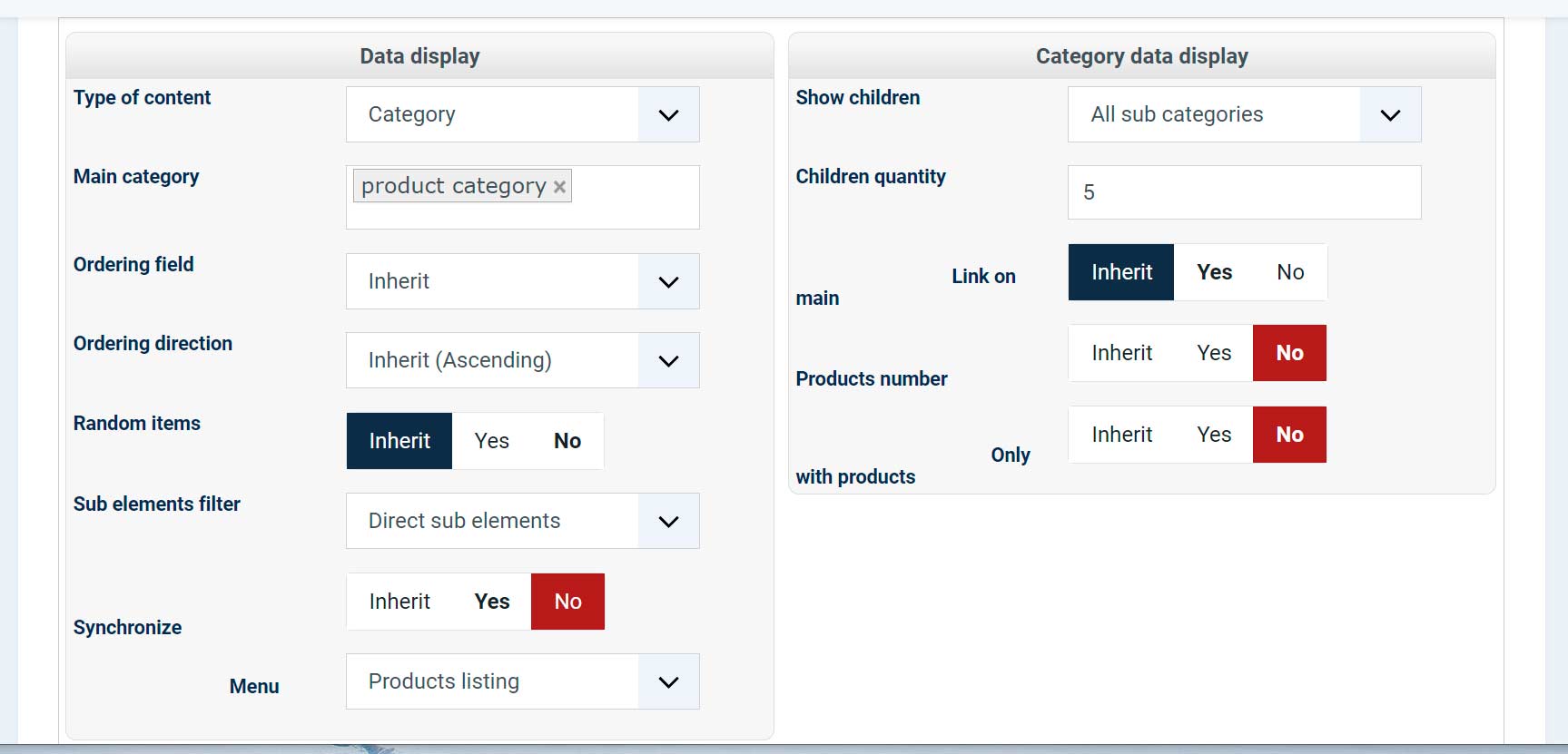

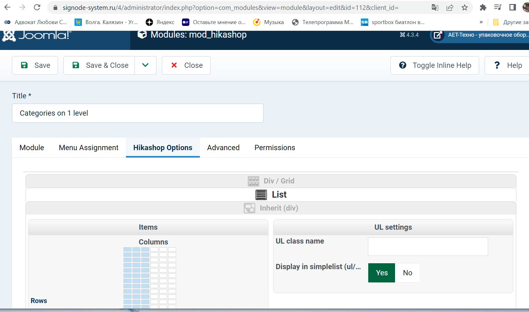

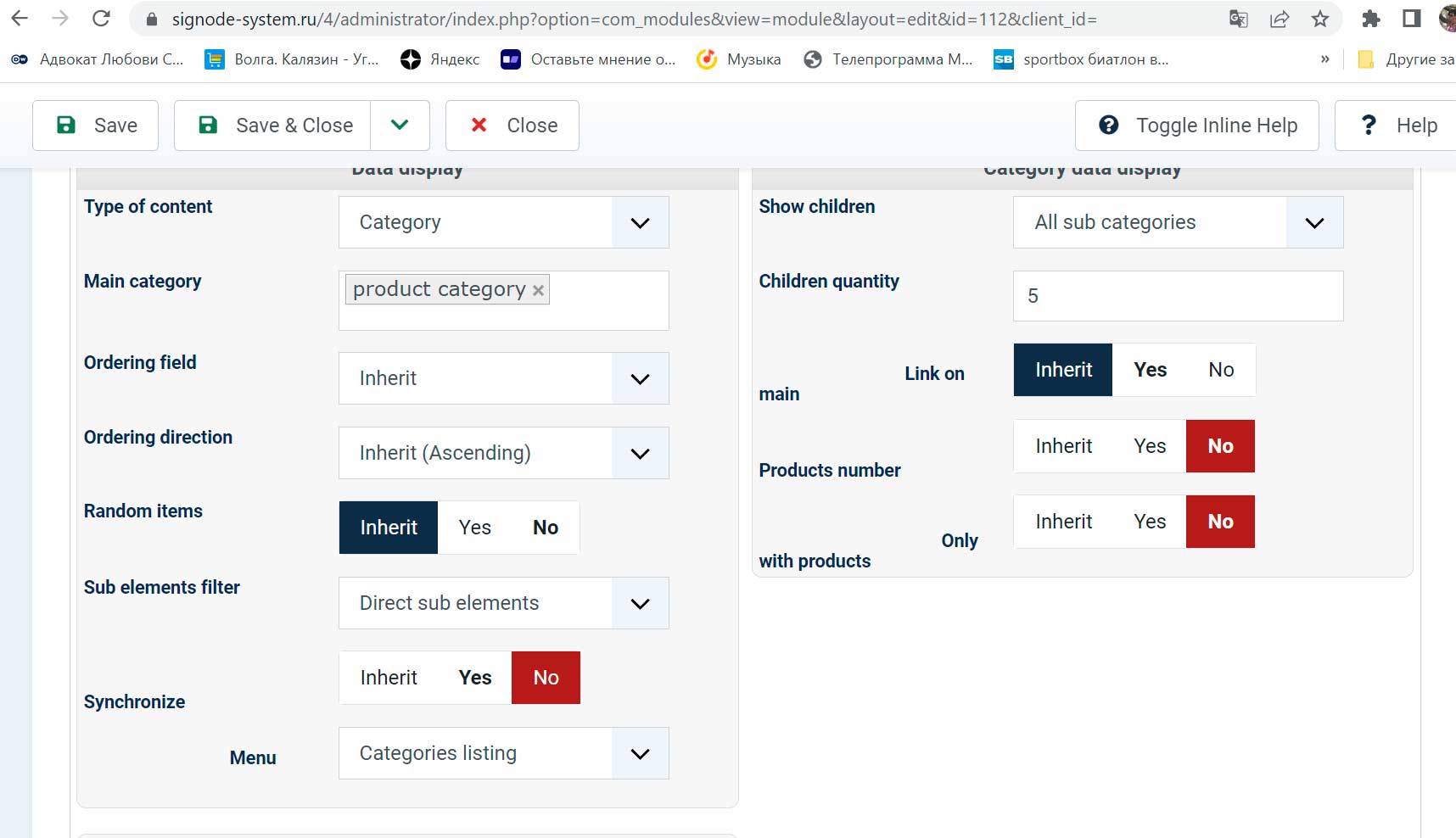

1. Do you mean it - see screenshots 1 and 2? As you can see, synchronization is disabled, but nothing has changed - only titles are displayed on the subcategory pages. Or something else you had in mind?

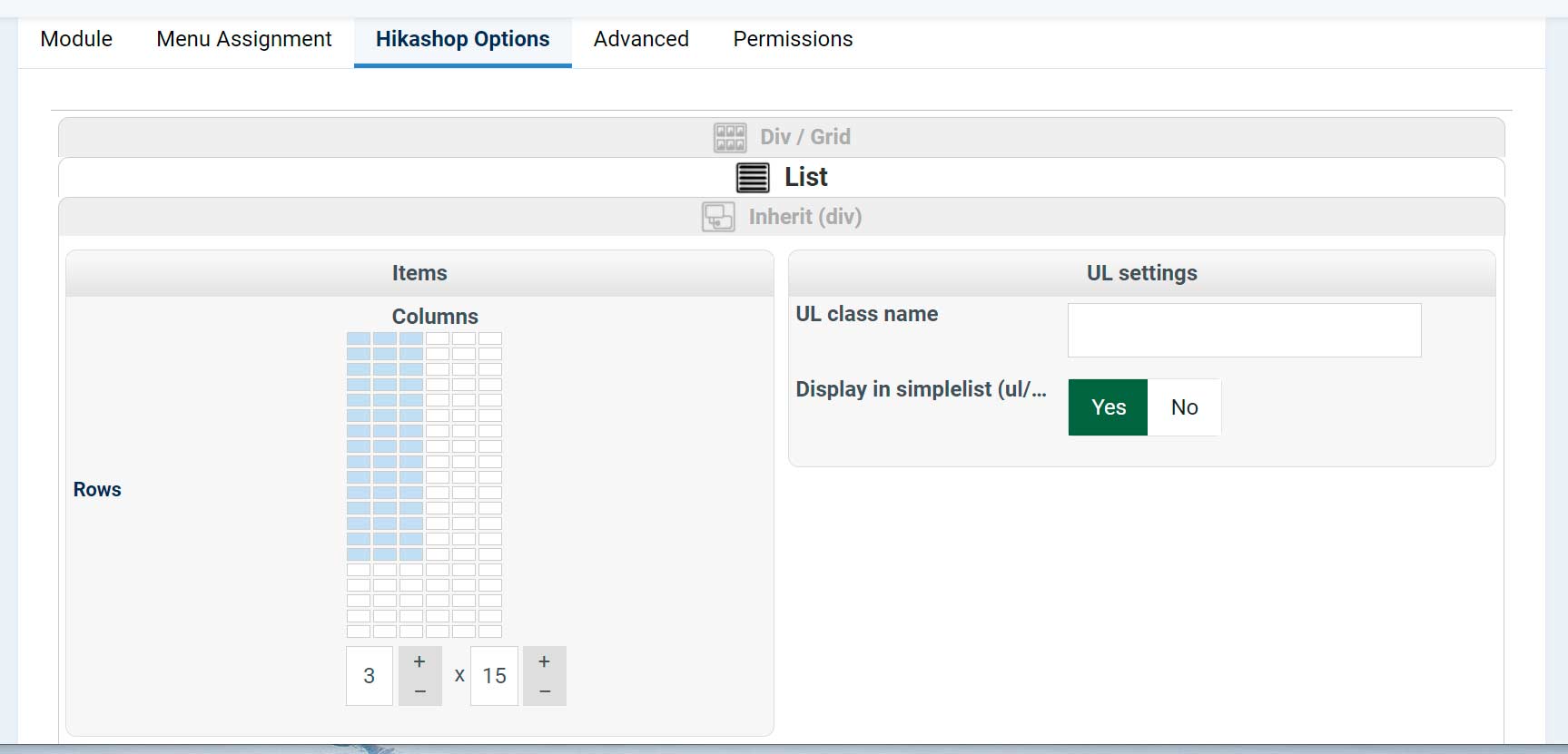

1. Could you provide screenshots for all the settings under the HikaShop options tab of the module ?
2. As I said in my point 3 in my previous message, you need to select "produktsiya" in the "menu" setting.
I can see you didn't do it on your second screenshot.

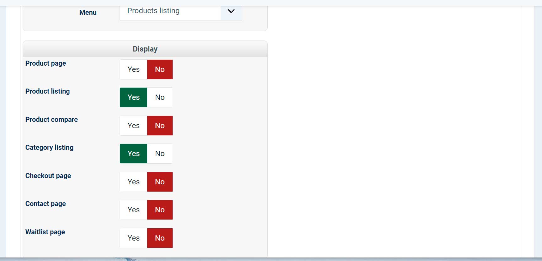

  • Posts: 13
2 years 11 months ago #354966
Hi, Nicolas!
1. When I took screenshots, I saw the Display settings at the bottom. They were all disabled. I have enabled the Product listing and Category listing options. It became much better, but! Now, when opening pages from the module, descriptions are everywhere, but there are no subcategories. At the same time, when opening from the main horizontal menu, there are subdirectories.

  • Posts: 86050
  • Thank you received: 14178
2 years 11 months ago #354968
No worries, but "products listing" is still not the one you need to select there. It's "Продукция" you need to select, the menu item with the alias "produktsiya". The "products listing" menu item is the one with the alias "hikashop-menu-for-products-listing"
And that's why you get URLs with "hikashop-menu-for-products-listing" instead of the URLs you want.
Once you get the URLs you want, you'll also have the display you want when you click on the categories of the module.

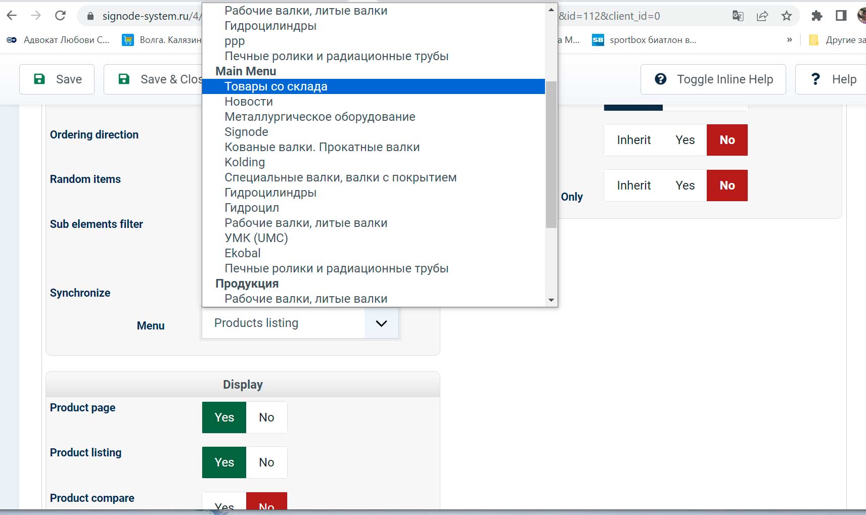

2 years 11 months ago #354986
Hi, Nikolas! Thank you for your help to me!
Do you mean this menu - see screenshot?
This menu is not formed correctly. There is no "Products" item in it. There is a name for a separate menu “Products”, but this name is not clickable.
Here is the first level of the main menu:
home
About company
Products
News
Contacts
Of these, in the main menu generated by the module, there is only News, which is why I cannot select the Products item.
How is this menu formed, can I reformat it?
