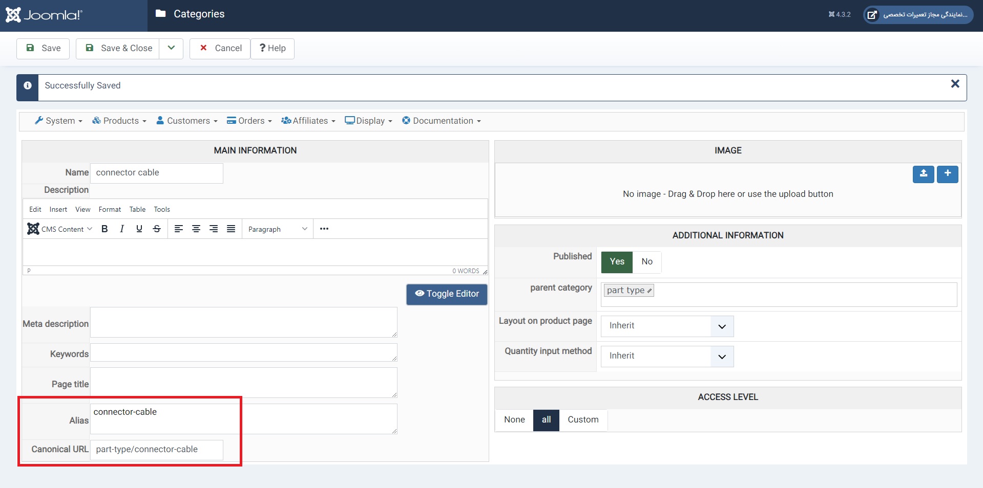

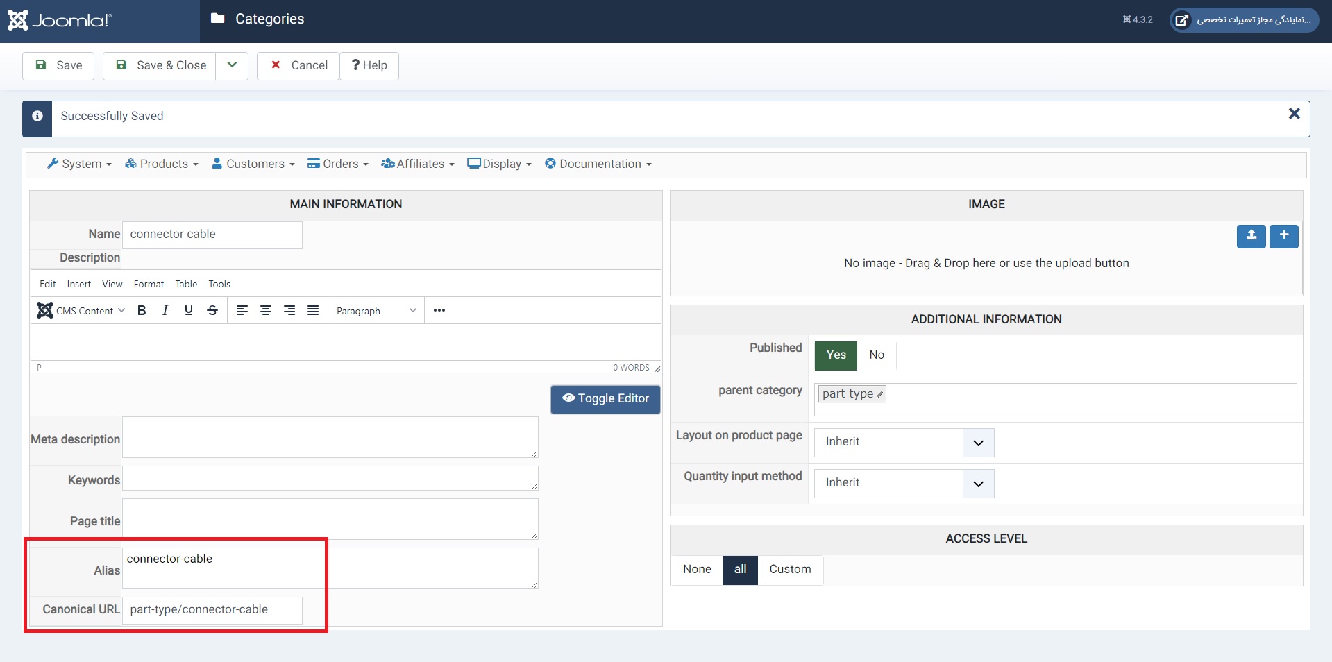

Aliases for categories are dashes in all two-word names, so I don't think the problem is with aliases. A screenshot of the category alias and canonical fields is shown below:
I also noticed that in order for the canonical link to work properly for these categories, I use %20 instead of dashes in the canonical field. It seems that instead of the alias field, you are using the product title field to create the page link.
Life is the unique stage of our art. Everyone sings their own song and leaves the stage. The stage is always permanent. Blessed is that song that people remember.

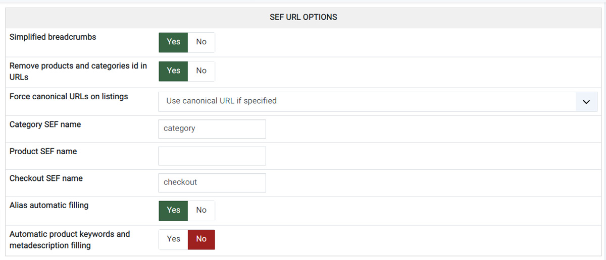

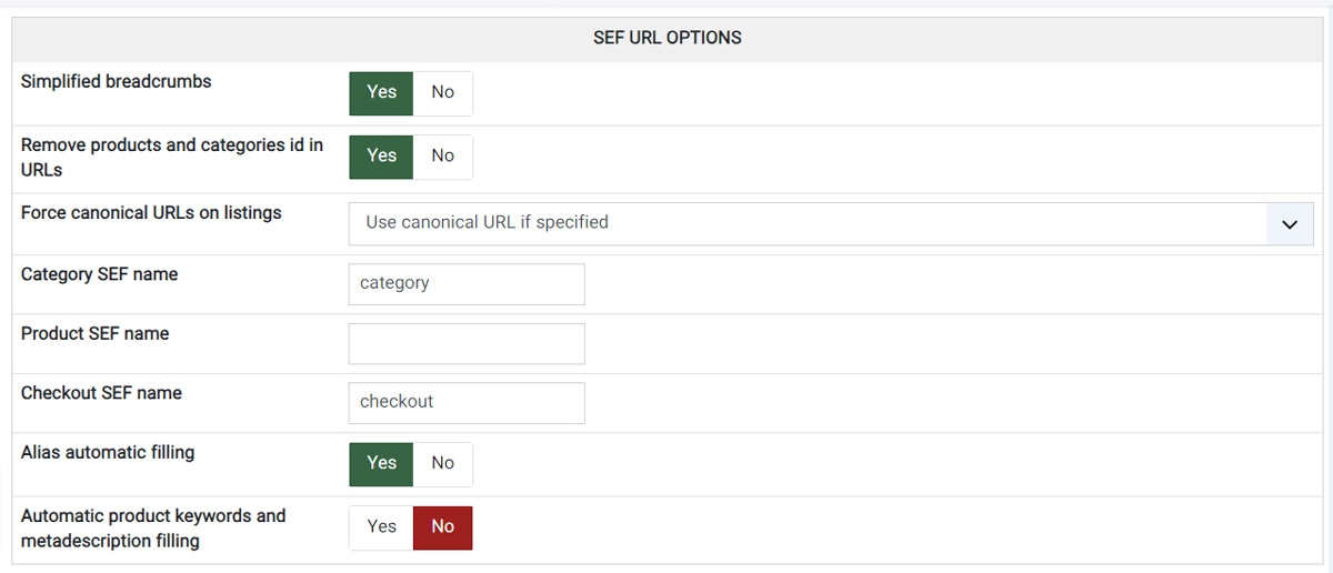

2 years 11 months ago #354984
You are right. There is nothing wrong with a alias.
The problem is that I don't want "category" to be included in my category URL.
As you can see in the figure below, in the Hikashop SEO settings, I have left the product SEO feed empty so that the word "product" is not displayed in the link of my products.
But Hikashop does not accept that the category field remains empty:
you can't have the same SEF name for product and category.
  • Posts: 86101
  • Thank you received: 14203
2 years 11 months ago #355009
Indeed. You need to fill in at least one of the two.
That's how HikaShop is able to know if your URL is for a product or a category.
If you don't want to have "category" in the URL, you can use some other text. But you need to have something.
