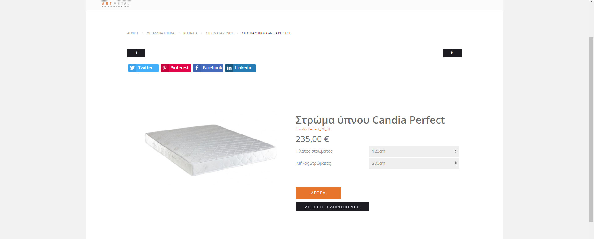

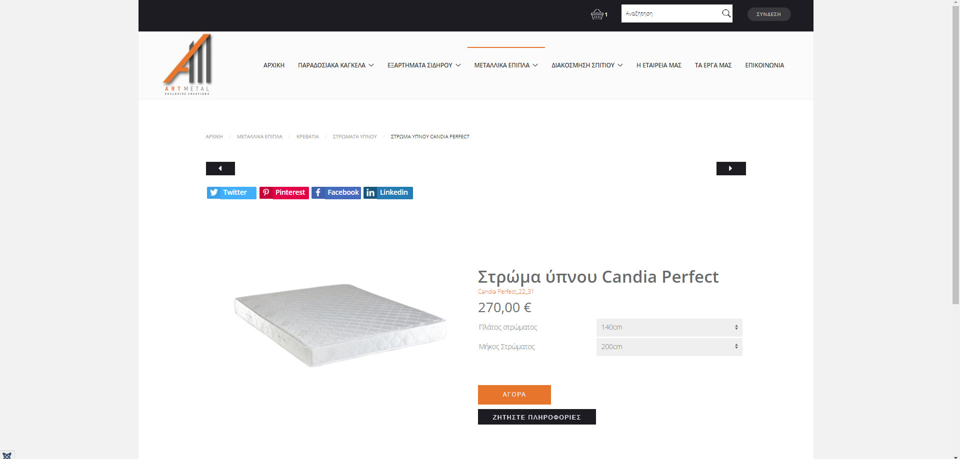

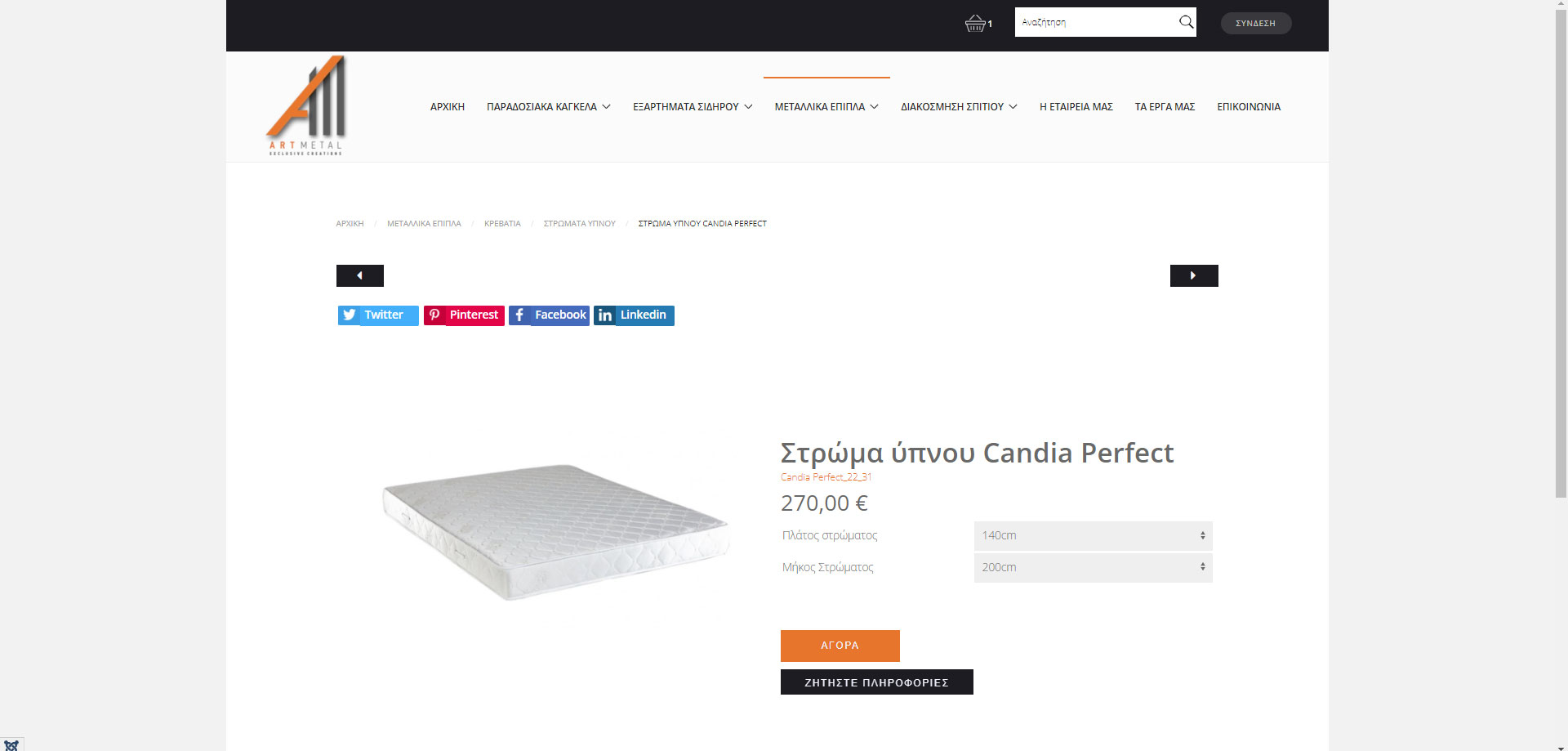

Hello!
I noticed that, when i select 2 characteristics in a product and then add the product to cart, if i go back from the checkout page, the price is wrong.
Thank you

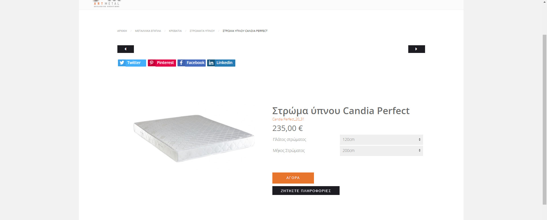

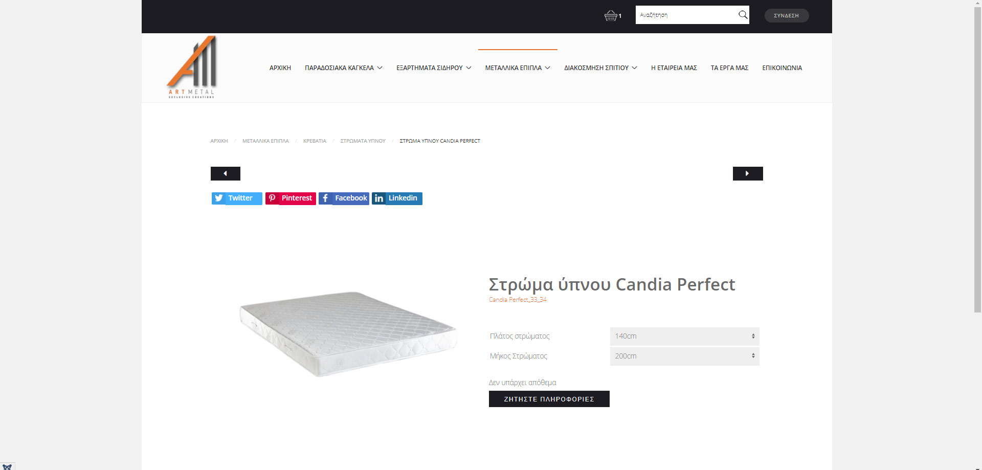

2 years 11 months ago #355296
I'm sending the correct screenshot, my bad!
If you go back you will see the correct selection but no add to cart button cause there's a 0 stock characteristic option for "Please select".
It's not about reselecting characteristics when you go back but about what you see (meaning the selection you made).
Thank you

2 years 10 months ago #355372

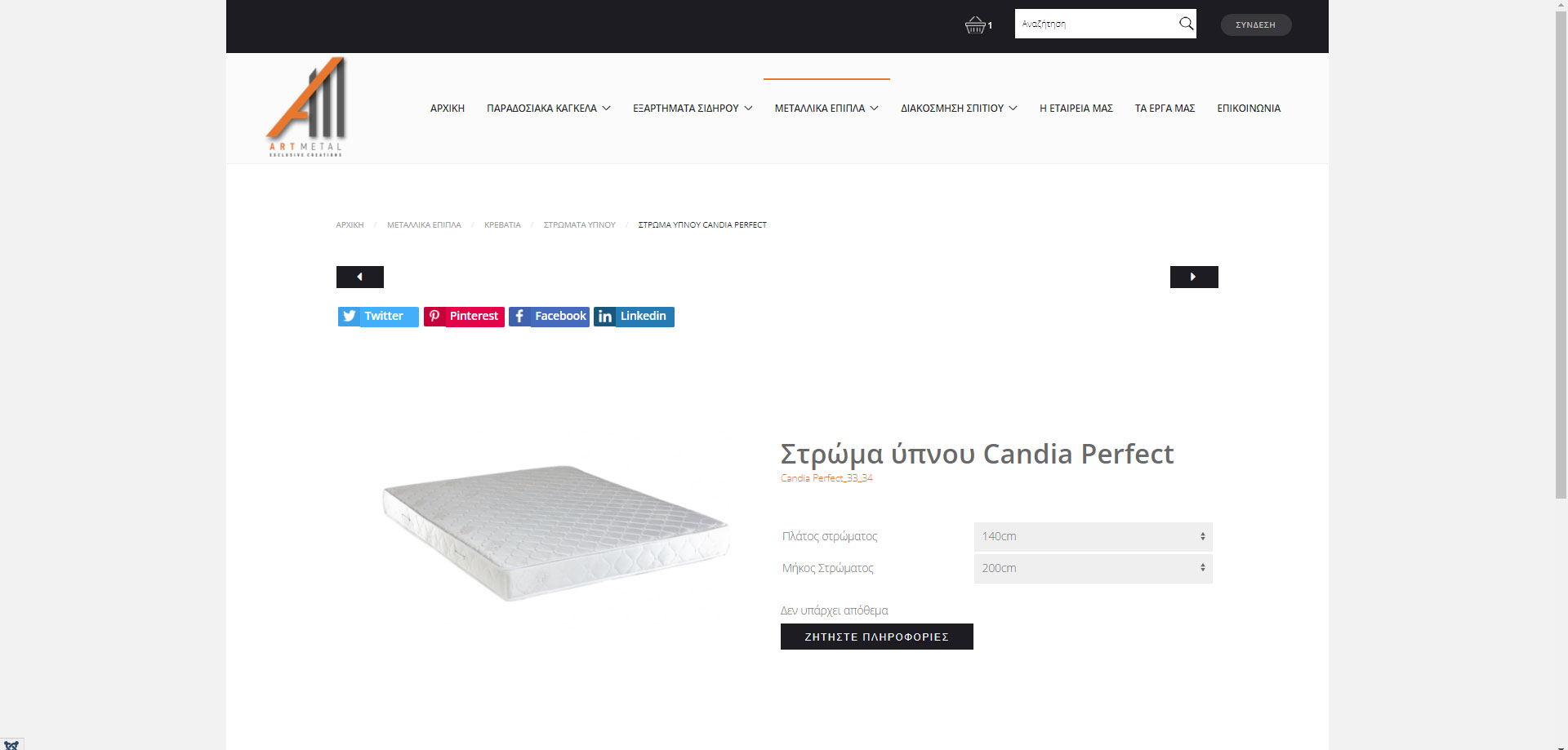

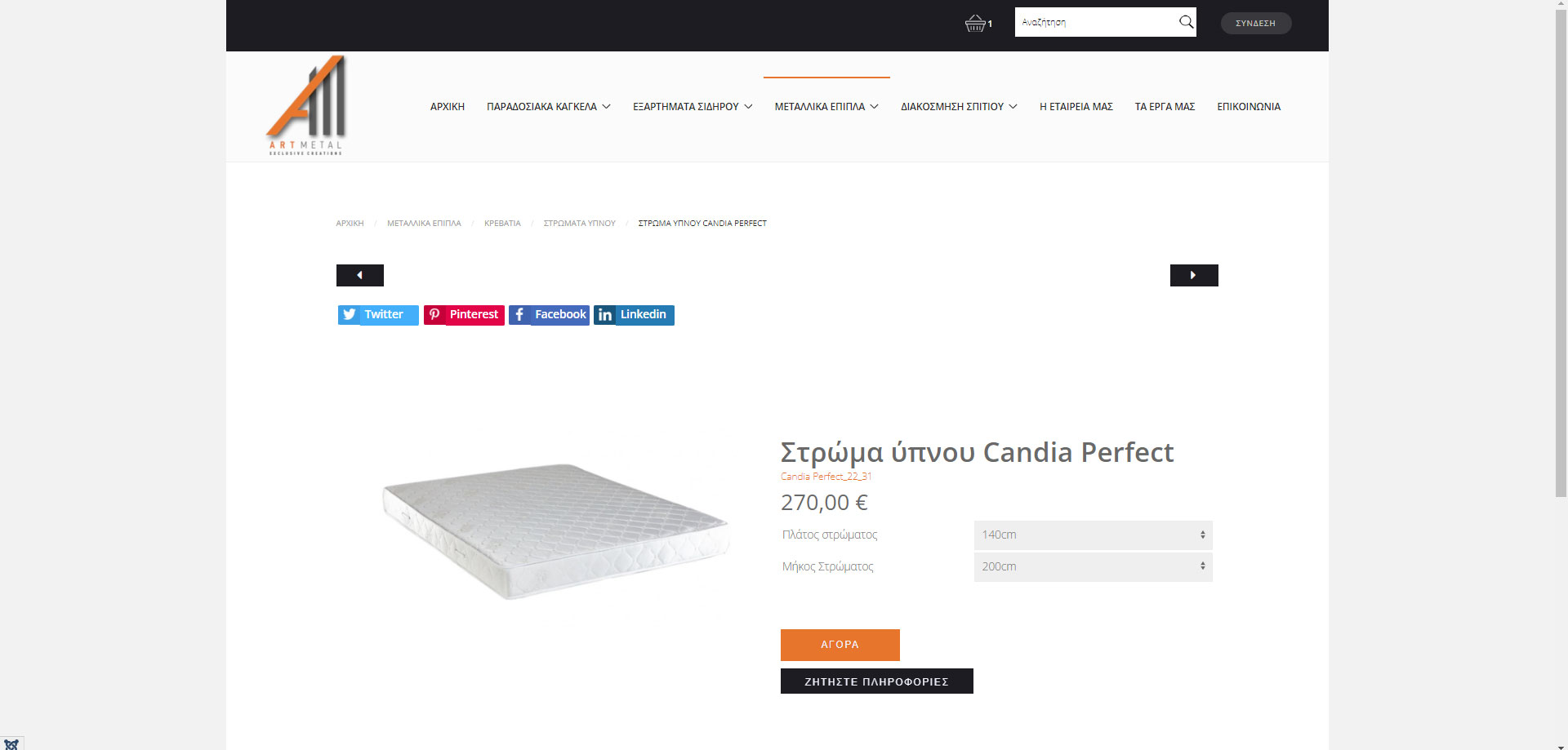

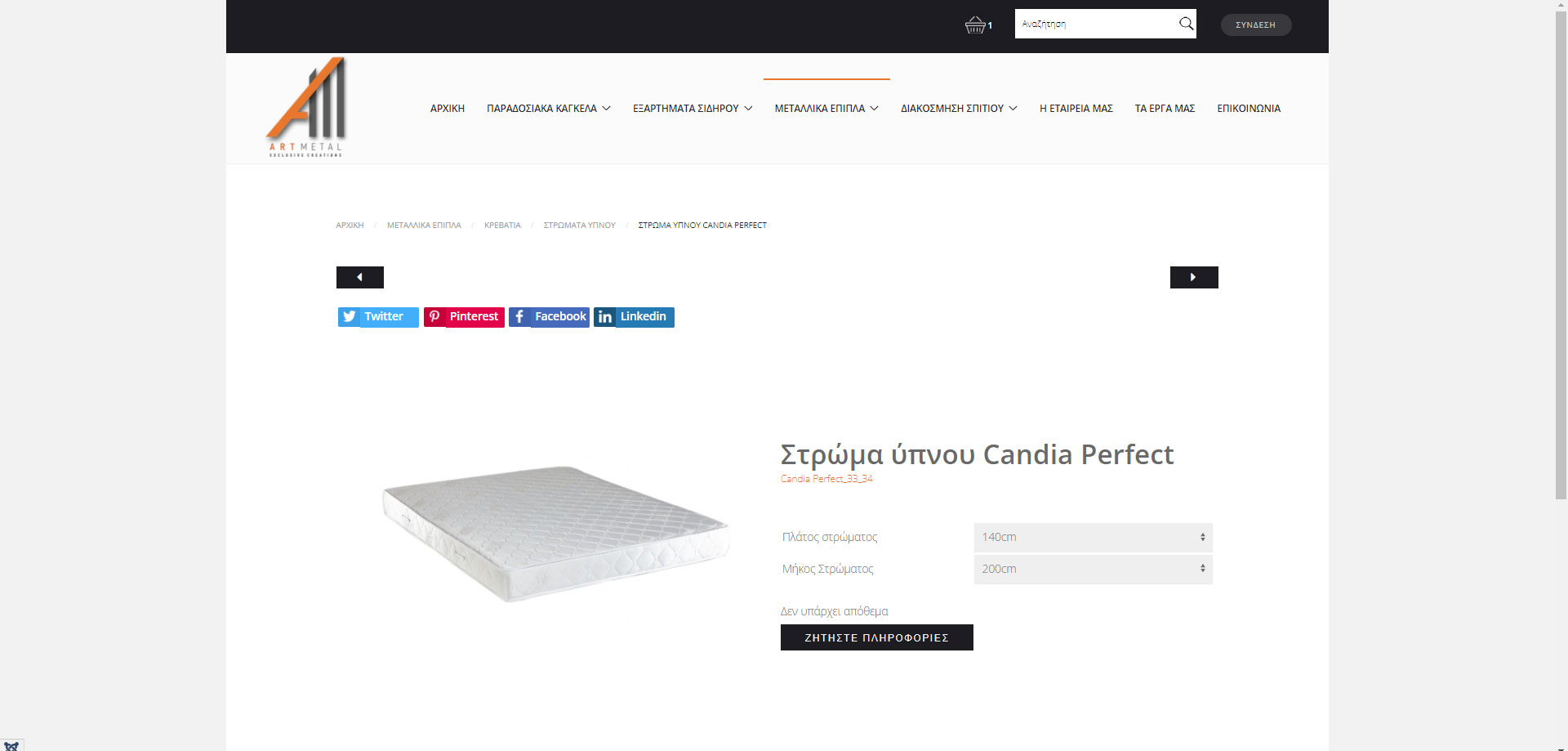

Hi nicolas!
You are at this product and you add to cart the 140cm Πλάτος στρώματος and 200cm Μήκος Στρώματος product so the price for that is 270,00 €.
You click on "complete checkout" and you are at the checkout page.
Then you click the Back arrow on the browser and you go back at the product page, you will see there the characteristic options selected correctly but there will be no price or the "add to cart button" available.
I don't know if i'm not explaining it accurately, see the screenshots.
Thank you
