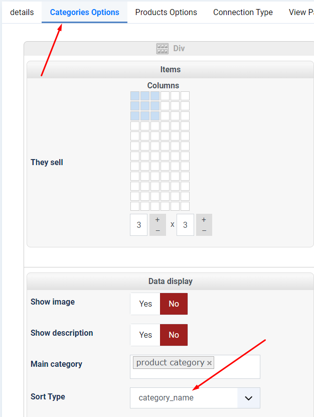

2 years 3 months ago #361371 by guneydesign
To create a menu in Hikashop and show only categories and hide Products, you must also select the Sort Type option (category_name) under Data Display in the category options section of the menu you open. I'm attaching a screenshot of this process here
I tried very hard and found it by trial and error. :)))

2 years 3 months ago #361373 by nicolas
No, this won't help. This will only sort the categories by their name.
If you want to not have the products below the categories, make sure that the "sub elements filter" setting under the "Products options" tab is set to "direct sub elements".
