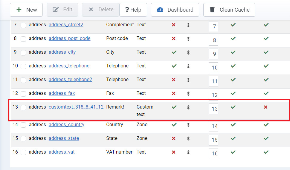

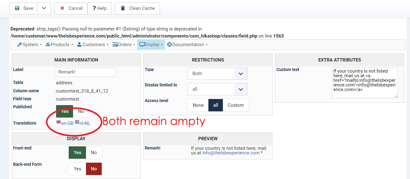

I would like to leave a comment at checkout before you choose the country. Something like, if your country isn't listed here, email us
In the screenshots you see where I whant this text and how I configured it.
When I put my text in the custom textfield, I first save it. Then I go to the translation tab, put my translation in it, save it.
In the frontend only the label is translated but the text not.
When I go again to the Custom Fileds, it seems the translation window is empty....

I created a similar field on my end and it worked fine:
i.imgur.com/jwEFpQv.png
i.imgur.com/Mv4EXEy.png
So I'm not sure why it wouldn't work on your end.
Maybe it's linked to the special characters in the "custom text" area ?
Try to enter a translation key in there and translate the key in all the languages.
It will do the same but will avoid potential matching issues because of special characters.
Also, you said "it seems the translation window is empty". What does this mean ? The popup is completely blank ? That would mean a fatal error has happened and you would have to activate the 'debug' setting of the Joomla configuration to get the error message in the popup, in order to understand what's going on. Or the popup is actually not completely blank but the input fields are empty ? That's strange too because then why would the label be translated ? Or you mean only the input field for the custom text is blank in the translation popup ?
