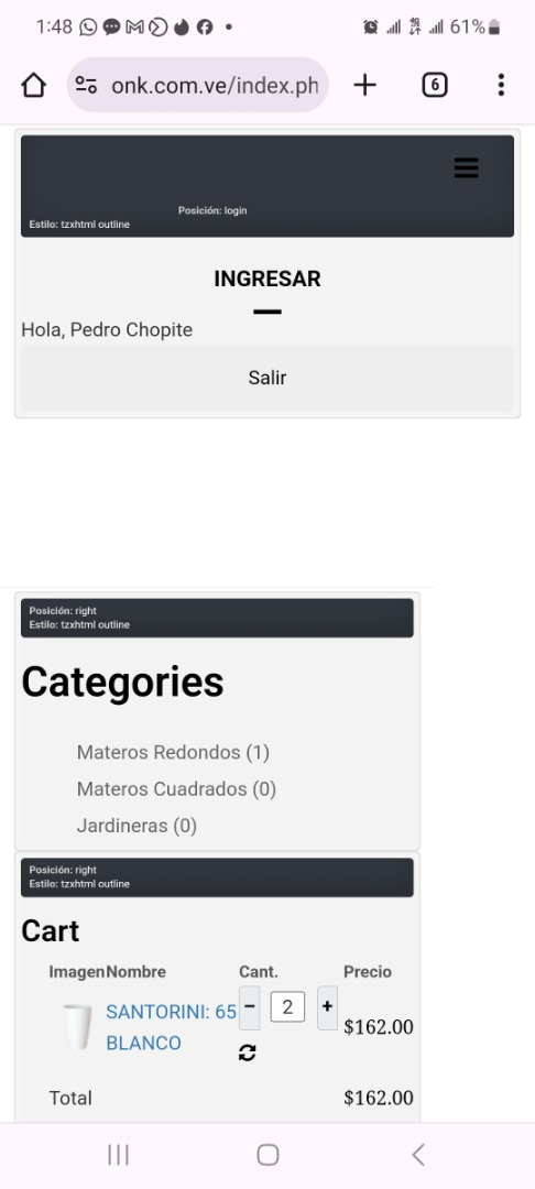

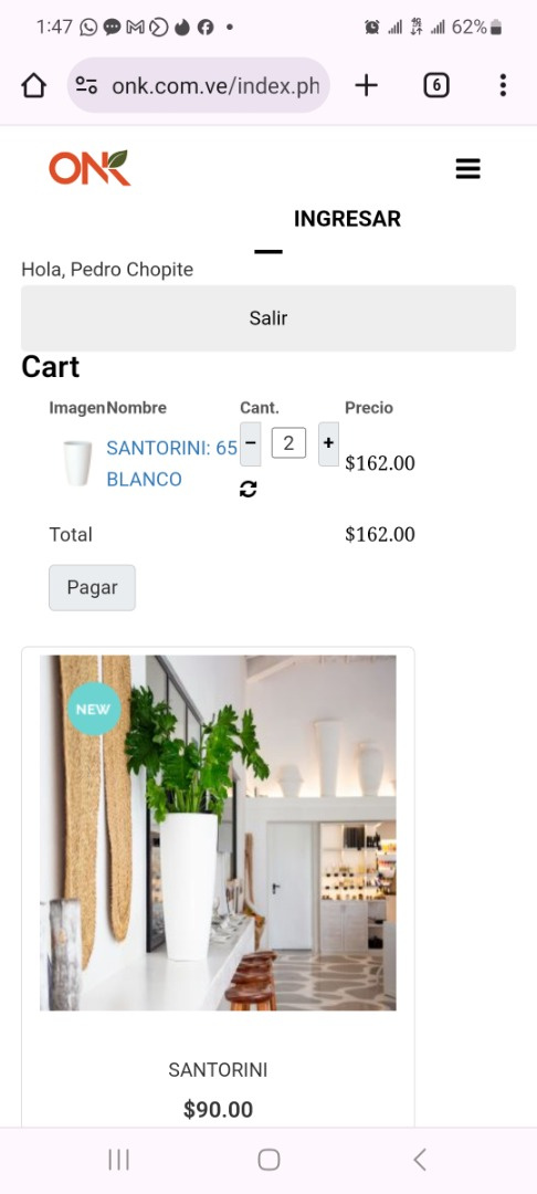

My categories module is visible in large screen. It shows in the source code of the small screen and is visible only when the ?tp=1 parameter is active, although the links do not work.

Hello, and thanks for the prompt reply. If you visit www.onk.com.ve/index.php/categorias from a mobile phone, you will see the login section and the cart directly below it after you sign in with username Phillip and password hika1234 (also administrator)
However if you activate the show modules parameter ( www.onk.com.ve/index.php/categorias?tp=1 ) you will see that the module is there. However, if you press a link you'll get a weird result.
Looking around I found that the categories listing module is assigned only three columns for small and extra-small device viewing, while the other modules get twelve, but I have not found the setting to modify that.

It's actually not that the module is not displayed. The HTML is there. The problem is a CSS issue in the template I think.
The area where the module is is just displayed under some other piece of the layout on mobile devices.
Now, a bit of custom CSS like this below would fix it, but I would recommend contacting your template provider to see what they recommend.
@media (max-width: 767px) {
#tz-right {
    padding-top: 166px;
