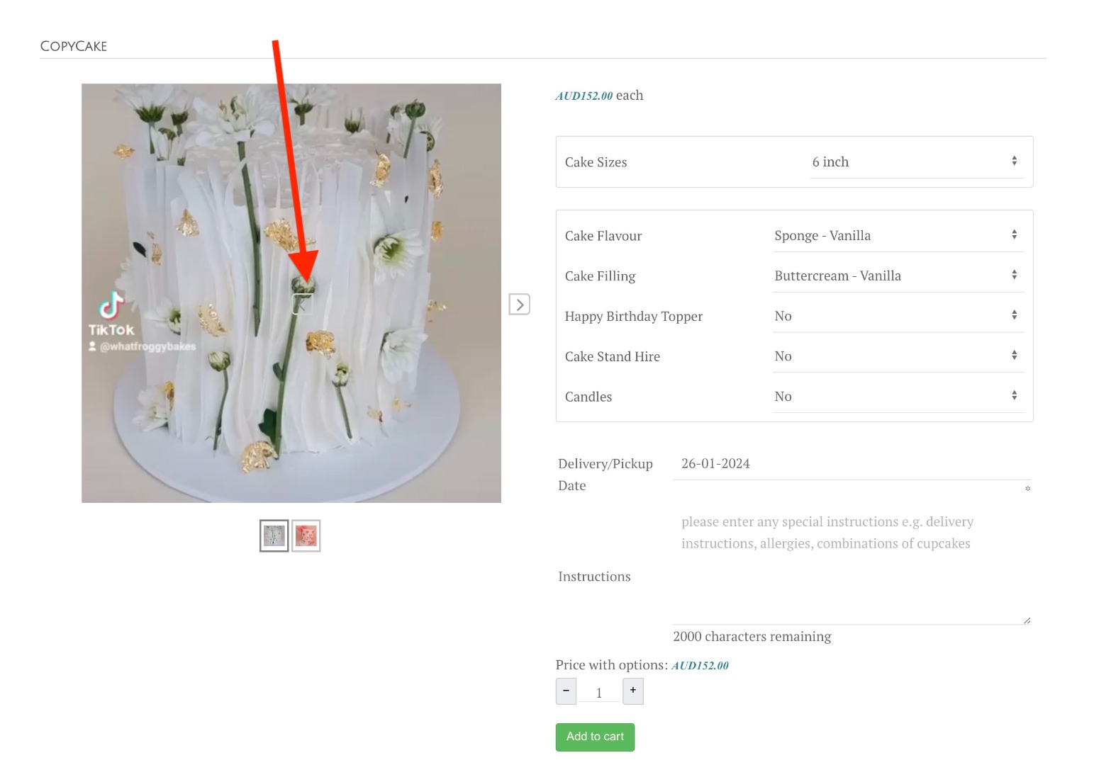

on the attached image - the forward and back buttons for multiple image on a product are no longer aligning to the right and left of the image - one of them is appearing in the centre
help
private message sent to you - for logon details to site
peter

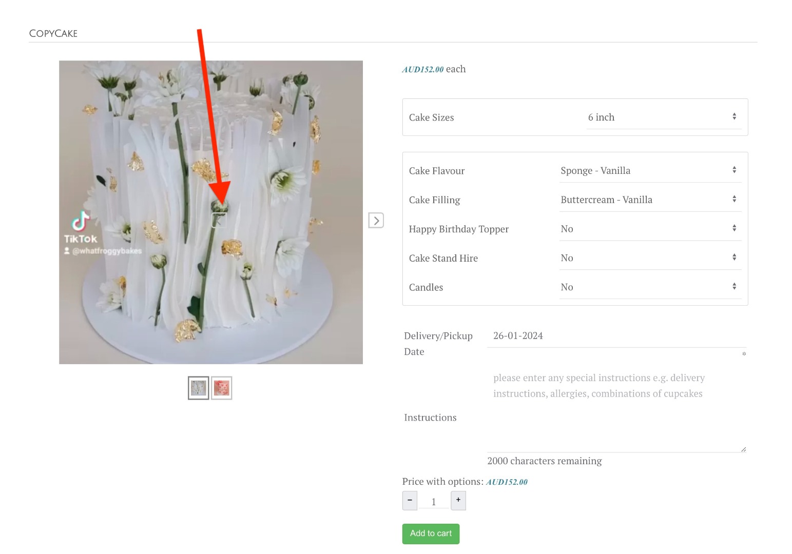

It seems that your current issue come from this commands in your custom_style.css, see my screenshot :
You can reomve it OR maybe if this command had another purpose, to use a more specific selector to target only the element you want to modify.

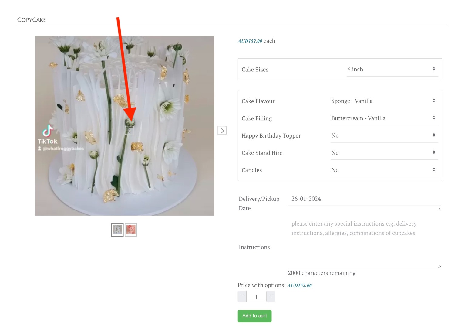

Your inspector tool show you the line of your command Css, see my screenshot :
