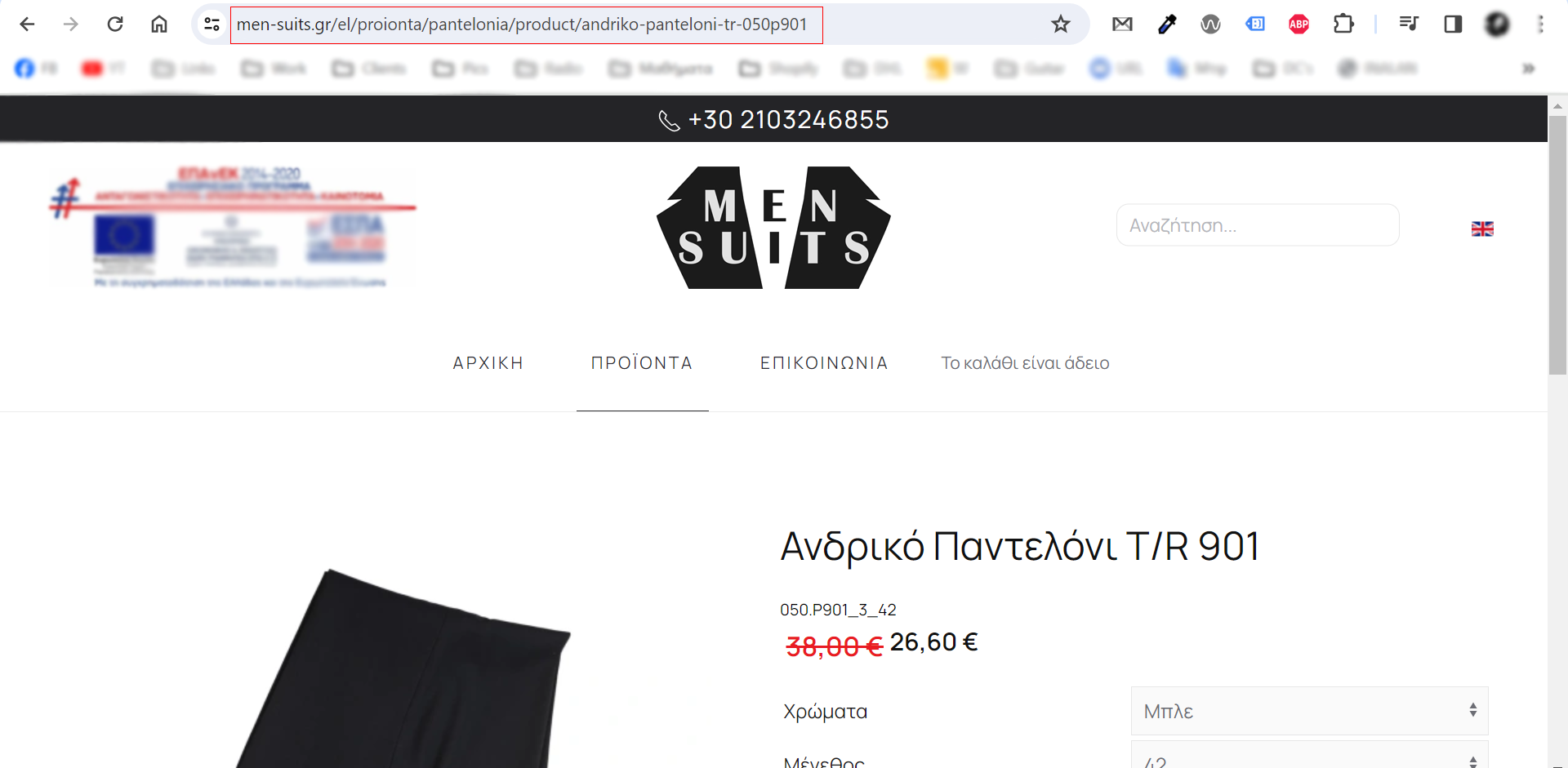

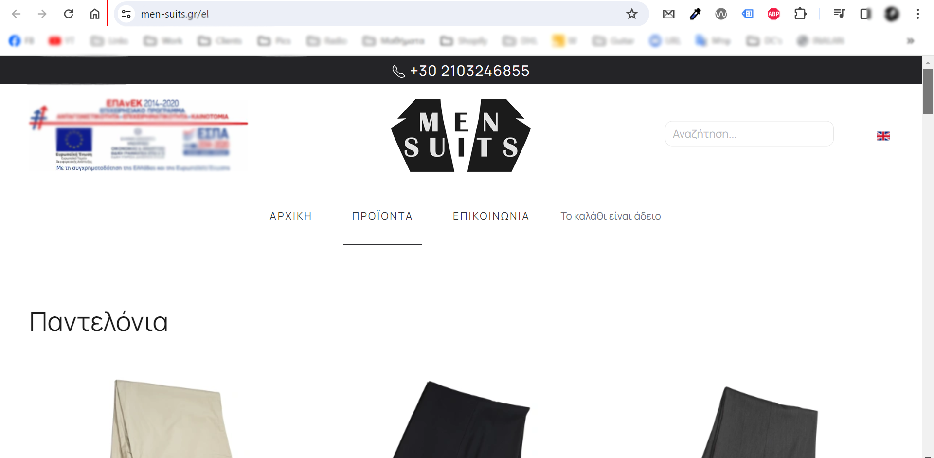

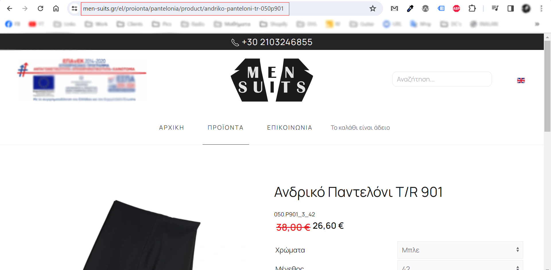

When you click on men-suits.gr/el/ you see the proionta page but when you click on a product the path includes the category.
men-suits.gr/el/proionta/pantelonia/prod...panteloni-tr-050p901

OK, I know what's going on.
You have menu items directly linked to the main category of the products. Because of that the system auto correct the menu item used for the link so that it uses the menu item corresponding to that category.
Since everything is in Greek (the category names, the menu item names, etc) on your website I had not noticed it this.
You can disable that auto correct by adding an entry with the namekey auto_search_menu_item_based_on_main_category and the value 0 in the hikashop_config table via your PHPMyAdmin.
That way, the URL will be the one from the main menu item when looking at the products on the main menu item.
Note that for the links to the products in the sub menu items linked to the product, if you want it to use the URL from the main menu item, you still need to provide the URL of the product from the main menu item in the "canonical URL" field of the product, and turn on the "force canonical URLs on listings" setting.
