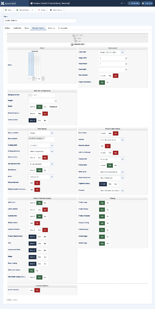

Hi there,
I am using the content module to show vendor products on the vendor page on my site, as you can see here. omnomnow.ca/all-restaurants/petu-indian-curry-kabab
However, since this is a restaurant ordering site, I've also allowed vendors to create categories under their main category so that, for instance, they have starters, mains, desserts, and so on.
Is there any way to show these category titles on the content module and to group the items based on categories? I've tried to change settings on the content module, but can't find anything that does this.
I've attached a screenshot of the current settings.
When I tried to assign a product from this page to a subcategory I created on that vendor's profile, the product disappeared, too, so that's not really working as planned!

2 years 3 months ago #360872
It's a full page screenshot. You have to zoom in to see the details.
I'm pretty sure I've already tried that configuration, and it does not show the category headers on the page. But I will try it again.
  • Posts: 324
  • Thank you received: 4
2 years 3 months ago #360878
I just checked, and unfortunately, this does not solve the problem.
I am using the Hikashop content module to show each vendor's products on their store page. As such, it is not specific to any vendor or any category created by vendors when signing up or subsequently from their dashboard.
When I change the settings as mentioned in your response, it shows the main product category header but none of the subcategories that they have created. So, essentially, it does not work.
I need to show the subcategories created by each vendor. I've made a video to explain this a little better. But in a nutshell, the "grouped by category" setting you're talking about only shows the category set as the main category and NOT all the subcategories. How do I do THAT? I have looked. There does not appear to be an option to show subcategories specific to the vendor category being displayed, but THAT is what I need to do.
Thanks.

With the module "sub elements filter" set to "group by category", the module will sort the loaded products by category.
So the problem is not the grouping, it's the filtering of the products for only the vendor of the page.
I think that what you're missing is the setting "Filter same vendor" added by HikaMarket under the HikaShop options tab of your module settings. This setting needs to be turned on so that only the products of the vendor of the current vendor detail page are taken into account.
I didn't see that setting in your video as you didn't scroll down far enough. I think you might have overlooked that setting and left it turned off. Please check.
