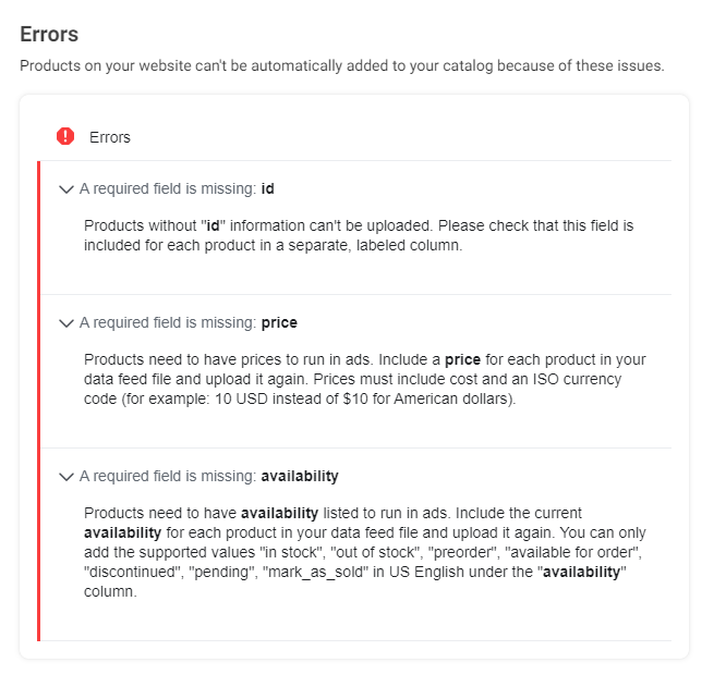

I am wanting to automate how products are added to Facebook catalog using the Facebook pixel which will add products based off Microdata. I am getting errors that ID, availability & price are missing and I'm just not sure what I'm missing or what I need to to tweak on the backend to make sure all is correct so that the pixel can see all the needed microdata.
Here is the error for one of the product pages I tested using Facebook Microdata Debug Tool:

The issue you have is that you're missing the microdata in the product view files.
It seems that the product page layout view files on your website have been customized based on an old version of HikaShop which doesn't include the schema.org tags.
For example, if you edit the view file product / show_default via the menu Display>Views, you normally have this line of code which adds the id :
<meta itemprop="productID" content="<?php echo $this->element->product_code; ?>">
so normally, Facebook shouldn't complain about it missing. However, I can see that this meta tag is not on your product details pages, so I'm assuming it is due to a previous customization.

I still don't see the meta tag with productID in the HTML of a product page.
Can you check the code of the product / show_default view file ? It should have the line I mentioned in my previous message.

1 year 10 months ago #362712
That's indeed the default code of the view file. And I can see the microdata information tags and attributes in there.
However, I still don't see them if I look on a product details page on your website.
That should not be possible, unless another extension process the HTML to remove them.
I can see that you're using 4SEO. It might be linked to that.
Could you try temporarily deactivating it ?
  • Posts: 130
  • Thank you received: 6
1 year 10 months ago #362723
From 4SEO team:
4SEO would not do anything about microdata. 4SEO is an SEO product, and any structured data it outputs is in json-ld, the standard for SEO use. After that, any structured data in the page is from Hikashop.
Last edit: 1 year 10 months ago by dklbwf.
  • Posts: 85860
  • Thank you received: 14108
1 year 10 months ago #362724
Then, it could be caused by another extension.
Could you try deactivating the plugins of the group 'system' one by one and check if it's helps?
Note also that when you check the debugger you need to make sure it refreshes it's cache. Otherwise, the report would just be based on the old version of the page.
The best is to actually directly look at the HTML of the page with your browser inspector.
You can compare the HTML with the one of a product page of our démo website. You'll see there the méta tags and attributes for the structured data.
