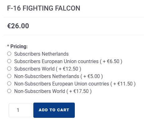

We are in the process of moving away from J2store into Hikashop. Therefore on a product page I want te recreate price options for a product. I have found that this will be accomplished by working with characteristics and variants. But I can't seem to make it happen after spending hours going through the manuals and forums. Is there someone who can help me with this? I'm attaching a screenshot of the current config. It will most probably be something tiny (and or stupid) I am missing.

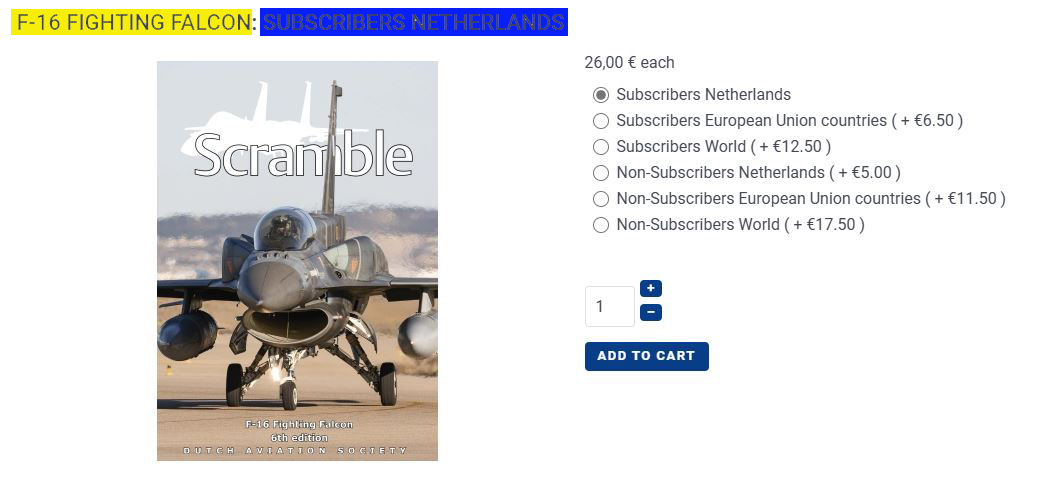

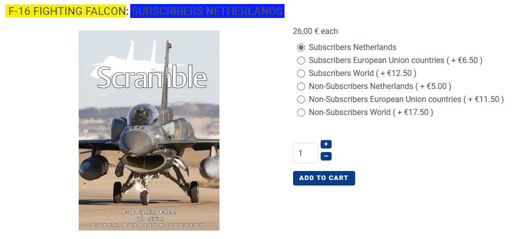

But still can't figure it out. Adding an attachment (title) with two colors. The main product in yellow (which needs to stay) and the selected characteristics in blue (which does not need to show.
